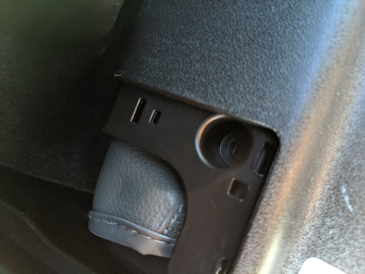

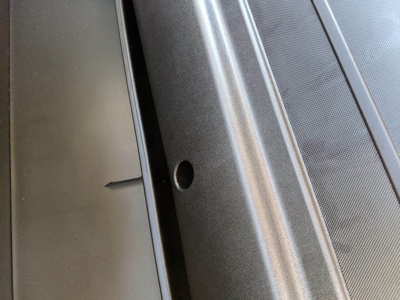

    I can try to get some pictures when I get home from work later. Should just be a few clips and screws along the bottom. You should see one screw and there is one hidden under the plastic cover near each hinge. You can see one of the hinge covers off in my photo.

    How did u get the black plastic cover off those rear seats. Can’t find any screws or clips. Thanks

    On my 2020 there are screws under the plastic covers for the hinges and one in the center bottom. On the smaller flip down seat there were only the hinge screws no center.

    Fill me in on removing the rear seat back panels. So you take the panels off install the seat cover, then put the panels back on? I can see how that would be a cleaner installation. Does it fit correctly?

    Fits ok, but you have to cut holes in the covers for the plastic seat back clips to poke back through.

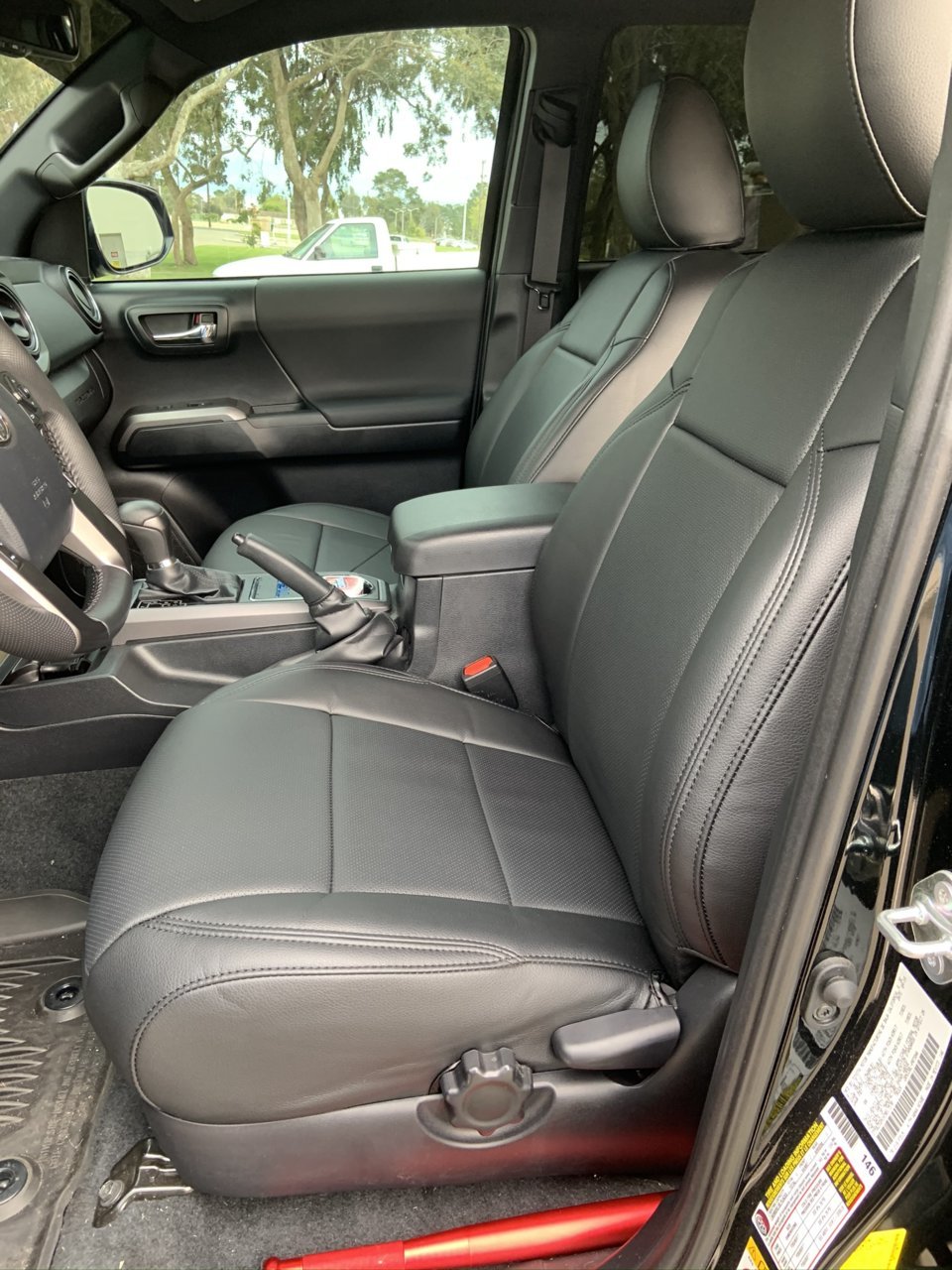

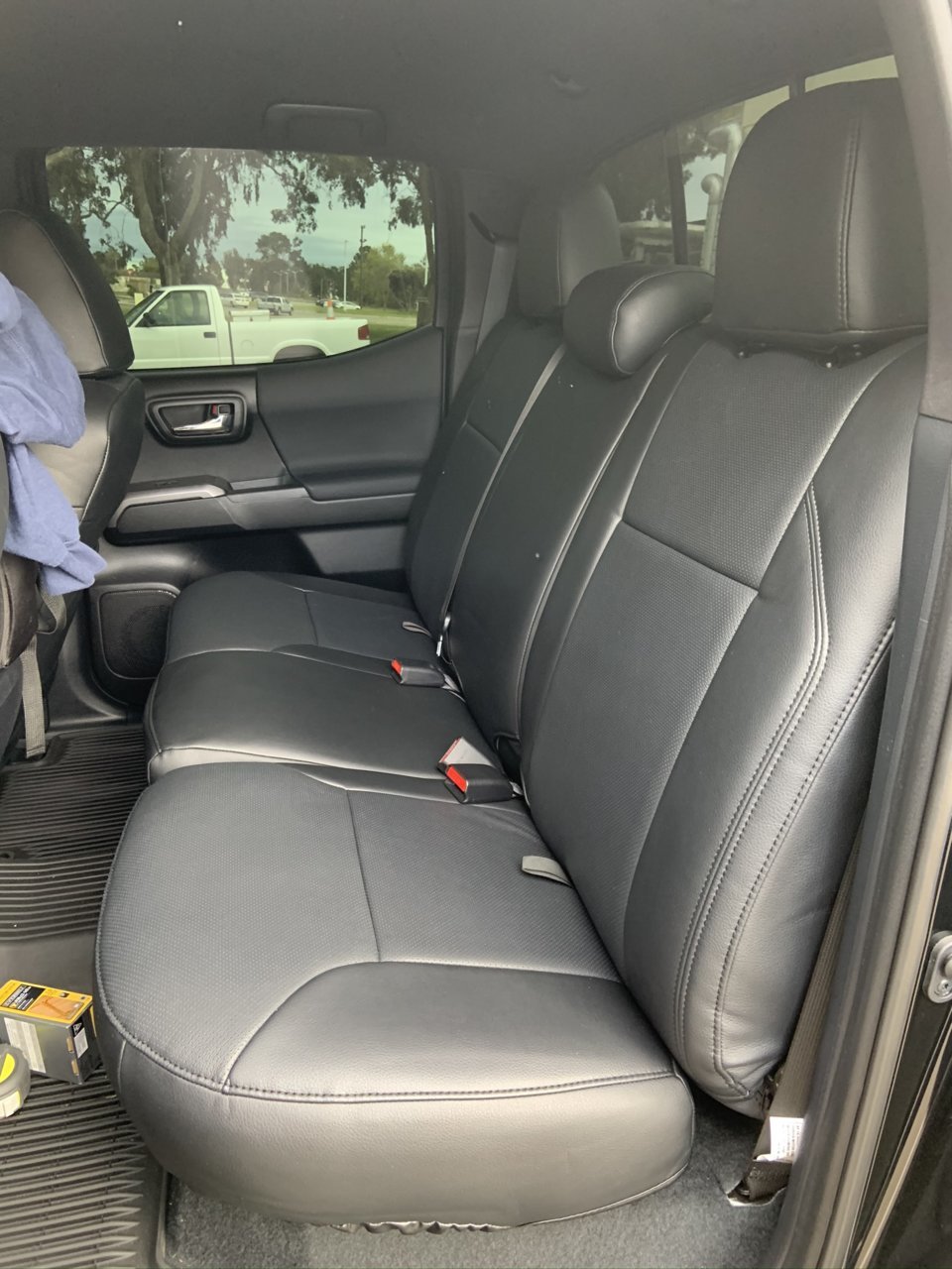

    Finally got mine installed love them!

    Super flush, nice.

    Are those the black leather?

    Yes they are they look better in person
