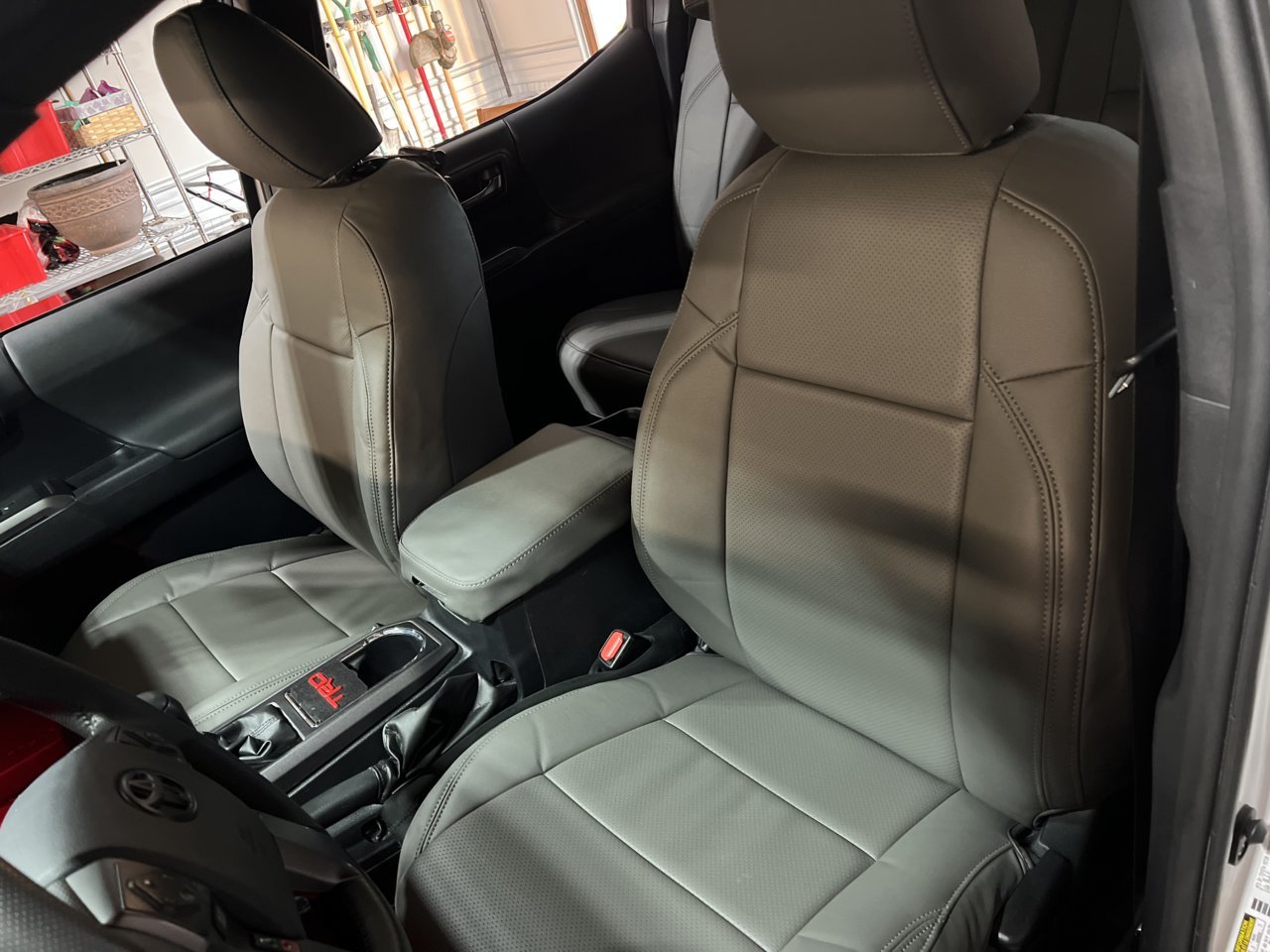

    Just installed @Clazzio DK Gray PVC. Took my time. Fingers are sore, ripped couple of dry fingernail beds. I waited so long to finally replaced my (fronts only) $25 fake leather EBay covers. Due to install difficulties, I should have gone with full leather. I did remove the front seats. The PVC looks/feels good and worth it.
    But it won’t be as durable as the Napa Leather.

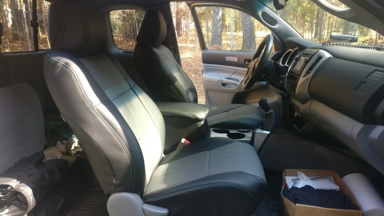

    I got the Toyota style switch but I can't help with the wiring part; I have a 2nd gen and got some help in that department b/c if I did it, it would be janky AF + probably kill the battery..
    I took the seats out to do the install b/c I didn't want to struggle in the cab.
    I put the heating pad between - over the factory seat cover and under the Clazzio - takes a minute to get warm [compared to my car with OEM heated seats] but completely does the trick.
    I sprung for the full leather, grey insert with black shell to match the interior and dark green stitching which is hard to see but is a nice looking detail = matches my Spruce Mica paint.
    One year on, they still look as good as the first day and seem to be holding up well - the driver's seat and passenger seat covers look the same but the passenger seat never gets used ;)
