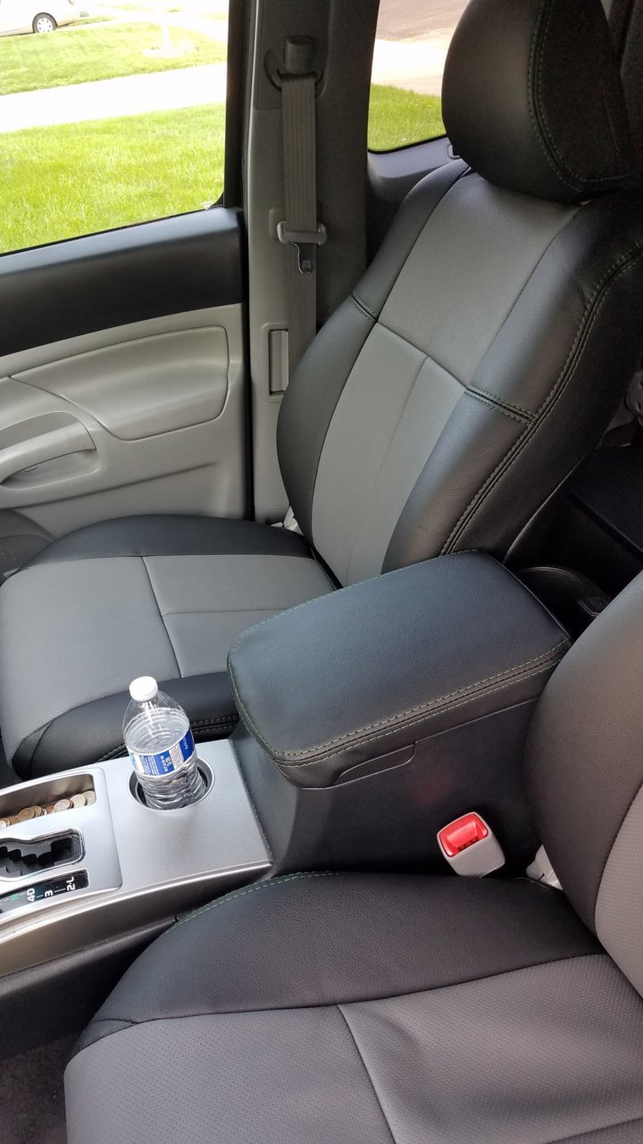

    This is what I did with mine..Clazzio leather seat covers!

    Yeah i will have to do that.
    Where did you get the foam from?

    I got the 1” foam from Hobby Lobby. I “fillet” it with a sharp knife to reduced it 1/2” thick. I’d use a high density foam (if you can find some in small piece) more suitable for upholstery projects.
    Sorry I can’t find the left over foam to get more info…

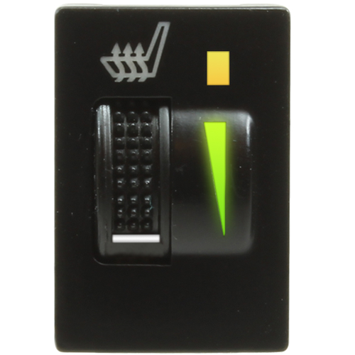

    Got my Clazzios in 2019, added heating elements as well with the older style toyota sized roller switch (i believe they are like a 5 or 6 position switch), one was bad on delivery and now the other is acting up and turning on in the off position. Does anyone have a source for higher quality switches or a 3 or 4 position rocker (off-low-med-high or off-low-high) that would be a direct replacement? pic is what I received from clazzio.

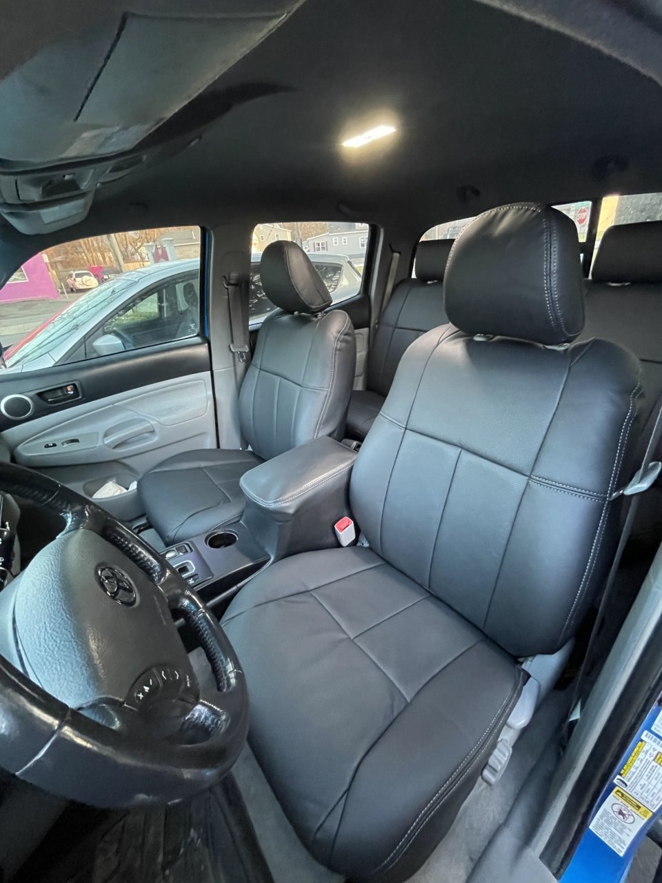

    I was able to get my center console cover installed pretty nicely without foam. You do need to remove screws on the underside and tuck the excess. i had trouble with one of the screws reseating so i just found a slightly longer screw to secure it. This was a couple years ago now so my memory isn't exact but i believe i also had to loosen or remove the latch for the center console also and tuck under that as well. took about a half hour or so but was worth it in the end:

    Are you looking for these switches? This is the entire kit I bought to go under my Clazzios....maybe the seller has these switches for sale on their own?
    https://www.ebay.com/itm/262058808270#SellerPresenceViewModel

    I dont think you can just swap out the switches on these. I believe the roller switch has a little smart box that controls it. The switches above use more direct wiring with a couple of relays to control the power. You would have to re-run the wiring.
