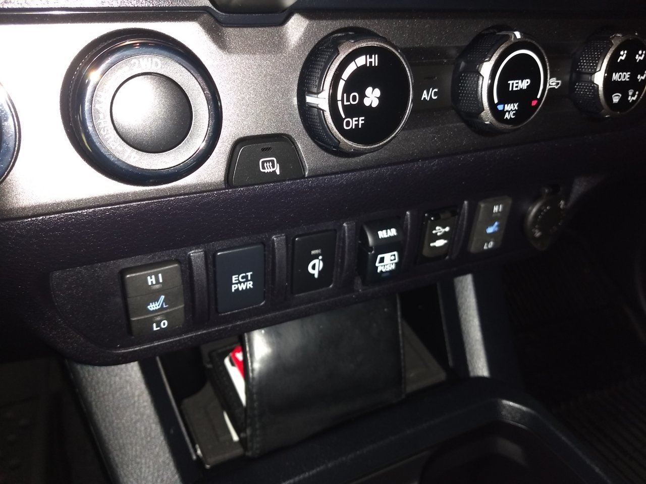

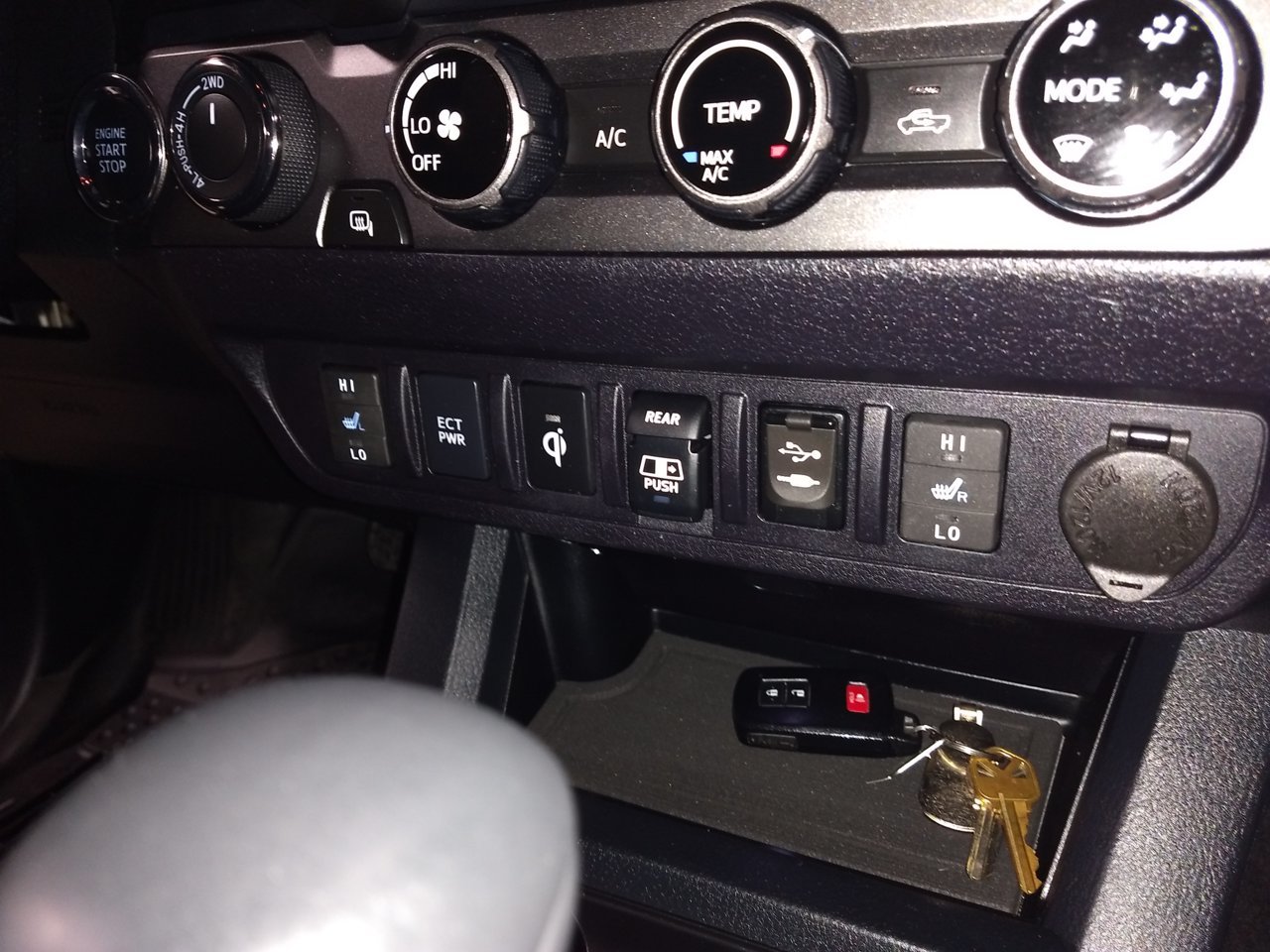

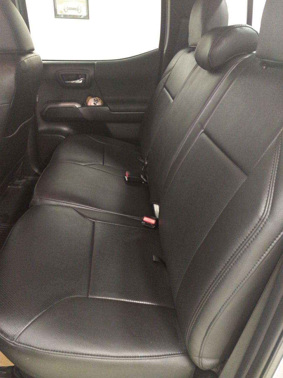

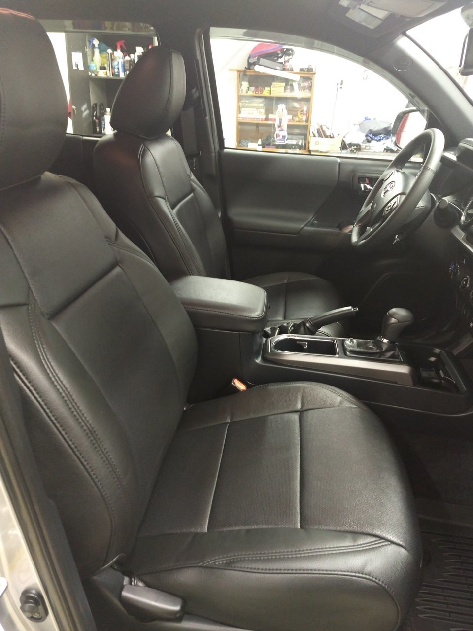

    Just did the install of the heated seats and my Clazzios last night. Had the wiring done today with the switches in the dash. Everything went perfect and got a set of sweet new dash speakers with built in tweeters, sounds awesome. IMG_20190219_215945569.jpg IMG_20190219_215912580.jpg IMG_20190220_104258103.jpg IMG_20190220_130156583.jpg

    How did you wire it up?

    A friend has a stereo and tint shop and he wired them. They came with it's own wiring harness, wired them through the console and put the switches in the dash. They were a perfect fit, I couldn't have ask for a better job. He even put a set of new dash speakers with tweeters and the sound is super impressive. I thought about the Subaru tweeters and he talked me out of them. Solely because they are just a tweeter. Seats heat up so quick.

    I did the seats. I also did my son's 18 dcsb. He got some Clazzios for Christmas and we put them in, took about 3 hours. Did mine last night and putting the heating pads took a total of 5 minutes tops for both seats, no cutting, trimming or anything. It was just sticking the heat pads on then doing the seat covers. Really easy, I took the seats out and my son helped me out. Again it's not bad, and I never even looked at the directions but did watch a few videos.

    Did you buy the replacement lower panel with additional switch holes?

    I had the q charger moved moved from the end next to the ECT power switch. I had two blank dummy switch panels to use. That's the way my Sport came.

    oh gotcha. I have the OR and has less holes. not sure of my plan for that just yet but I have the same kit you have

    I have seen the 7 hole panel and I think they have a 8 hole panel.
