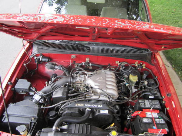

    again these are pics of the o2 sensors that I changed 2 months ago, I know they have been changed at least once because the wiring banding under the transmission for the front sensor had been already broken. Now this is me but my truck was not throwing any CELs, but it was in a sorry state of tune when i got her, and after what I have done so far I am very happy with the way she is running.
    Now I have just gotten my special yellow notice from Illinois to get my truck tested before I renew my reg. and I am going to do a few more things, new coils, temp. sensor, and instead of cleaning this time just get a new IA sensor and I will post the emission test results on the forum.
    of forgot it after if cleaned under the hood this spring, dont mind the chips, a fall project coming with new suspension before outer banks!
    I forget to say, the sensor with out the wire is the front one, and after i took the nuts off and started out, it hit the side and a nice little rain of soot came out with it, so there was alot more than the pic shows.
