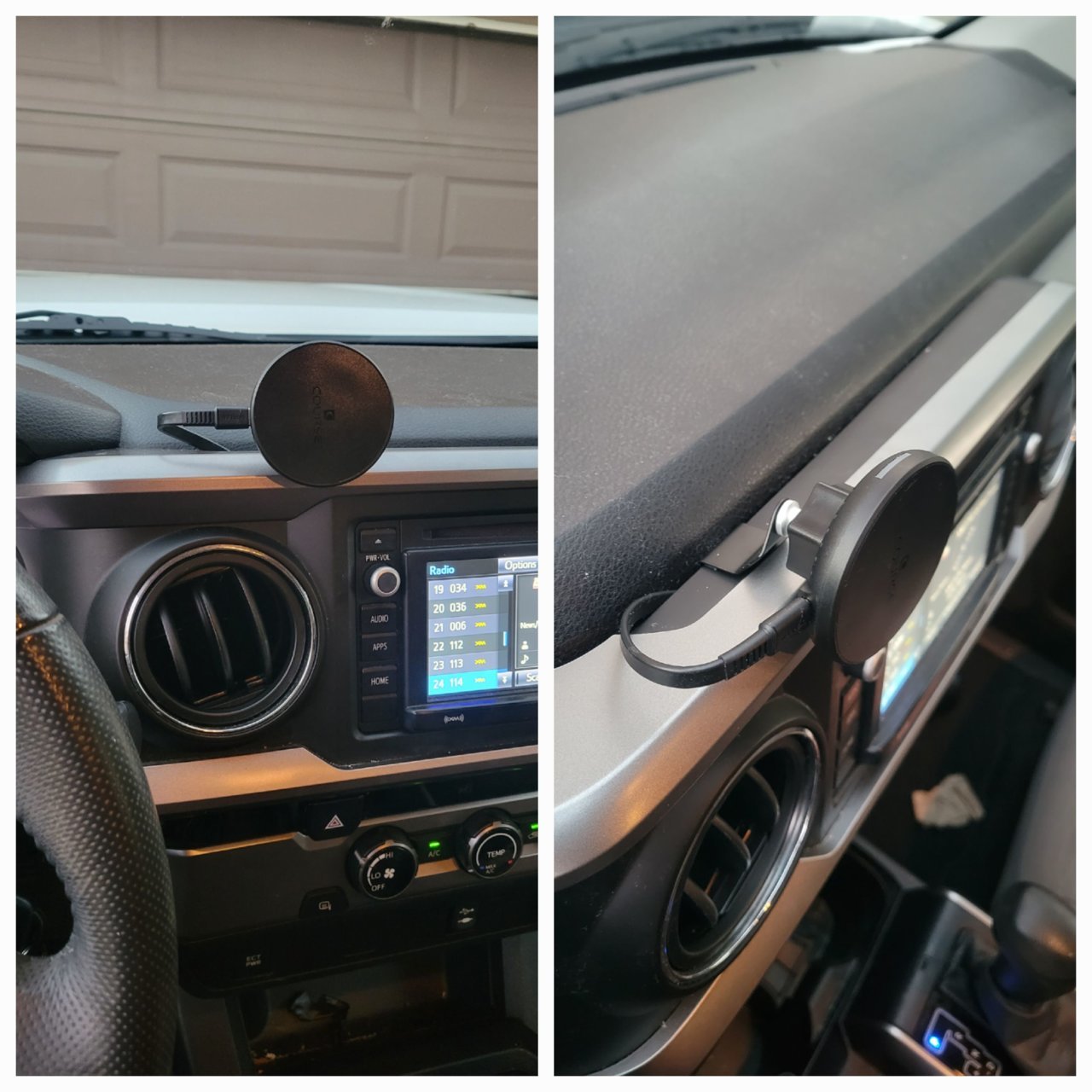

    Hi All. New to TW and it's great. I have come up with what I think is a good phone mount and charger install. I used a Course Motorsports wireless charger and magnetic mount. A 6 ft long flat phone cable (type c for my samsung). And a cig lighter USB charger. (And yes I know I desperately need to clean the interior, I promise I will tomorrow)
    I partially pulled up the center console where the shifer and e brake are, pulled off the trim around the radio head unit and took off the temp control panel.
    Then I used some wire with string to fish the string under the cup holder area behind the temp controls and out above the radio head unit. Then taped the charging cable to the string and pulled it up onto the dash.
    I drilled one small hole in the center console storage area. Fed the other end of the charger cable in and plugged into the cig USB charger.
    Placed the mount in and replaced the head unit bolts. Replaced all trim. And done! Let me know what you think.
