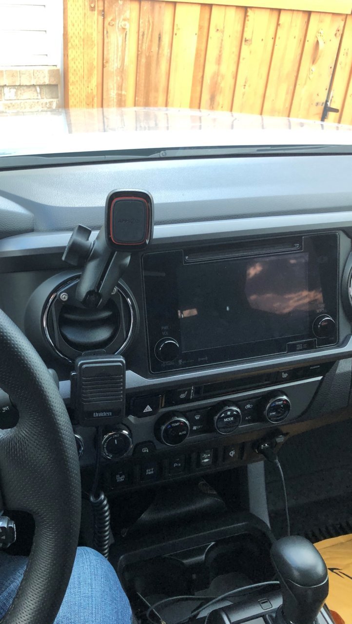

    I've since got a new mic cable (longer and 90 degree connector) and have my mic wire ran under the center console and out near my shifter then it comes up and mounts to my vent mount. Also, CBs work great for trail runs. Easy for anybody to pickup and install without the need for a license. If you're really serious about comms, you could look into a HAM radio as Shellshock mentioned. But for me, none of my other buddies have a HAM radio or license...we all just use CBs.

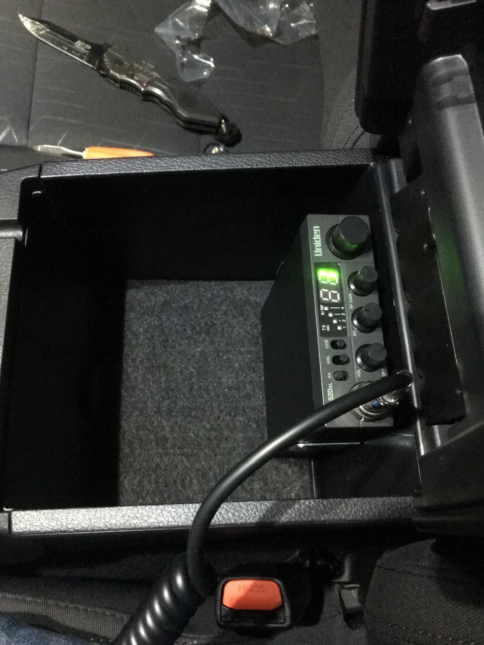

    Uniden offroad radio, it hides under the dash, rj45 switch plate to plug in the hand set, CB switch to turn it on and off, and a 3 foot firestik antenna on a rear mount.

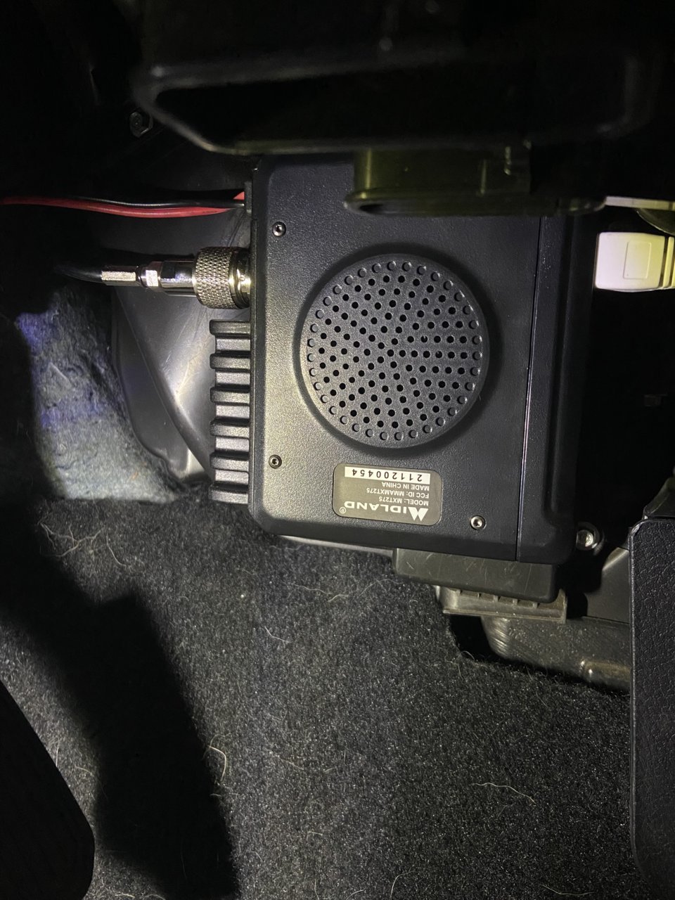

    Seriously go and get a GMRS at least. no test, and its only $55 i think for the license.
    In my experience its much easier for off road buddies to stomach getting GMRS
    Its crazy how much more reliable VHF radio is for offroad comms, most of the rest of the worlds "citizen Band" radio is VHF
    These are a good start:
    https://www.amazon.com/Midland-Micr...75-8bc7-93deae8f9840&smid=A33O82Y9CWW4GL&th=1
    If you really are stuck in the CB dark ages, there are some good low profile options:
    Uniden Bearcat: Pictured above and also the cb i like best
    https://www.amazon.com/gp/product/B06XJG6NYB?smid=ATVPDKIKX0DER&th=1
    Midland
    https://www.amazon.com/Midland-75-8...mzn1.fos.18ed3cb5-28d5-4975-8bc7-93deae8f9840
    Cobra
    https://www.amazon.com/Cobra-MINI-R...refix=cobra+small+cb,aps,88&sr=8-1-spons&th=1
