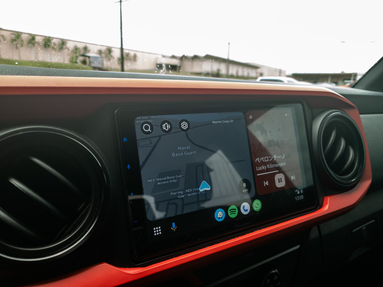

    Oh yeah, here is a picture of Waze running on the WC6600NEX.

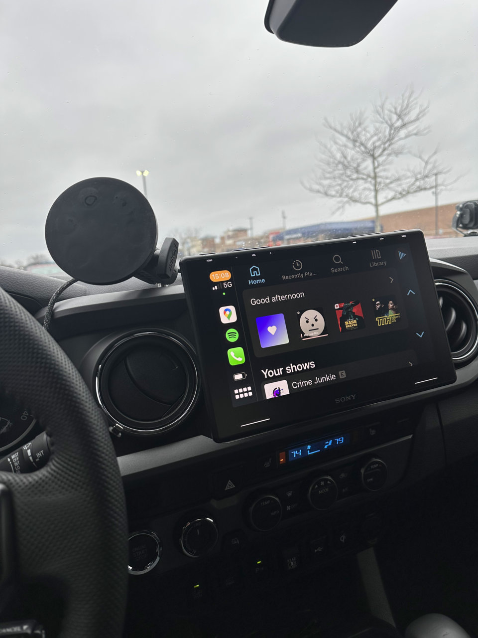

    I'd second the Sony. Final ripped out the last of the JBL and couldn't be happier. While the image shows Apple Carplay, I put a dedicated Android device in my center console as Android Auto works better in my opinion. That weird lag from the wireless Carplay? Gone with Android Auto. Personally despise the Android software, but they get this right.
    Waze layout and usage – better.
    Spotify layout and usage – better.
    Apple Music – .
    For the bezel haters (because I am one), not noticeable during normal use. The shortcuts at the bottom utilize some of that space as well.
    Last note, if you mount it correctly, you can actually get it pretty close to the dash. There will always be a preference between larger screens and flush mounts ... Make up your mind and go with what you like. Besides, ain't none of us riding in your truck anyways.
    Hope this helps.

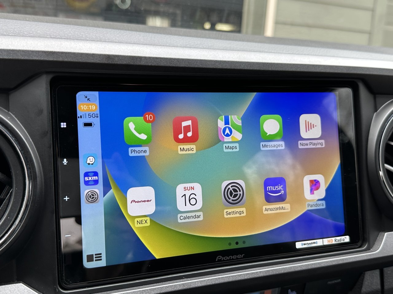

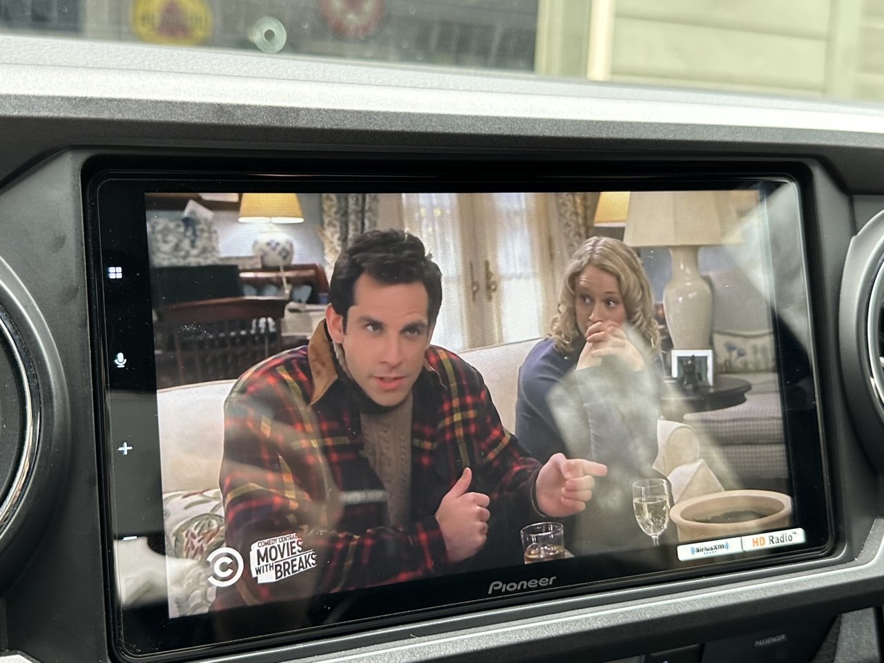

    I went with the Pioneer and love it so far. Apple CarPlay, live television with Roku. It’s pretty kick ass and looks stock.

    Is that android auto in your pic here?
  18. Apr 17, 2023 at 7:41 PM
    #78
    Rainoffire
    Rainoffire Well-Known Member
    May 31, 2018
    #255034
    3,106
    2017 QS DCLB TRD Sport
    Yes.
    This is the newer coolwalk UI.

    Looks great!
    I would also recommend adding one or two washers to the mounting bracket, so it will push out the headunit to sit flush with the trim piece.
