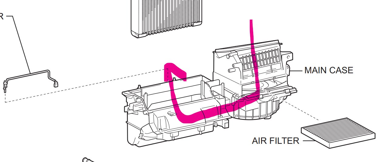

    This is the best I can do.

    Thats a good diagram. So to me it looks like the blower connects directly to the box the cores sit in. So I should be able (probably did) vaccume that out when the blower is dropped.
    Can someone who has pulled the dash apart confirm that is true?

    Closest thing I've had apart is a gen 2 Tundra but yea it's directly connected, most stuff I've had apart (mostly Ford's & Dodges) has the evaporator mounted perpendicular to the outlet of the blower but Toyota has it mounted parallel.
    I've never had my blower out so I don't know how far in there you can get from the blower opening.

    This is a perfect picture. Thank you!

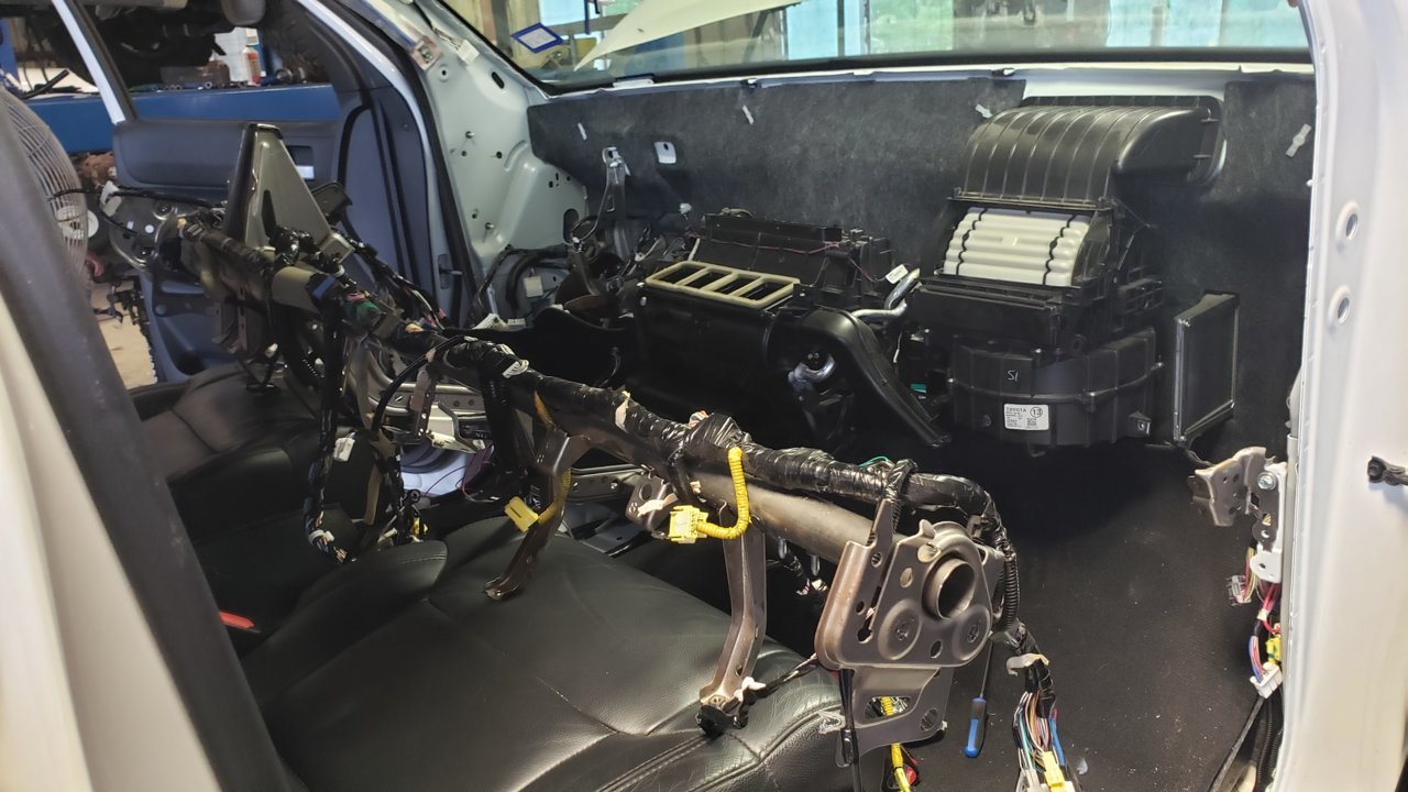

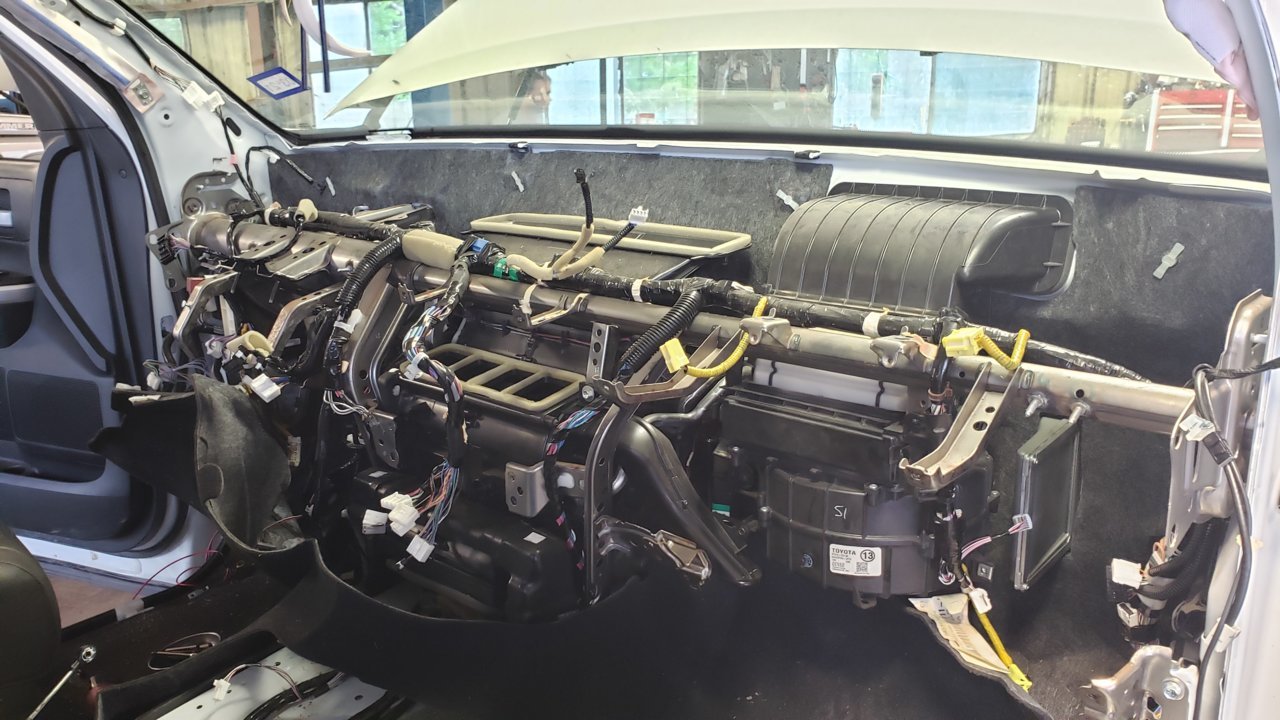

    That's a Tundra that I did a few years ago, it had an A/C inop because a mouse had chewed the wires off the evaporator temp sensor.
    Once you have pulled a few it's not too bad although I have to say that that one was much more involved than the Fords and Dodges that I typically get. Took me about 7 hrs whereas those typically take me 3-4.
    I like doing them providing the vehicle isn't a trash can and the plastic isn't all brittle.
    If I ever get a Tacoma to do I'll be sure to document it the best I can.
