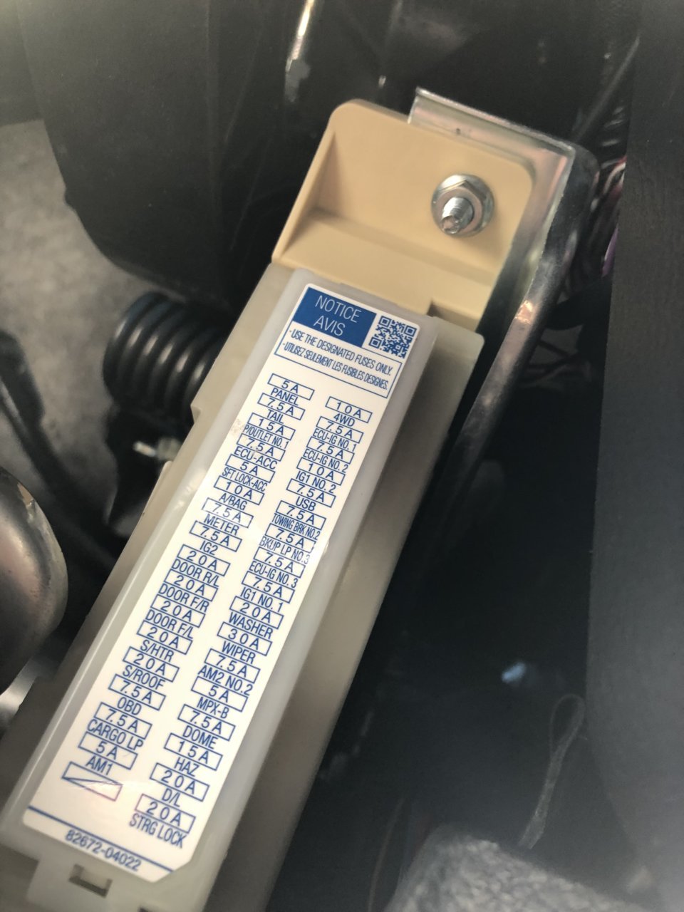

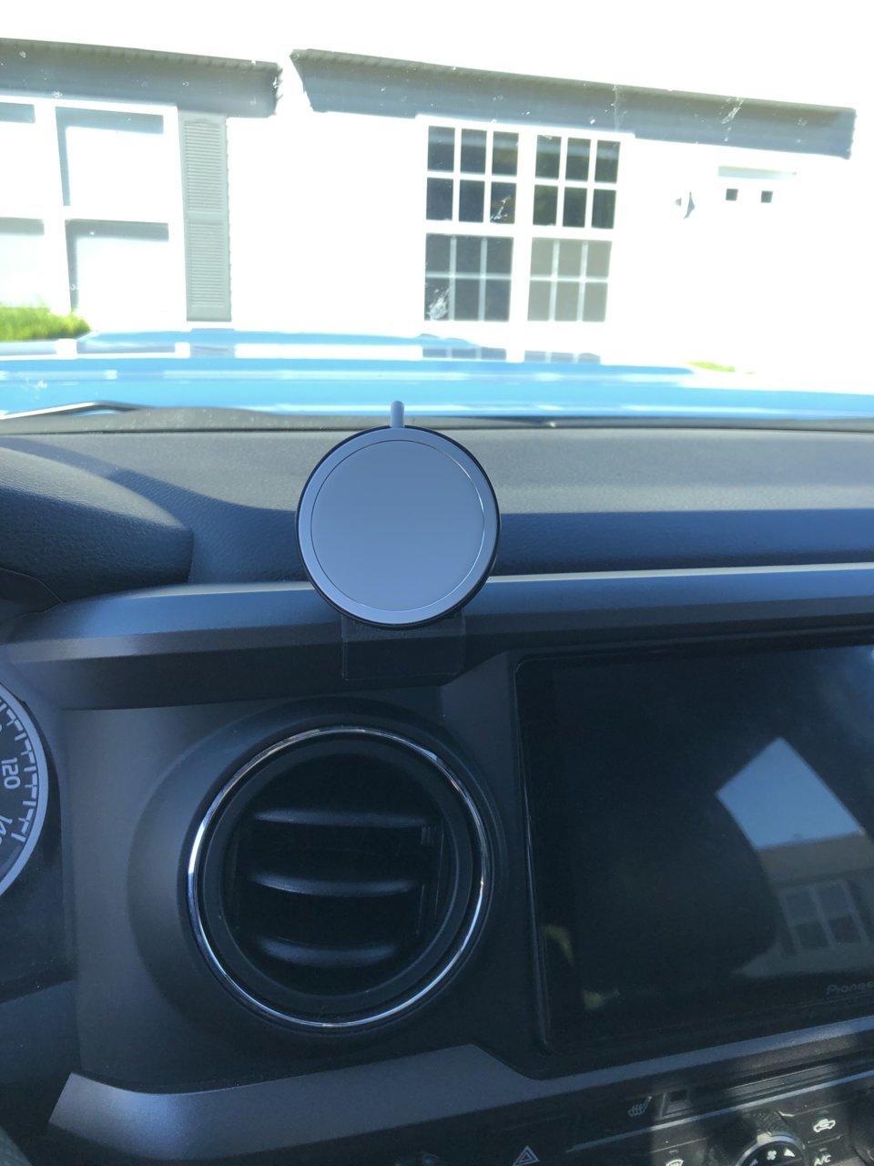

    I am looking for a bit of advice for wiring in a Magsafe iPhone Charger into my 2019 Sport. Right now my plan is to mount the Magsafe charger on the dash (where it is in the first picture) and wire it down to the fuse box located in the driver's footwell (second picture). The Magsafe charger requires 15W to charge and can only plug in via USB C, so right now the plan is to use an Add-A-Fuse female cigarette lighter (Link) in that fuse box, plug in a USB C cigarette adapter (Link) and plug the Magsafe charger into that. Where I am stuck is determining which fuse to tap in order to get enough power for 15W and to have it so power is only running to the charger when the car is running (not constant). In addition I am not sure where I should ground the adapter to. Any help would be much appreciated.
    Also I feel like no one has a great solution for a clean Magsafe mount yet so please feel free to use this thread to share ideas about a decent looking way of going about this. Thank you!

    I wouldn’t do an add a fuse in that fashion on any of those circuits if you require that high of a wattage, chances are it could work but when you use the circuit for what it’s made for and have the phone charging it could overload it. I would run your power from the battery or an added fuse box instead

    Use P/Outlet No1, thats the cigarettes' socket. If it blows nothing else fails.
    Ground to any 10mm bolt to the chassis.

    @regrubuen - I really like your setup, what kind of clip is that that holds the Magsafe charger?
