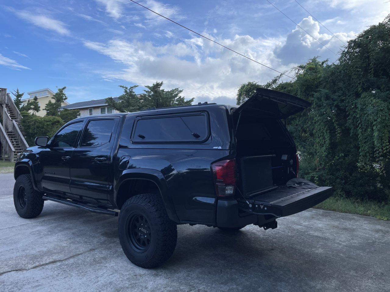

    Did some small stuff on the truck today. Scrubbed some minor rust spots off the sliders and coated those spots with Rustoleum.
    It’s been a few weeks since I installed the seat jackers and I’ve decided I’m sure I love them so I took them out and applied the blue loctite that’s recommended; then reinstalled them. Just didn’t want to do that right off the bat in case I wound up not liking them.
    I learned that blue loctite is basically like water in hot weather and I wound up spraying some of it on my center armrest :anonymous:
    Fortunately it wiped right off.
    I’ve also been having intrusive thoughts of upgrading from my current 265/75/16 tires to 255/85/16. o_O Any feedback from people who have made that switch and do a lot of highway driving would be welcome.

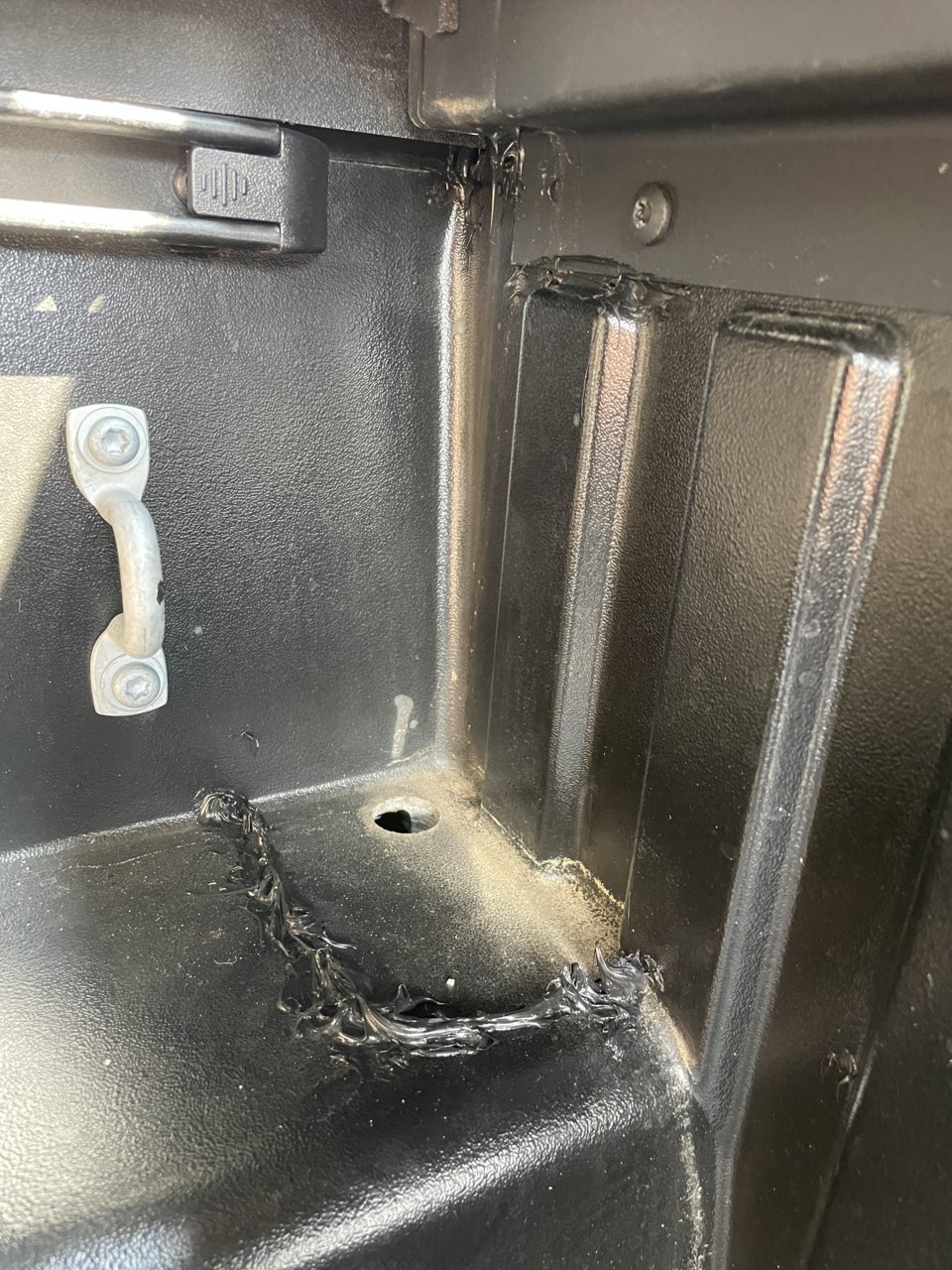

    Had some more rain and I noticed that the ARE cap is still leaking. It seems like now the only leaks are pretty small and isolated in the left and right corner of the bed, closest to the cap.
    My solution: I noticed that the water was coming into the bed near the drain holes that were cut for my old Bakflip cover. So, I used silicon to seal off that area. Theoretically now the water that does come into the bed will be forced into those holes and my bed will stay dry. Only time will tell if my plan works.
    :fingerscrossed:
    If you look closely at the photo you can see the streaks coming down the bed vertically where the water enters. Hopefully this should keep everything dry!

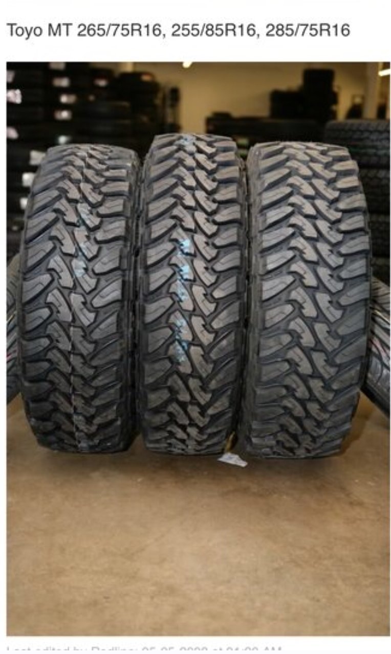

    I also found this photo during my research of tire related things. Thought it was the most helpful thing ever…so here it shall live in my build thread for future reference:

    Also, an update this silicon idea, it looks like it works pretty well. We just had a big rain storm and the silicon channeled all the water that leaked into the bed into the old Bakflip drains just like I hoped. The bed itself stayed totally dry.
