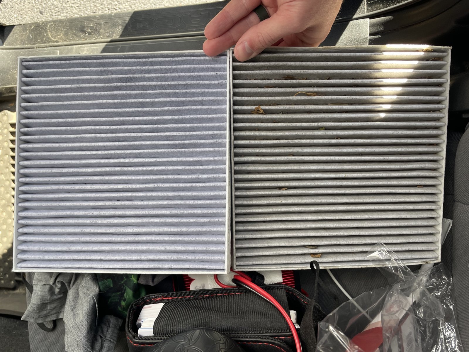

    Replaced the cabin air filter today…Old (right) v. New (left):

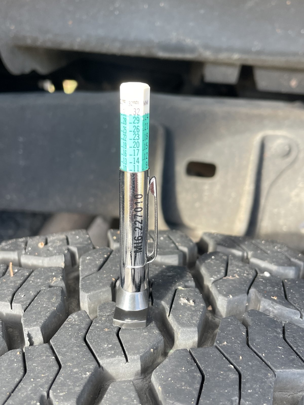

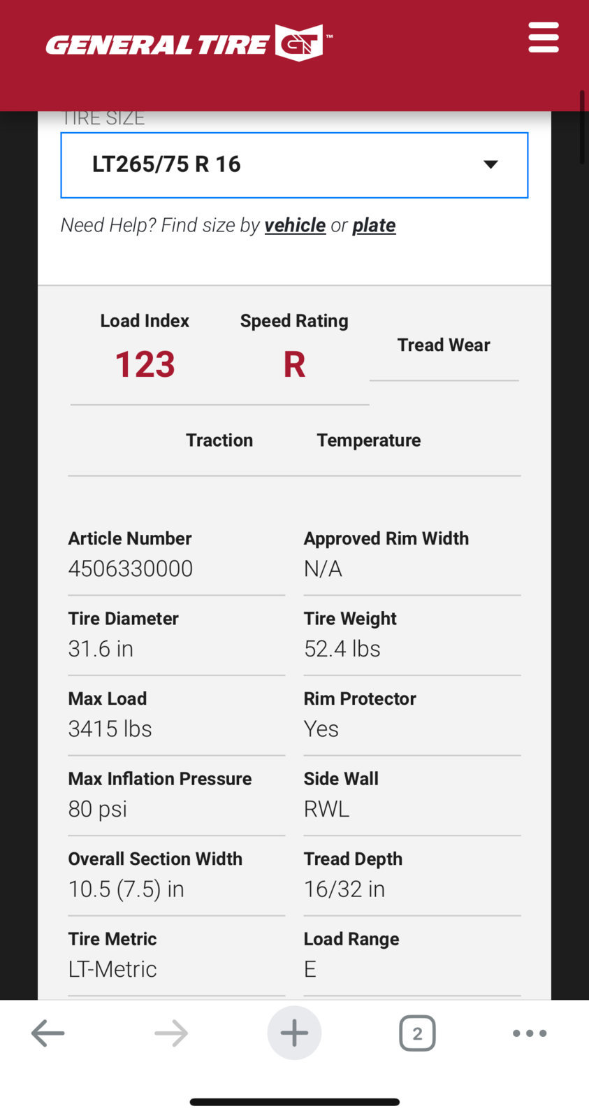

    I also checked the tread depth on the grabbers again. This set has 42K miles on them and all 4 tires are still at 11/32nds. They came new with 16/32nds. Maybe I’m doing my math wrong but if we assume that 2/32nds is the end of a tire’s life…I think I can get 100K miles out of these?
    Specs when new:
    That has to be wrong, I can’t imagine a set of tires would last that long. I’m bad at the maths so if anyone wants to correct me, feel free.
