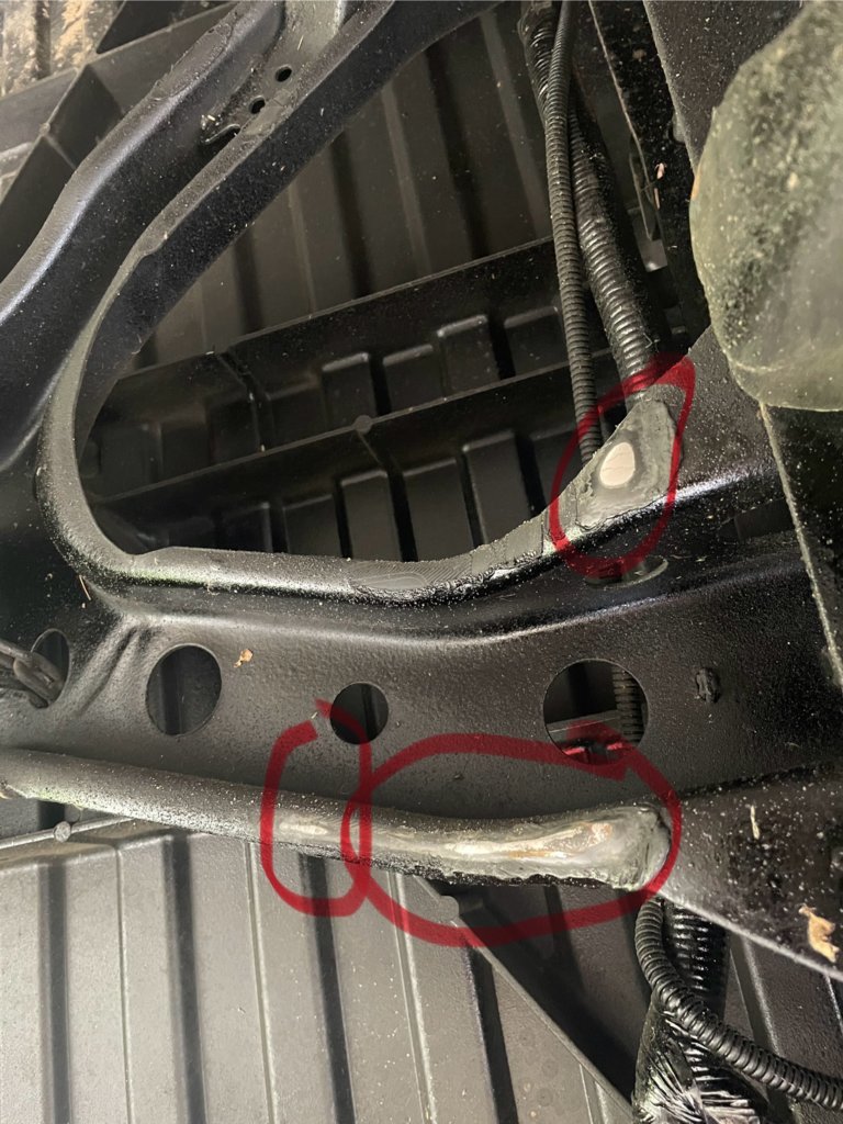

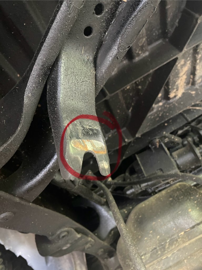

    Okay I have an important PSA for everyone.
    I just dropped my full size spare to make sure the chain was working and everything was in working order. As some of you may recall, I had my undercarriage professionally coated a couple years ago. It turns out that the spare tire was rubbing against several parts of the frame and totally rubbed away the coating, to the point where it’s just bare metal:

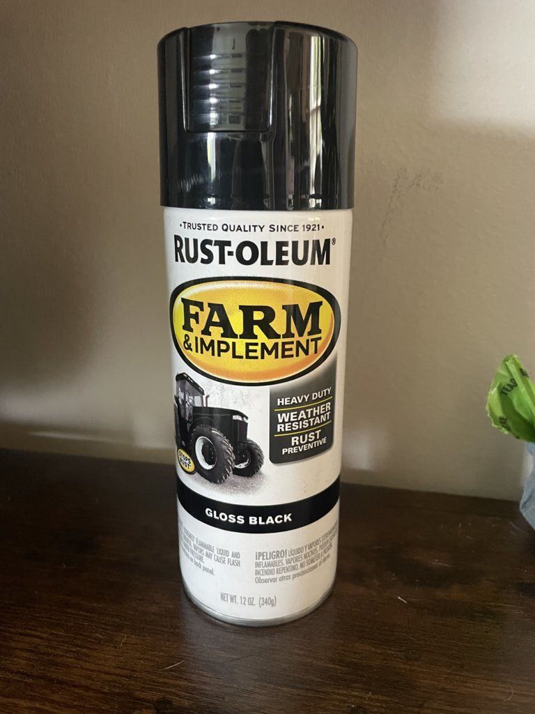

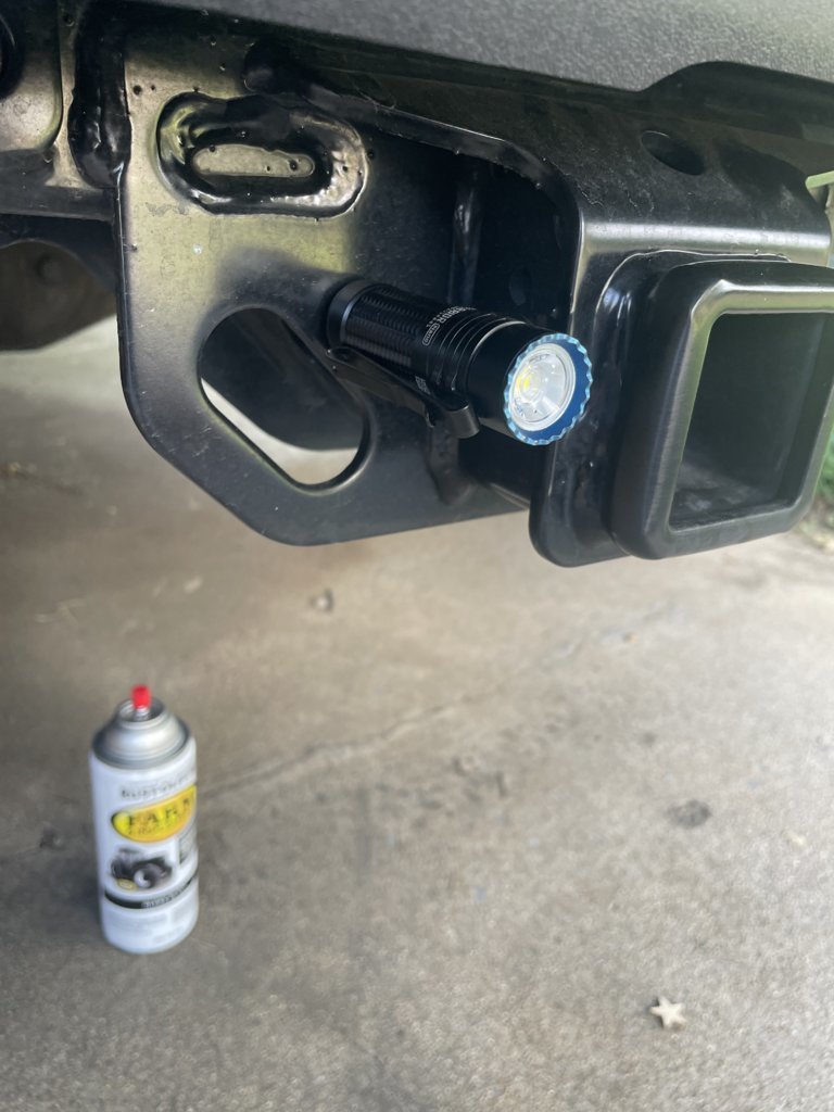

    I’m super thankful I found this before the winter comes around. I got in there and hit it with some of my rustoleum farm implement rust preventative spray (can is in the pic below if anyone is curious). I get the frame re-coated yearly but the rattle can will do until then. Also gotta love the o-light flashlights for being magnetic and super functional. They’re the only lights I use anymore and I’m not ashamed to admit I have a lot of them lol

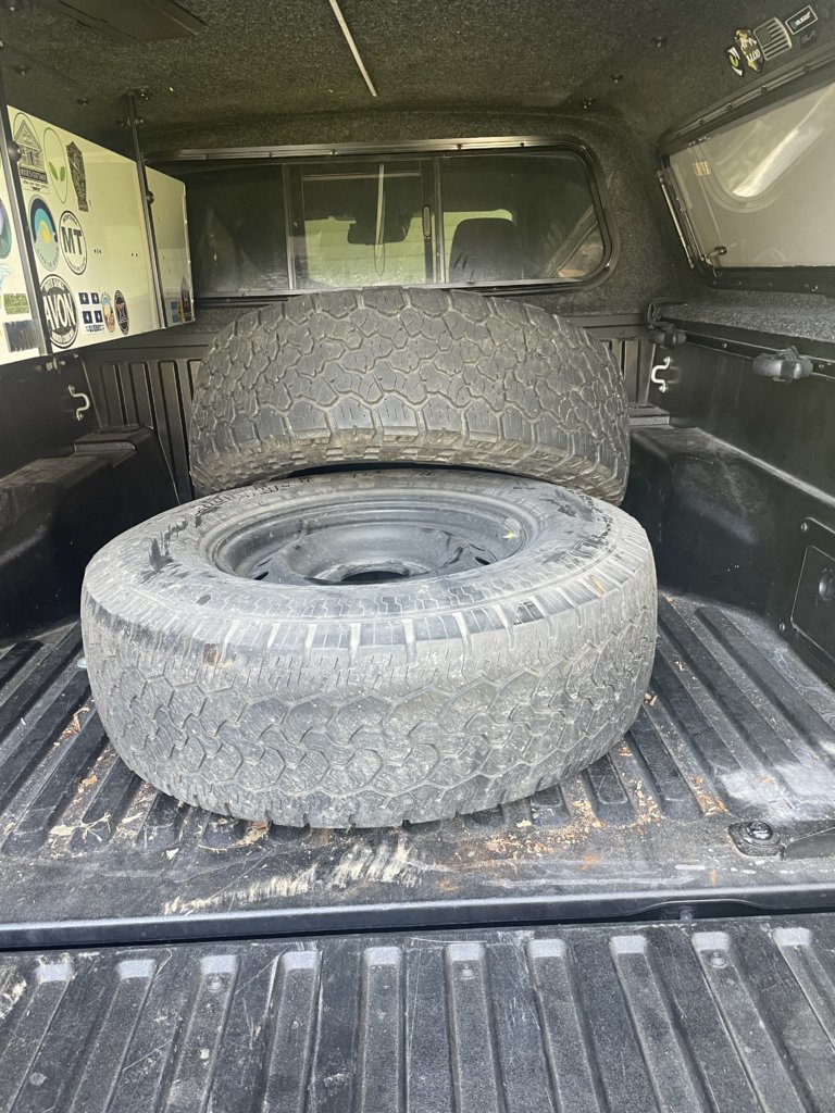

    Also, switching my old beat up BF Goodrich spare (still on the wheel in this pic) to one of the Grabbers I recently took off the truck:

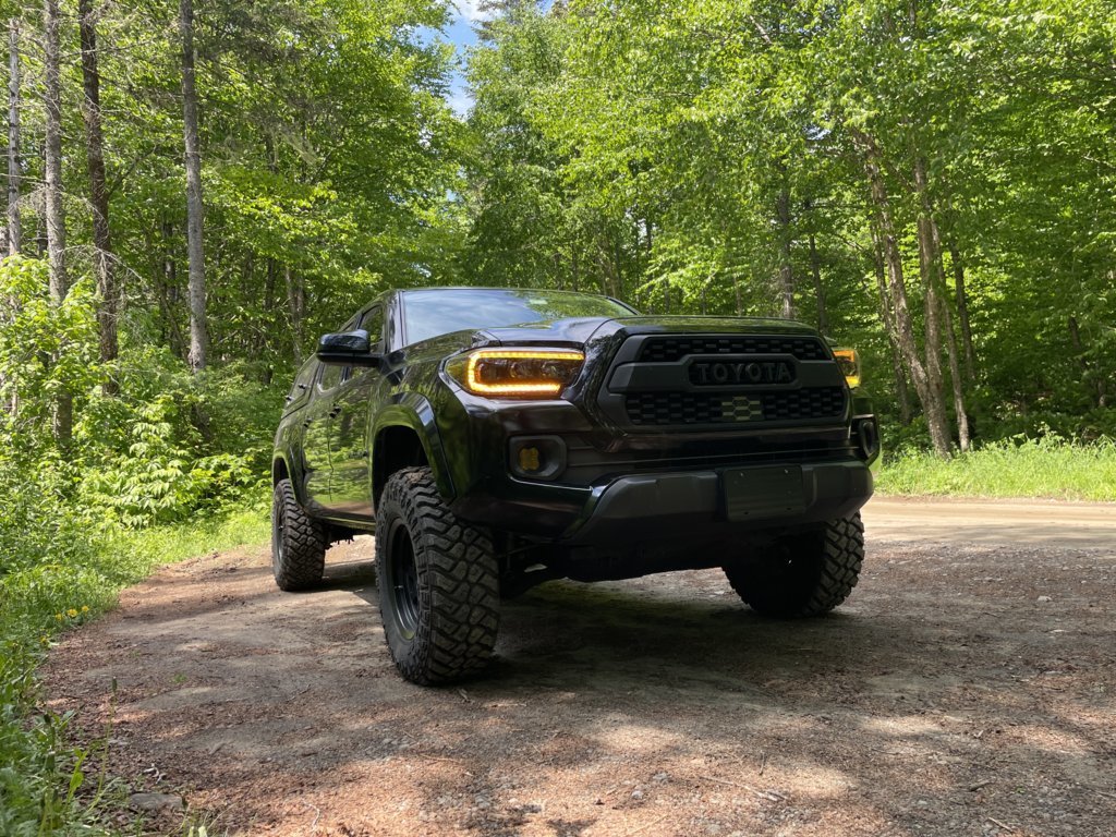

    Not sure if I posted this pic before or not, I think it may have slipped through the cracks and I forgot after I took it…

    Damn, that’s a great looking truck/picture

    Oh stop it!
    Thanks though! That shot is from a few months back in Canada.
