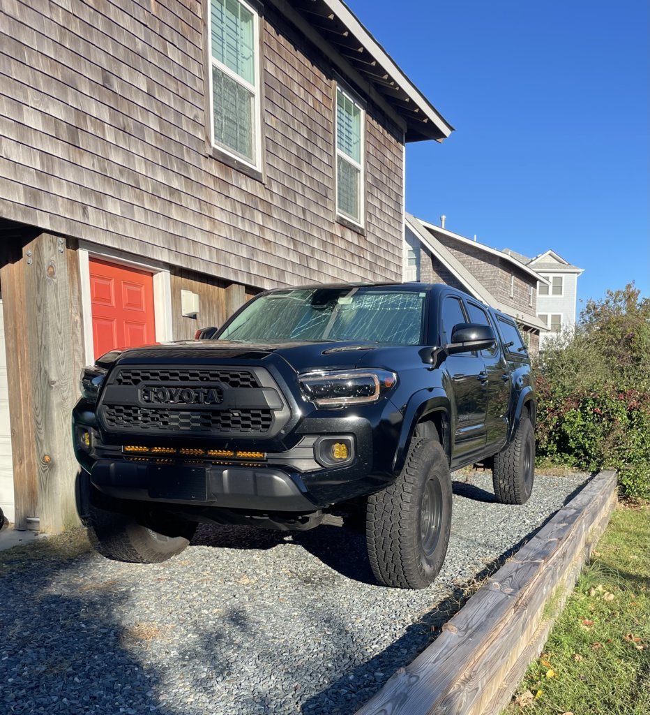

    Well I think I have found the perfect mix of form & function….

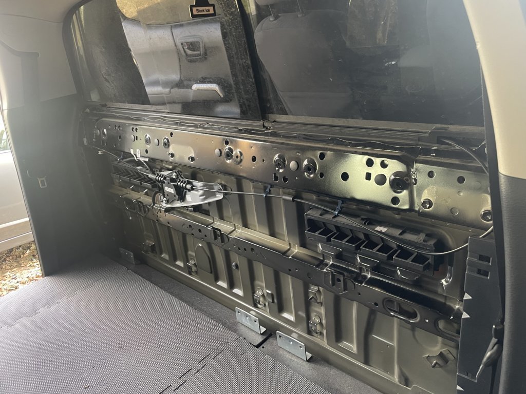

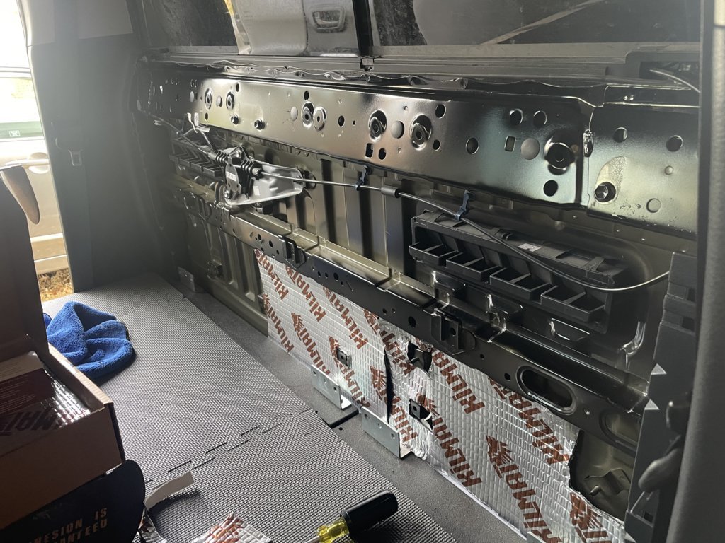

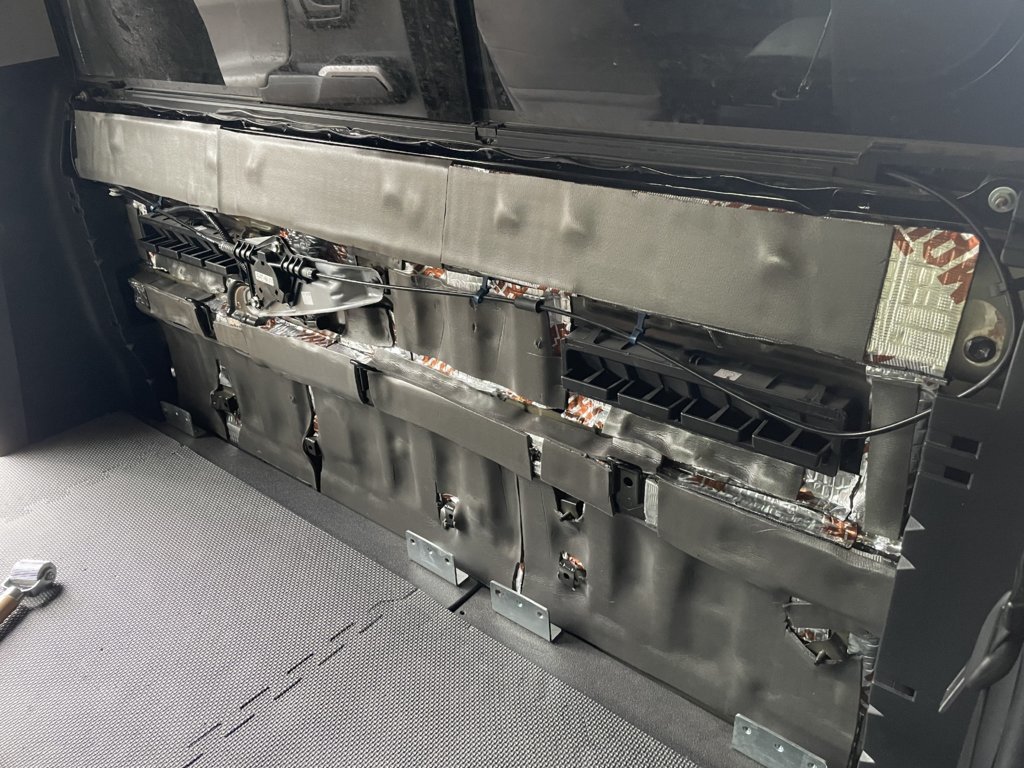

    I finally got around to a mod that I’ve been day dreaming about doing ever since I got the Goose Gear rear seat delete…Sound deadening the rear wall of the cab. Here are some pics:
    Removed the goose gear rear wall and cleaned up the bare metal rear wall of the cab:

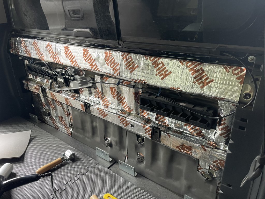

    Kilmat went on first…

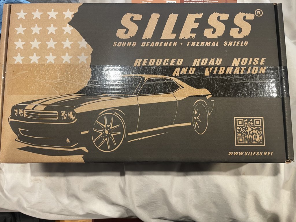

    Then the Siless foam pads on top of the Kilmat once I had Kilmat covering the wall:

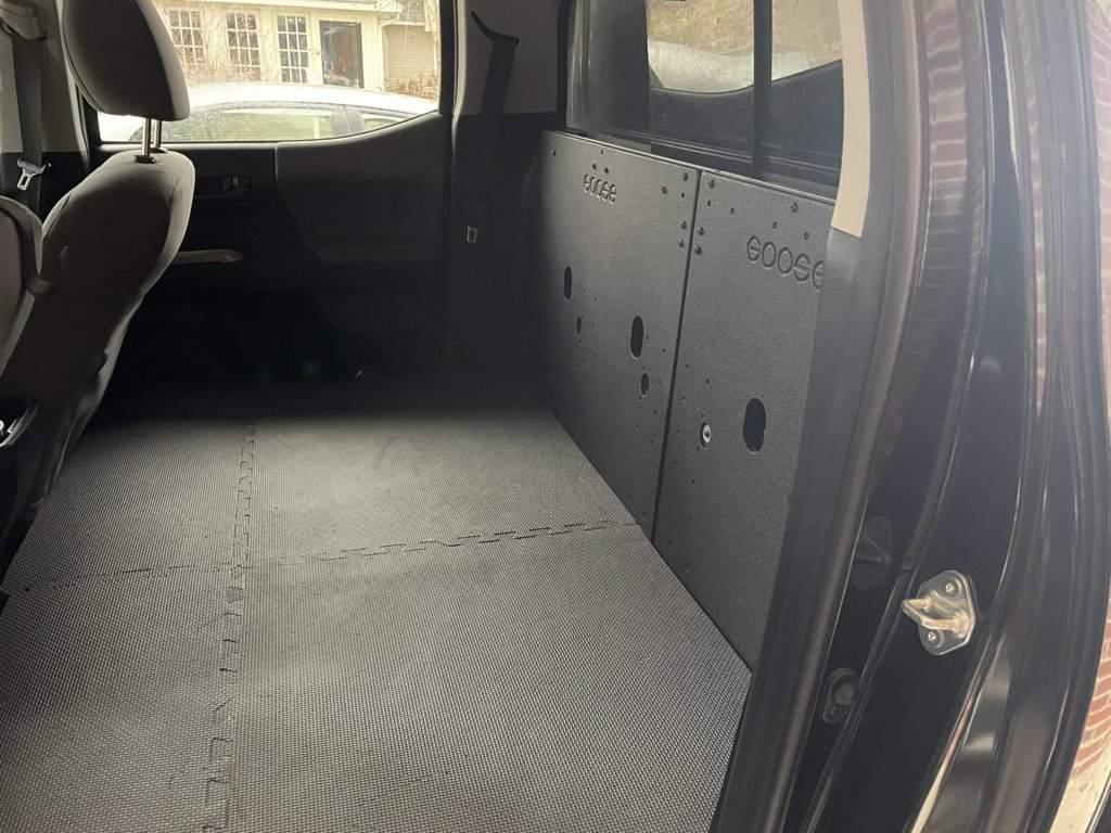

    Finished product:
    All put back together and ready for the dogs again:

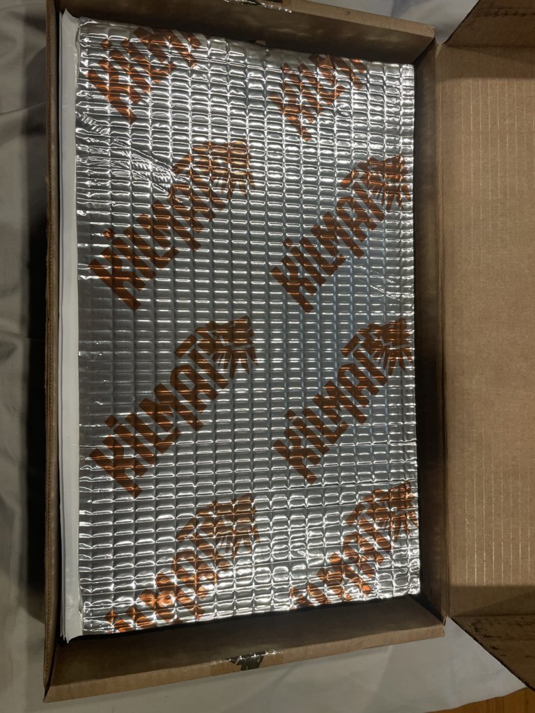

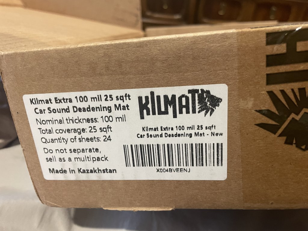

    Products used:
    I also used one of those roller tools to flatten out the panels after I put them on the wall of the cab. A hair dyer was critical as well since it was about 35 degrees out while I worked on the project.

    Kazakhstan?

    I laughed SO hard when I saw that because I thought the same thing lol

    looks great! Let me know the results after the ride for sounds.

    when I did my delete, I put mat on the truck wall and on the back side of the board and it was still really loud. I found 90% of my noise was from the vents, so I took an old memory foam mattress topper I had lying around squished it between the board and the truck wall. Now it's damn near as quiet as with the rear seats.
