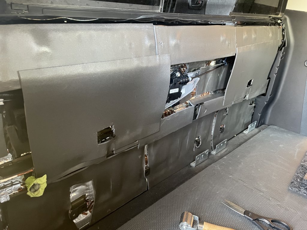

    I removed the goose gear wall again and made two flaps for the rear cab wall vents. Air can flow around the side and through the whole in the middle. We’ll see if it helps with the sound.
    If anyone didn’t know, the two vents in the rear cab wall have little fabric flaps that just flap around so you basically have to permanent holes to the outside in your rear cab wall.
    Before:
    After:

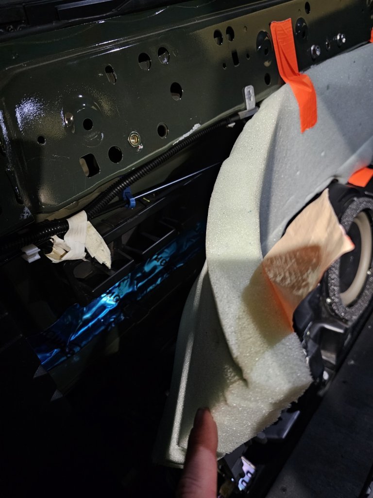

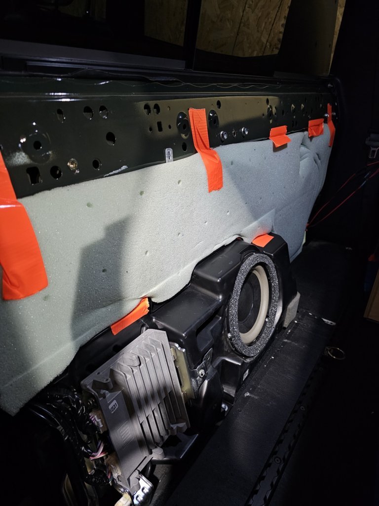

    Shoot I forgot to get photos! I'm working from home today, I'll go get something quick. Needa take a lunch break anyways.

    Here ya go. Its I think 1.5inch thick memory foam mattress topper from Amazon.

    Oh nice!! That’s super smart. I can see how that would help for sure.
    I was trying to figure out a way to re-attach the OEM foam carpet stuff that was back there but I covered up the mounting holes by mistake and couldn’t find them again lol
    I just went for a drive and these flaps I made with the Siless foam seem to work pretty good. That tape you have looks like a good mounting solution though if I do want to put my OEM carpet mat thingy back up behind the goose gear.
