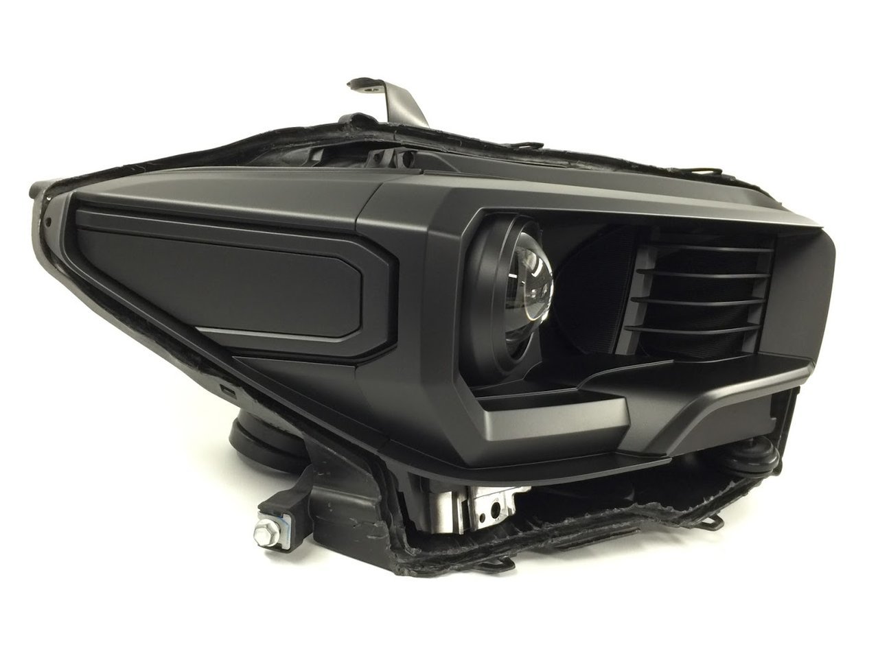

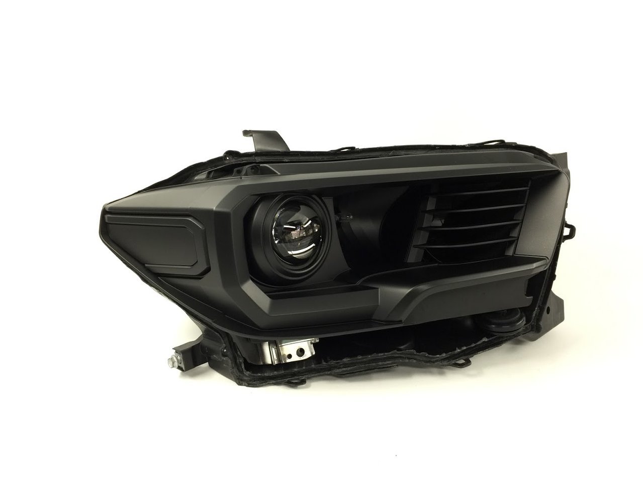

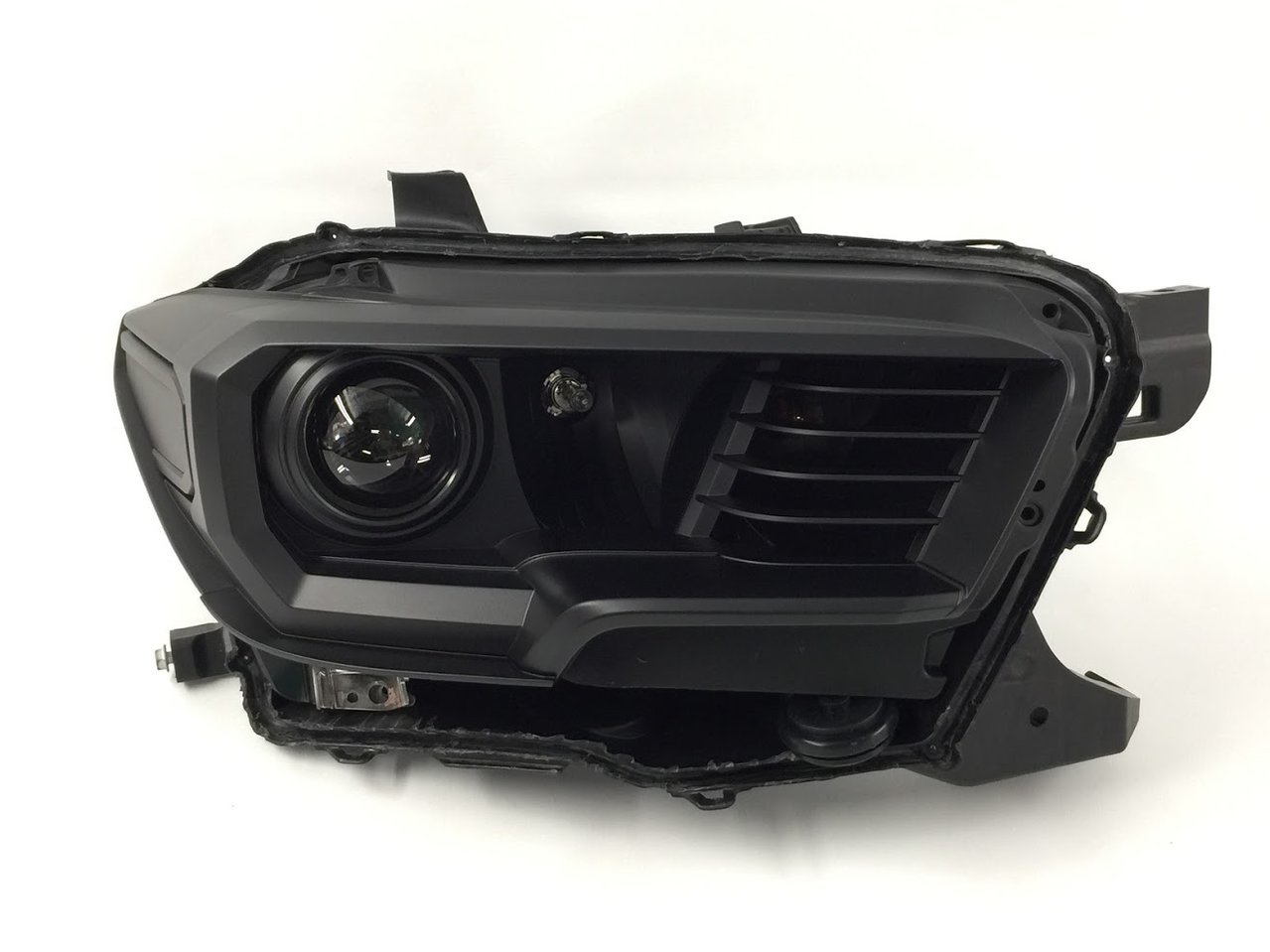

    New to the forum but wanted to share a recent Tacoma related headlight project.
    I am a function>form type of guy which is reflected in various automotive projects whether it is modding my personal vehicle or doing various headlight projects. I like clean, simple>busy, and performance>aesthetics.
    High beam bow was deleted for the sake of aesthetics since it would have been a serious eyesore since everything else was black. The Lexus projector is bi-xenon and offers an adequate high beam. Turn signal bulbs were upgrade to brighter LED units to compensate for the blacked reflector bowl.
    Feel free to ask questions,
    Evan
    Specs
    Black Everything
    RX350 Bi-X + STI-R + Tuning + Shield Trimming + Black Demon Eye
    Morimoto 5,500k D2H Bulbs
    Hella Gen 3 35w Ballasts (AMP) <--Best HID Ballasts, see video below
    H11 HD Harness
    H11-9006 High Beam Adapters
    Acme switchback LED Turn Signal Bulbs
    RQVfvQ82JjxjslddDRaW1ZocSVrwwb_nf3boZqNK_81aecce7bf2df904fdd903cff0590832906e2767.jpgI3zaqnCWoNEcIlEKFIUE0jAAf2cSOZjveeQYfcjE_6bff4bb745a37cdbe69abb39e5c5a4f4fa161ee6.jpg

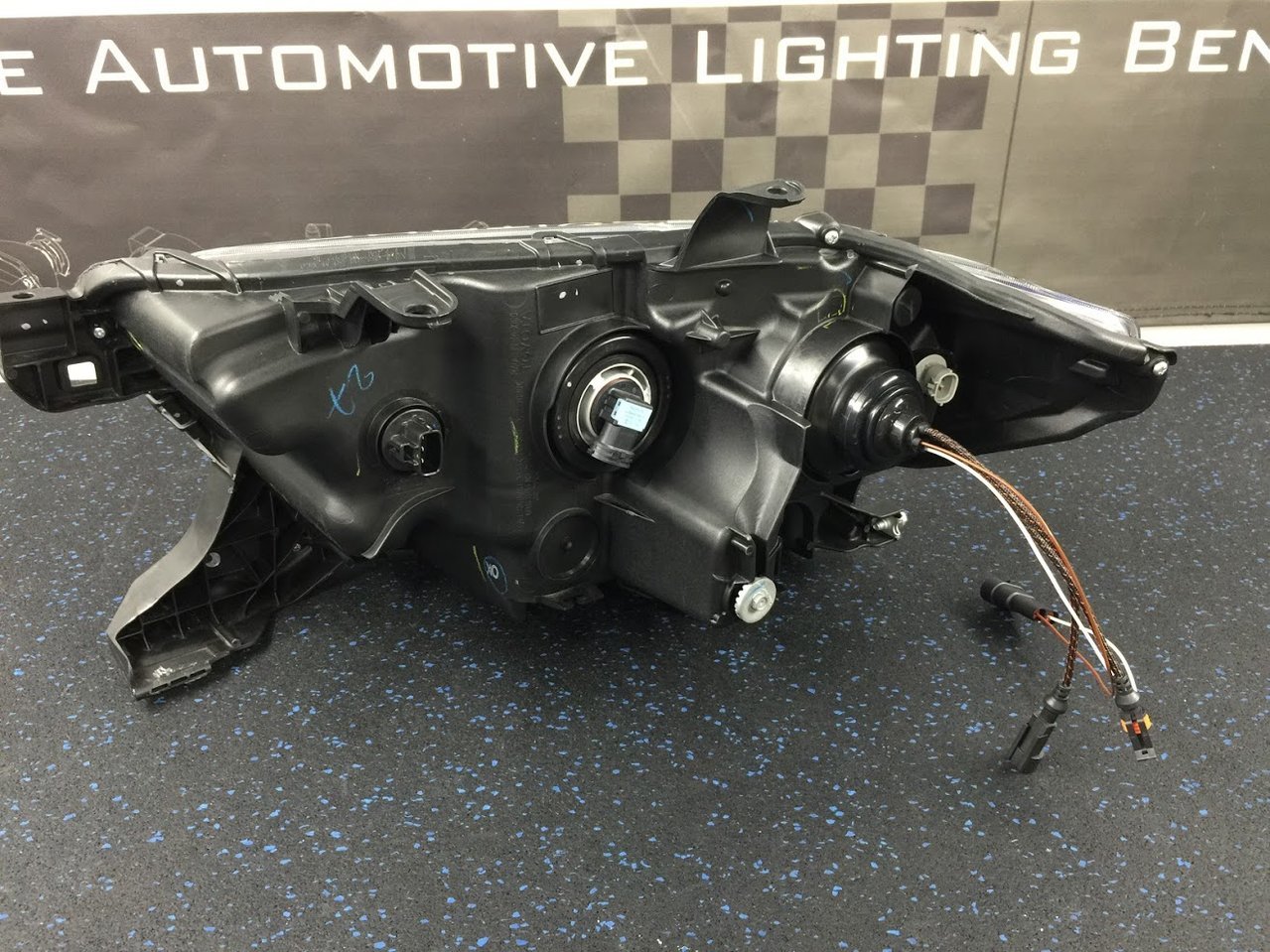

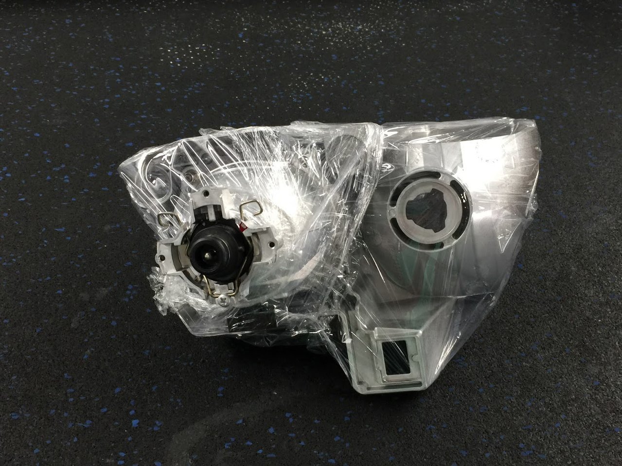

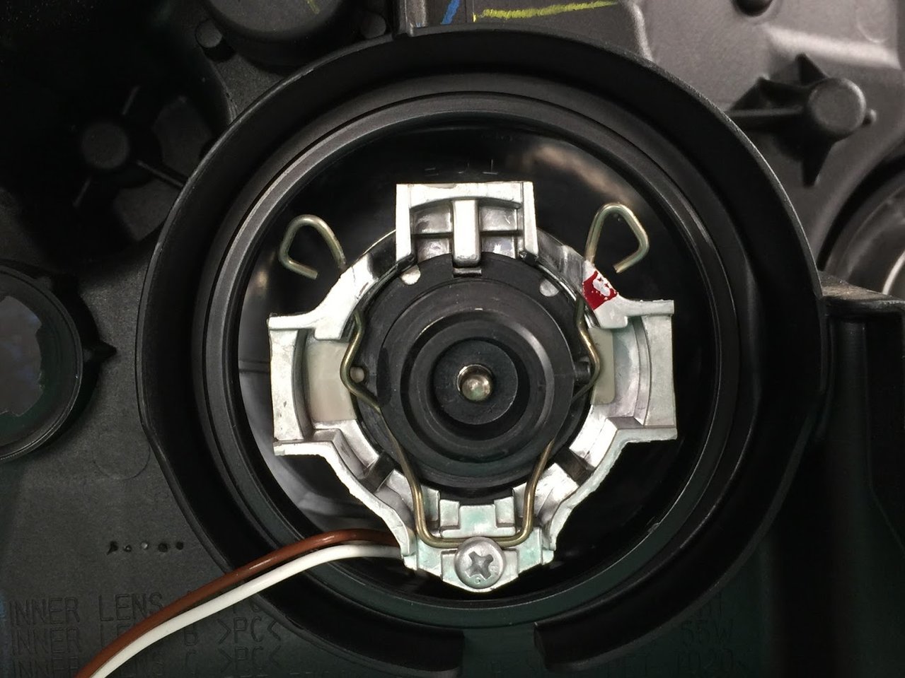

    Tight fit against the back of the housings, I needed to find a solution.
    87QZTUou9A1IEBMmYoD0yqnFiWU9MdZcooNHY_ez_963800f63aa5a18d01f79ed77a52701782a14834.jpg

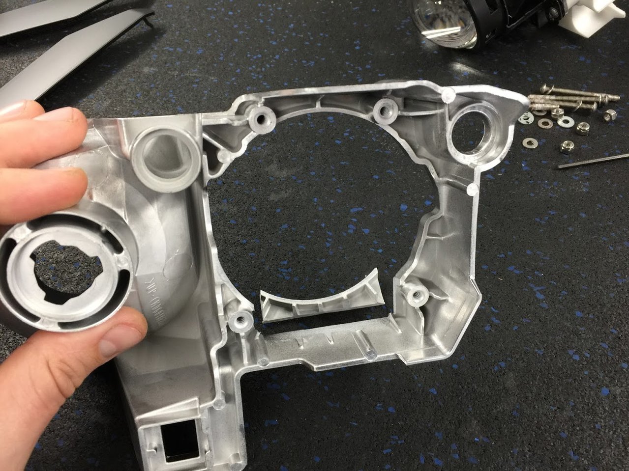

    Wrapped it up and busted out the Dremel

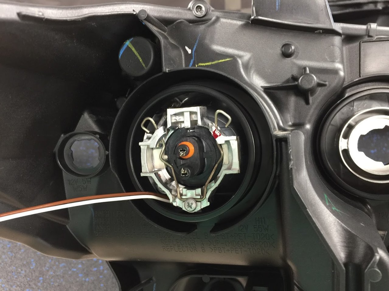

    KRPl5yWAeKtAUYenR0r6kNdGFsHZvuc1U80ZoEr7_5b8010f7ee06f61b3a45682925d917faf5b6da48.jpg
    Projector trimmed on top and sides, bulb retainers were also cut and rebent

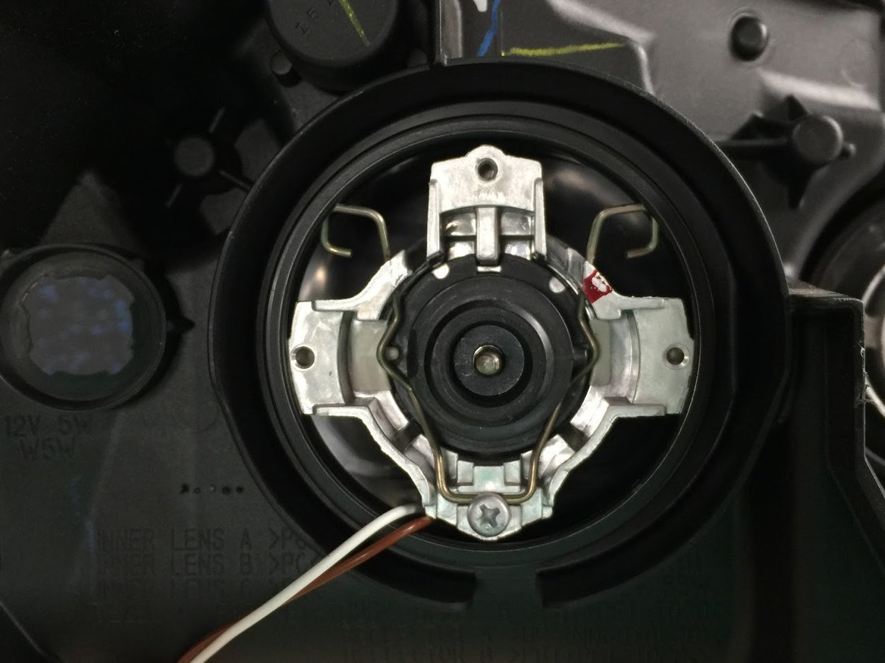

    4bAySFDsaLhyyycuvN-yYOQ6jvqL9VN3n8O_nVr4_7b93f564ed453df3381e6b811e723187100c5407.jpg
    Swapped from D2S to D2H, original bulbs were Mori so no downgrade in performance just easier igniter routing and sealing options.

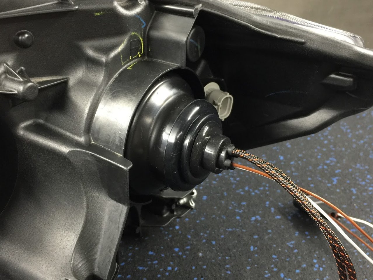

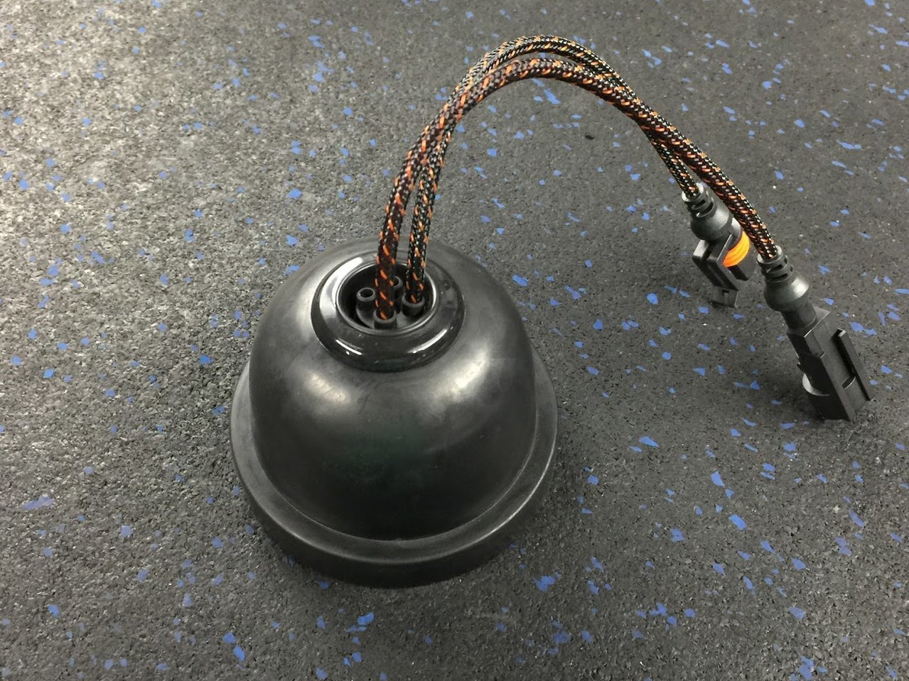

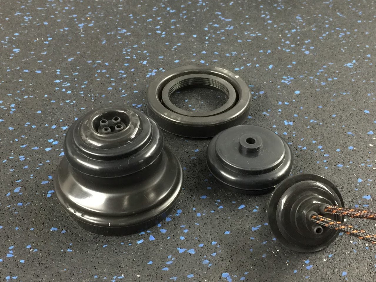

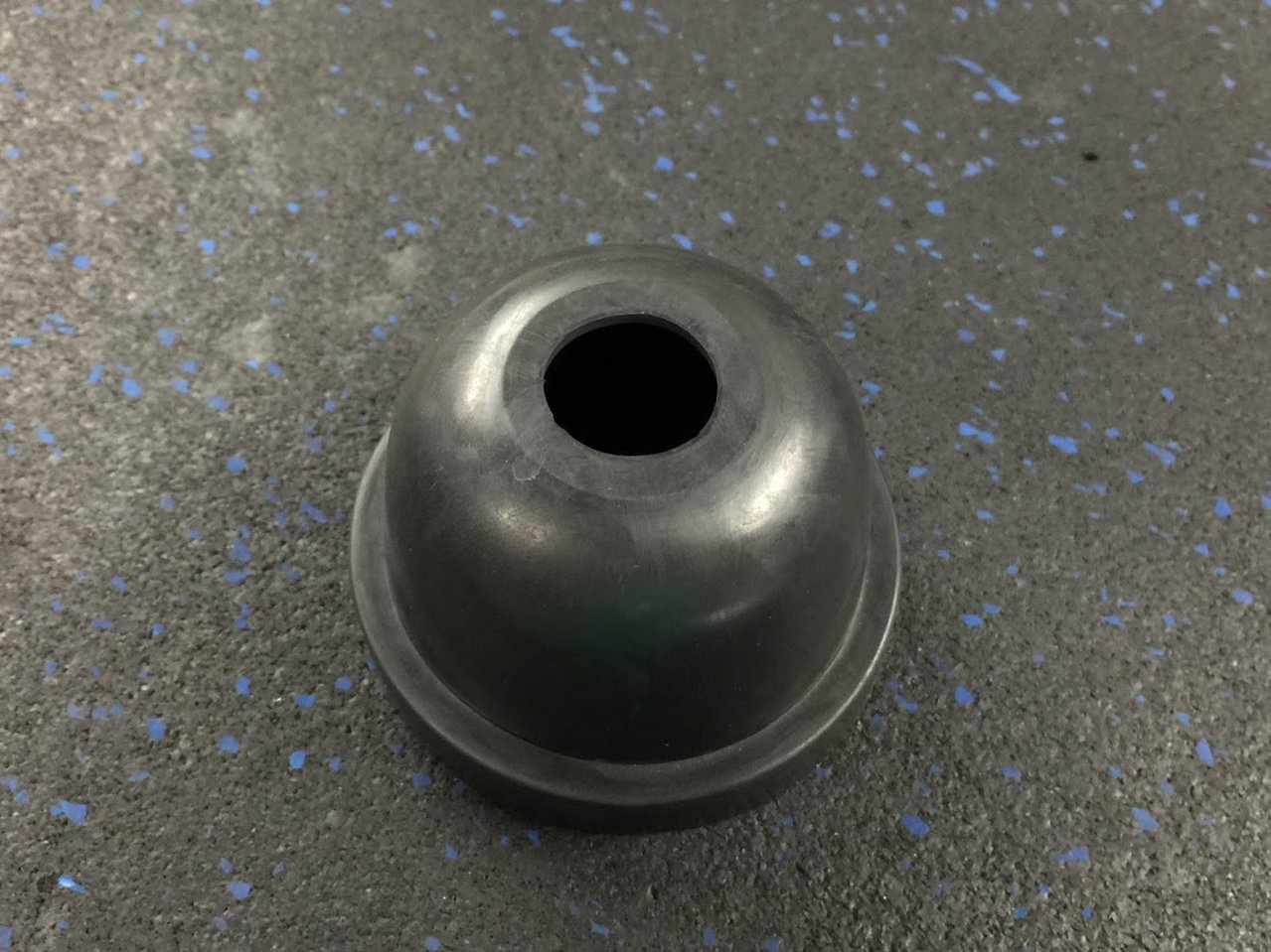

    Original plan was to use an housing cap
    zey2eiVR0iFYSUu2SkXD3F7CDOVhYCSPNd3r1oTZ_1a5ac340c81345f574c07bd3edf3db0e888f4da4.jpg
    f6jdO-e-P_LZnSD_Sx7DKo-qP8LU-tzZEghwvr4b_d1401a42573dd4f3b63fbd1ee18832de3aa86949.jpg
    I would have needed to add small screws to lock the housing cap in place, wasn't thrilled about that and there also wasn't tension between the housing and cap so no tension means opening for moisture and dirt. I created a3 in 1 cap using the oem gasket (extended), and D2S cap, and then the AMP cap, they all stay together and in place on the housing with tension.

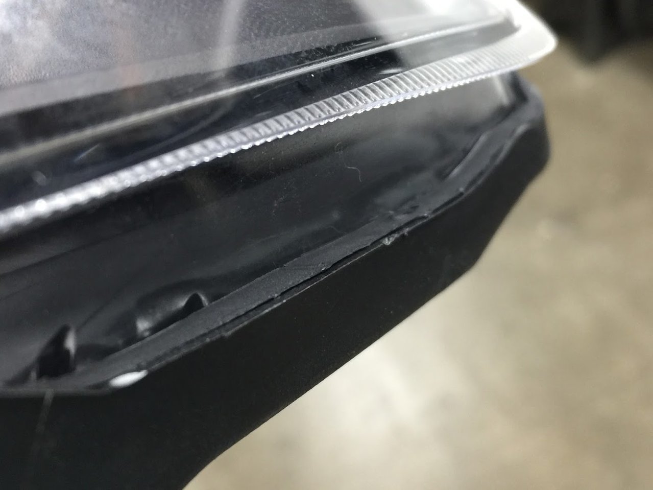

    Excess butyl razored off for a clean edge

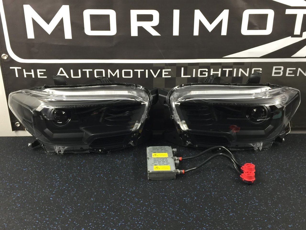

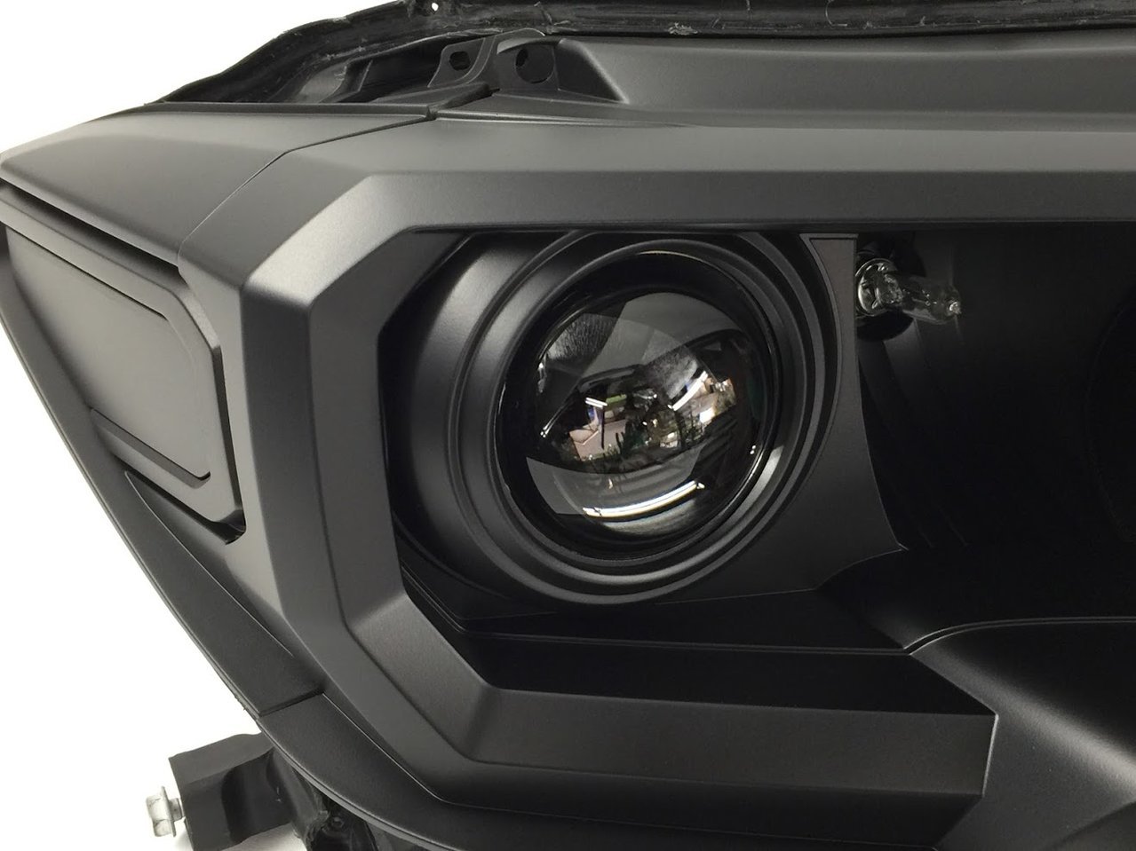

    Some glamour shots
    J8LyYsZ_J5Xyz3743RQ-mAg_bLzUnJXqoM_siljO_7a0bacdd9e258958807e89c1120c49ec87025202.jpg
    fuiScvx6sLCqWT074Q9Jsx9HVYZzN8p2jCTWHmV2_11d114e03bfc09b78e747c25e5a701967021652c.jpg
    9bHxnwm7SwW1JCQ3M9qrTg1qJR4GtxqETLpGstX3_faf6bd0548f8ab786613a5badbf74c57b66a7cf9.jpg
    I9bPdAQAdiPWG10KKyEO77izJ9W7XT1k6jC-js4W_32c25da4569b1231027e121a9ce4e769e1772e8c.jpg

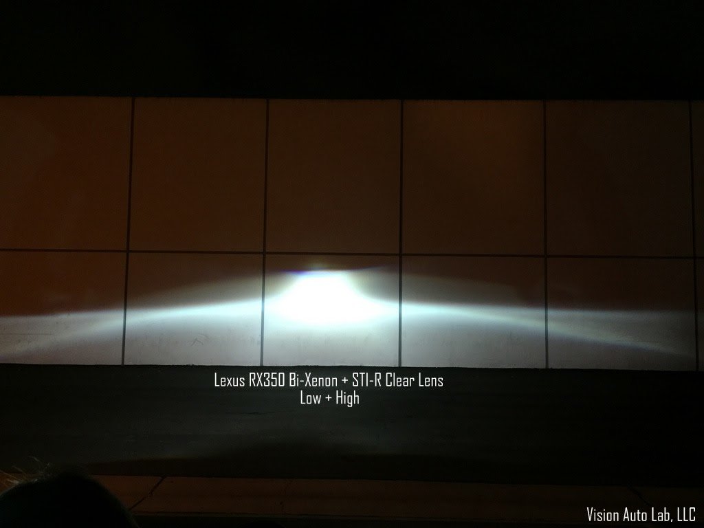

    Output pics of the actual projector
    BTZFZJ-bFF3hsLrTDhJCwmtovhxcV1UPmUAerWAe_30aef4771f628fff14f28fd7a6b74f81fc16dfaf.jpg
    z5PUsBH6MOMUJQAPeRgHDmm_6eOKyzpl-YqjWNSr_e7172e9d17eee54106a6bc4f401ace24fce73043.jpg

    You and @mesojdm should do a 3rd Gen kit together. Thank you for the write up and welcome to TW!

    +1 for Tuned/STi 350's! Running same setup..LOVE them. Nice build just a little too black for me.
    High beam is worthless, But the Bi-xenon makes up though.
    What are you doing for turn signal? Without a reflector bucket it's gonna be like a birthday candle.
    By the looks of it..you seem to do retro's for a living??
    Again, Props for craftsmanship!

    Thanks, this write up was short and sweet compared to the photo documented novels I normally post in forums.
    Less is more!
    Thanks for the kind words.
    Ideally a smoked reflector would have been in there along with the oem LED DRL, I think those 2 elements would have added some nice contrast.
    Turn signal is an Acme switchback, Triton V3 would have been ideal for the raw power it provides but is also has a powerful price as it's x5 more expensive than the Acme.
    I am an "automotive lighting enthusiast"
    Evan
