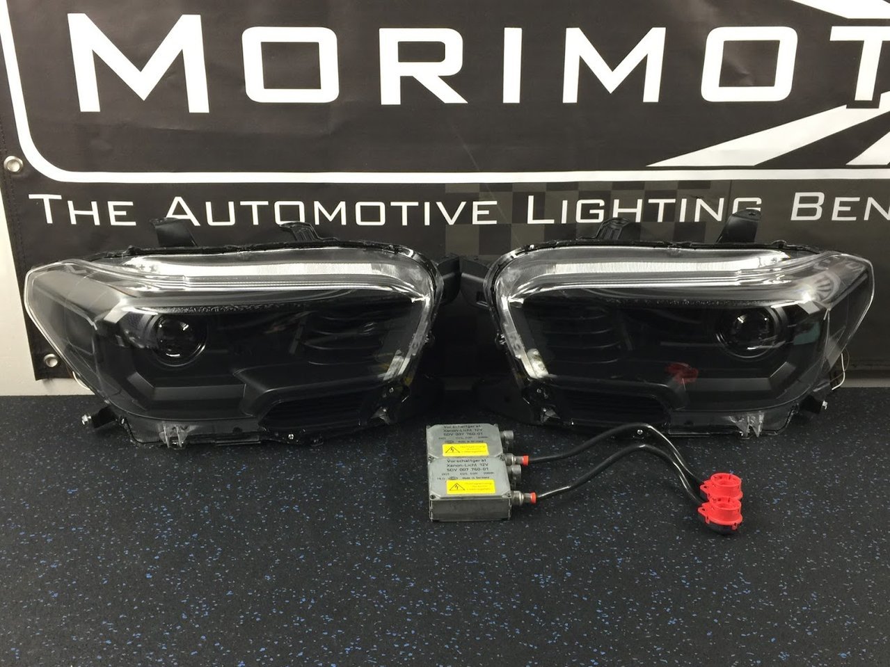

    IMO if you are going full blacked out (painted reflector buckets) I would run DD's switchback turn boards. That way you retain at least some turn signal visibility. High beam bucket won't matter if you are running a bi-xenon.(although that is a waste of dead space now).

    I want to do this so bad but I'm scared to wreck my headlights opening them up or not getting them sealed correctly. How bad is the high beam output when you black out it's reflective surround?

    ^ wouldn't say worthless.. but close.

    Nothing worthy
    Thats why just a light spray of smoke is what I'm thinking, not full out black sprayed.
    I tried it on a piece of "chrome" i had in the garage, looks good and still kept some reflective integrity.
    I'm not doing any retrofitting but intend to upgrade my bulbs, rarely do night HWY driving

    Reflective integrity will be compromised by tinting them, I recommend doing one or the other. Retrofit the Lexus RX 350 Bi-Xenon projector and you can happily delete the high beam bowl as it won't be needed. Then upgrade the turn signal to Triton V3 so that the raw output of that bulb can compensate for the chrome being deleted.

    Good call. Or a cheaper lumiled Amber in the turn bucket and a DD switchback board for the same price..and it will probably be brighter.

    Ive replaced my amber turn signal with a yellow one and its WAY brighter.
    I feel I should be ok with tinting ht turn signal bucket at least.
    I think the yellow on black will actually look super slick
    Wish I knew more about lighting and was a bit more capable of retrofitting some RX light in there. I need to save $$ for suspension! lol
