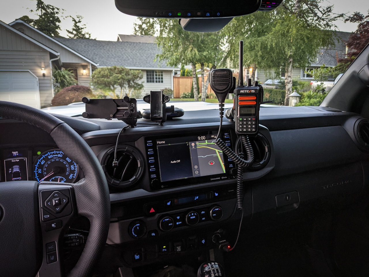

    Not nearly as fancy or high powered as what most of you are running, but I'm quite pleased with my GMRS install with a Retevis RT76P w/battery eliminator and a Commountain speaker mic. Used a Rugged Radio bracket fixed to a RAM Mount diamond mount (modified) into a DIMM mount. This setup gives me the ability to remove the whole setup easily when I don't need comms.
    I figure further down the road if I find this setup doesn't have enough range for my needs I can invest in a Midland setup with an external antenna and make this my handheld/backup.
