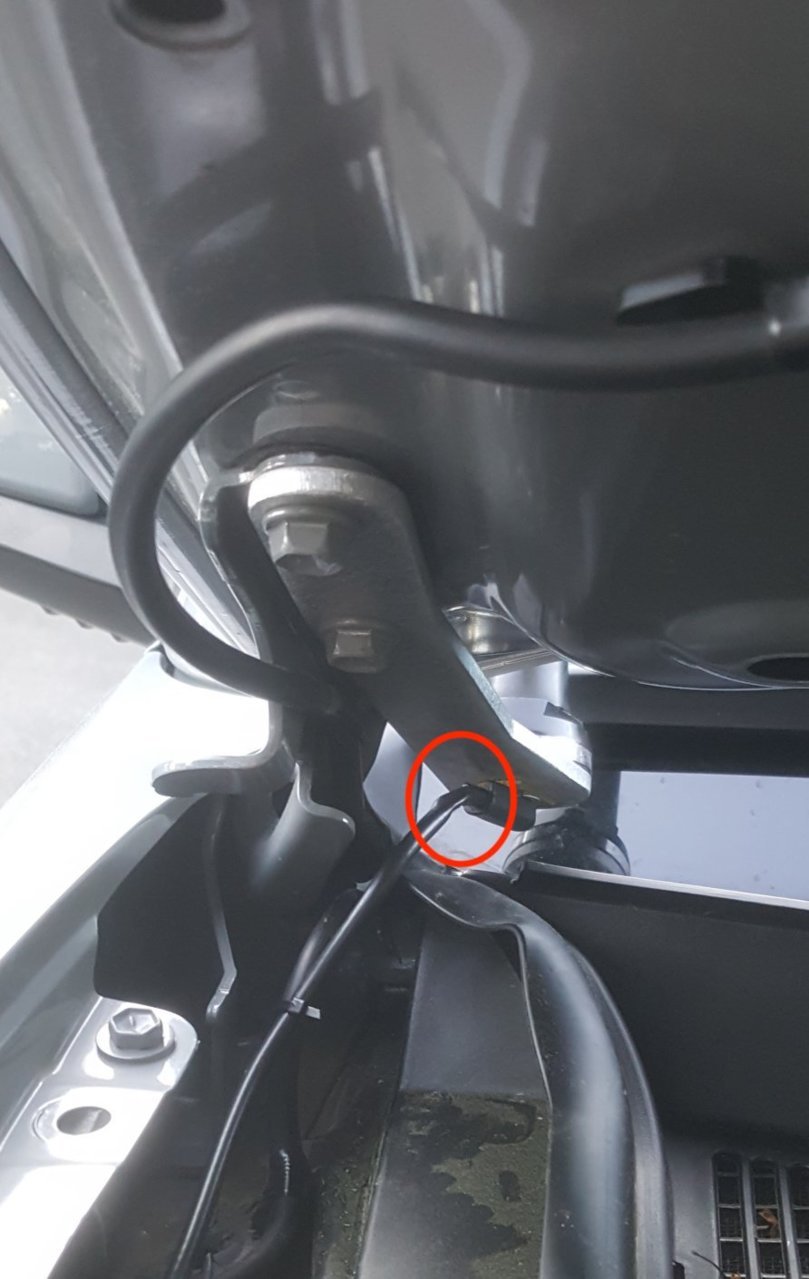

    Guess I never posted these pictures here. I was sick of replacing my antenna cable and having to pull panels and carpet to do it (winter here destroys the cables)
    So I put a antenna jack inside the engine bay that I can just plug the new cable into.

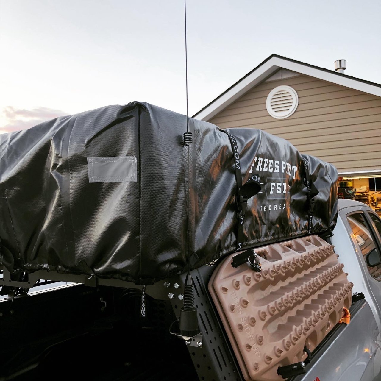

    GMRS but whatever. Just replaced the rack with a alu cab shell, so I’ve got to figure out a different antenna mount solution.
    F9F69400-C59D-4EC1-9A0B-14909B2A08A6.jpg 29644CCA-56CD-4D7E-9EF4-2D9CE5C113B0.jpg 80FC7EF0-AFA8-4D27-80E0-F03DDEEB1360.jpg

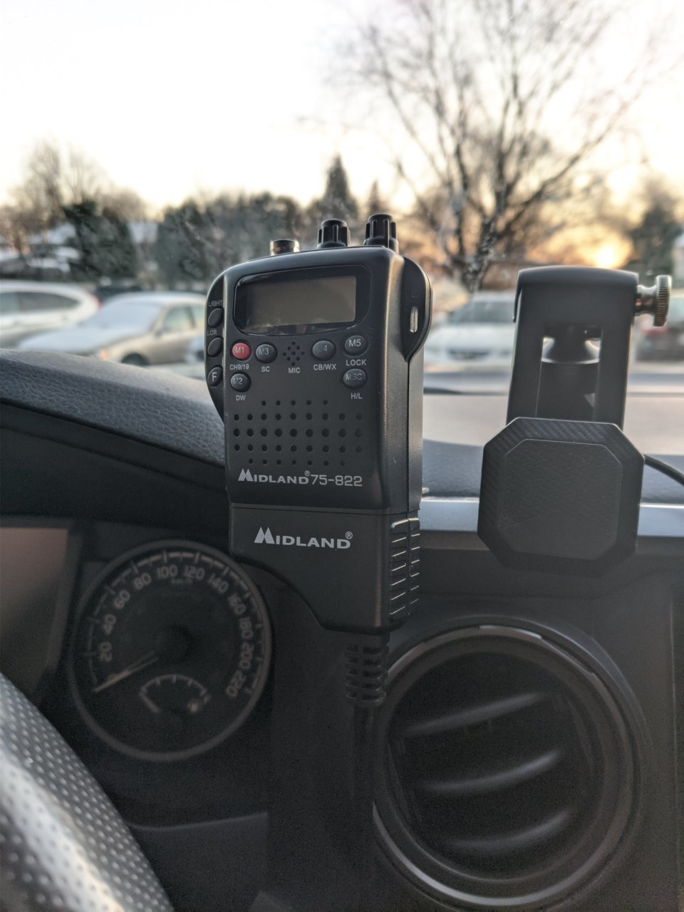

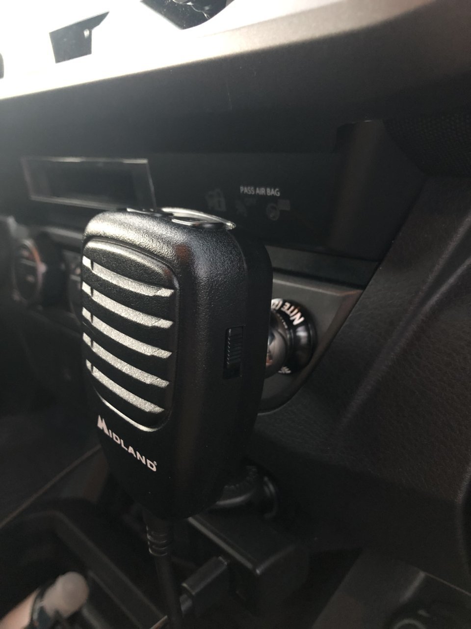

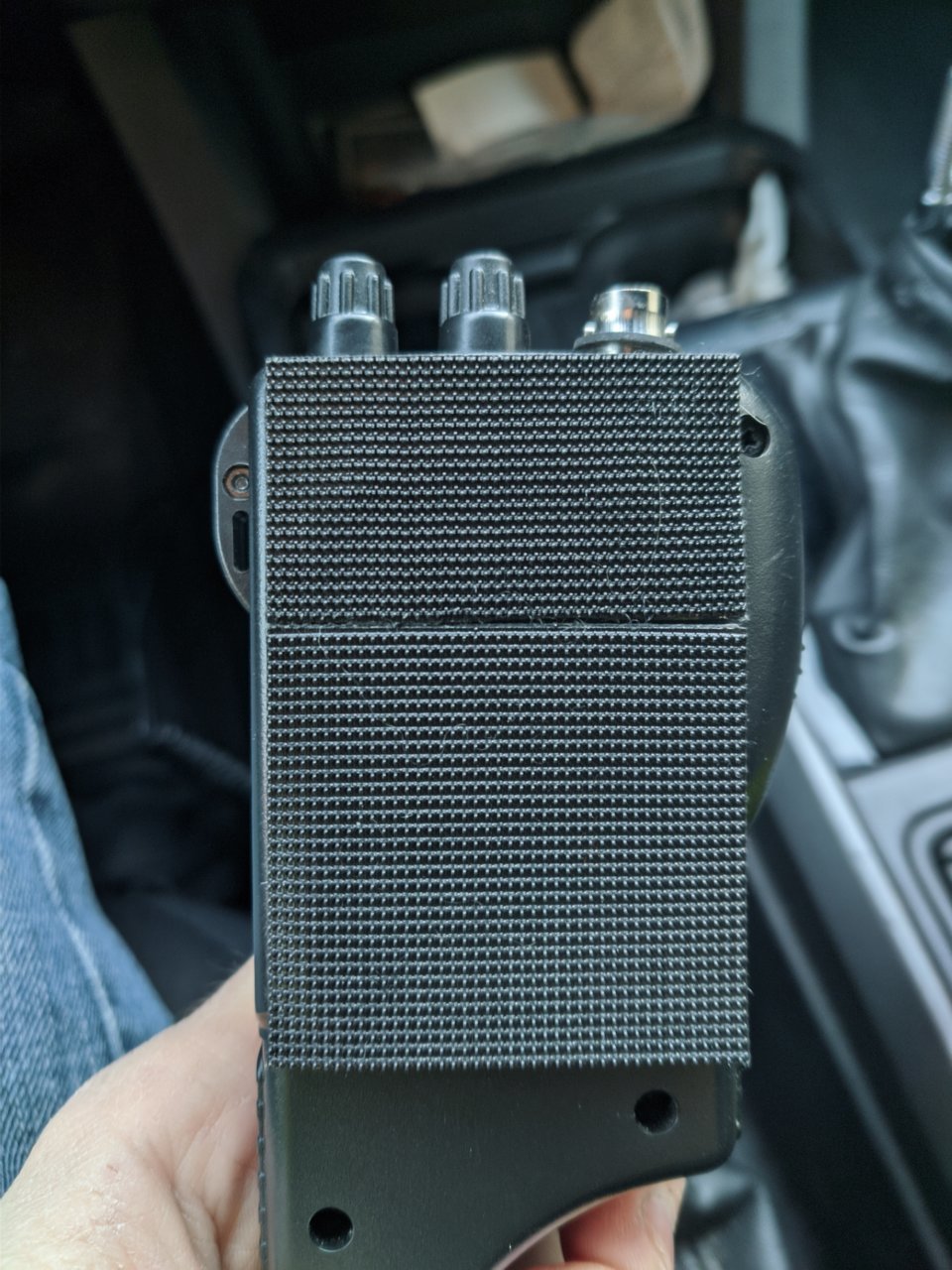

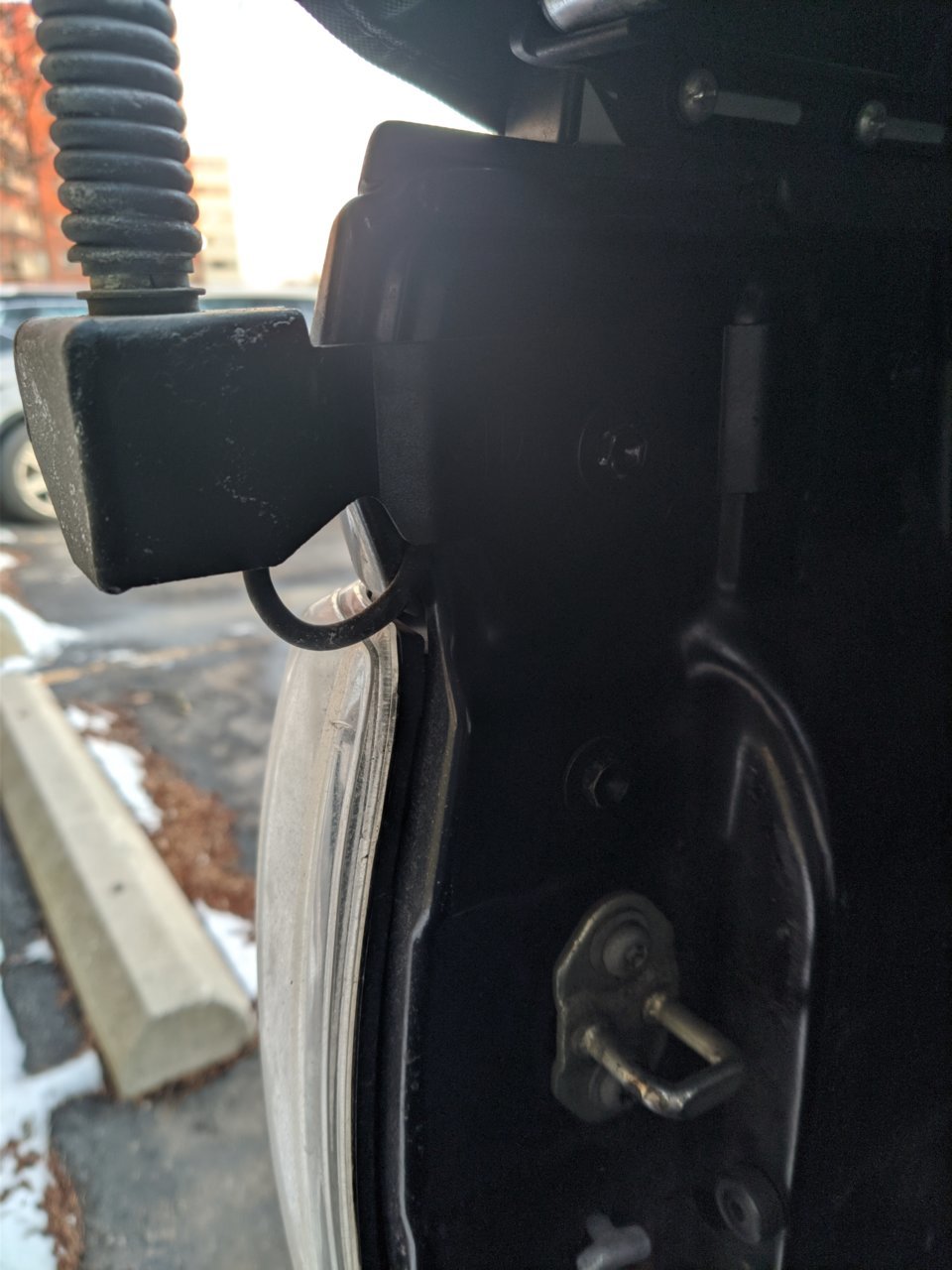

    I don't know if this counts because I don't have a receiver, but I've tried to hide what I do have as best I could.
    I use velcro to store it when not in use
    And under the velcro is a metal plate so I can use a magmount when in use. The mount is more than strong enough.
    Velcro wrap to hold the cord out of the way and everything run into the centre console.
    Caliraised antenna mount with 4' firefly antenna
