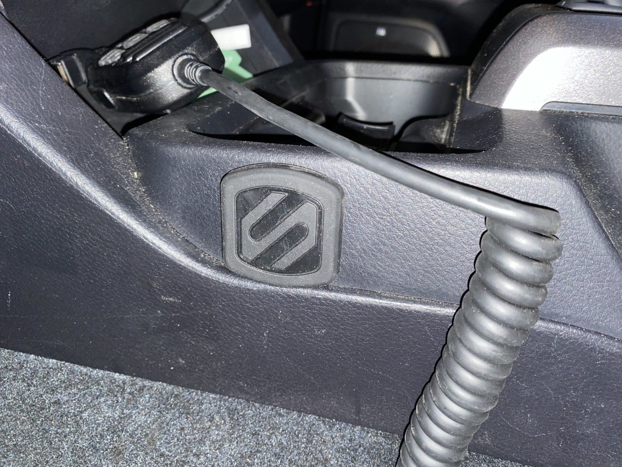

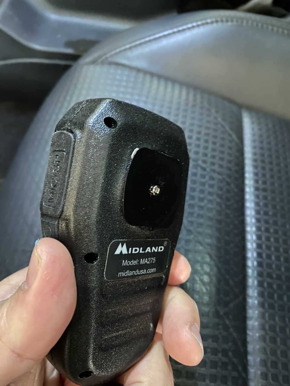

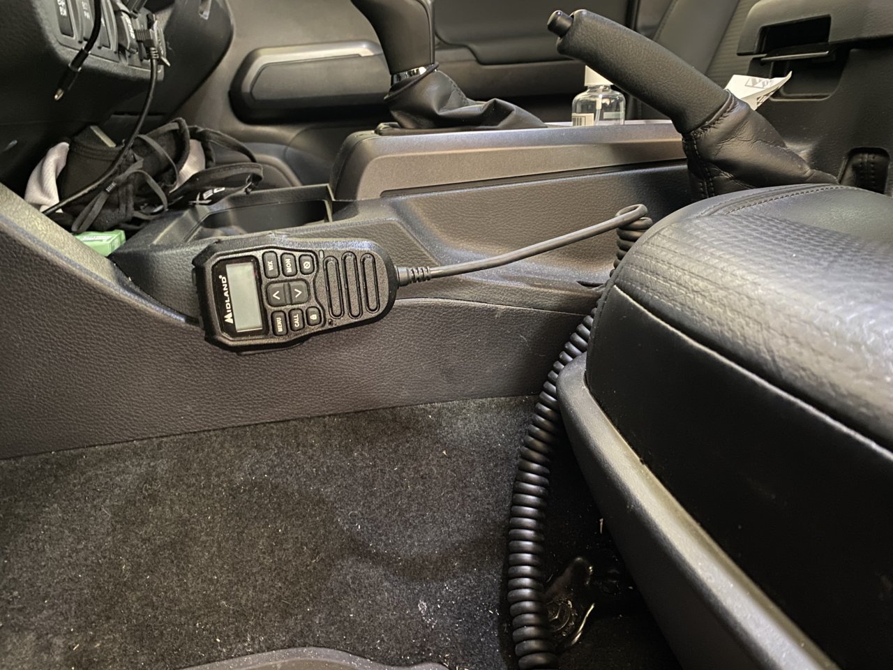

    GMRS but what ever… after looking through every install on this very long thread I decided to go with the simple under seat install. I found the mic hanger that came with it stuck out far and bumped it with my leg a lot. It also didn’t stick well and fell off. So for a while I’ve just set it in the cubby where the wireless charger is.
    I wanted a cleaner place for it so I picked up one of those magnet based phone mounts:
    https://www.amazon.com/dp/B00I608BFW?_encoding=UTF8
    They come with a thin sheet of steel with adhesive backing to stick on phones. I drilled a small hole in it and replaced the radios mic clip
    Then I stuck the magnet on the center console
    now I have a nice place to hang the mic. It’s a lot slimmer than the mic hanger that comes with it, so my leg isn’t anywhere near it now.

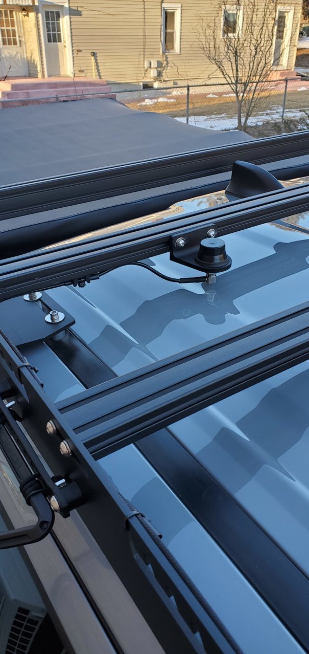

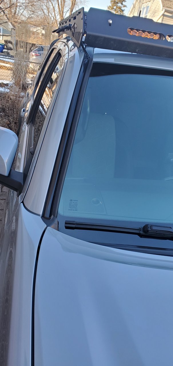

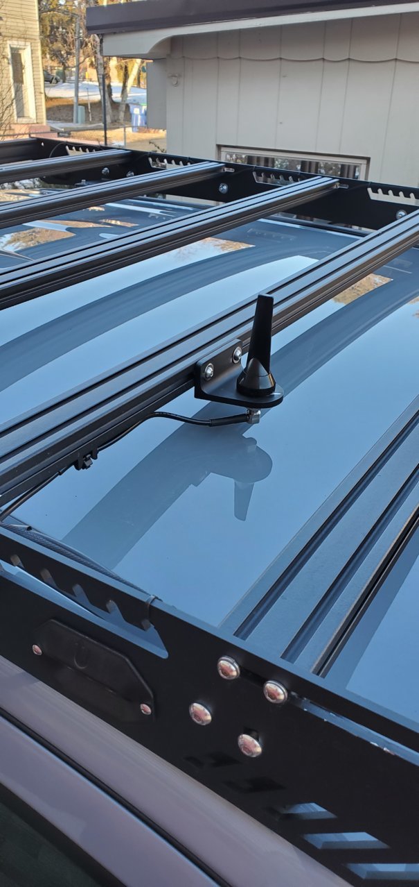

    I used some 1/4 aluminum angle for the NMO mounts. Kept it low enough so with a rain cap it's below the rack cross braces for if I want to haul something up there.
    Ran one cable under the windshield channel and the other in some KC Lights wire hider. https://www.amazon.com/dp/B093HJJ36F
    Front antenna is a Laird ETRAB4503 for GMRS and rear is for CB which I only mount when I need it.
    Sorry pics aren't the greatest....

    Very nice and clean. Thank you for the response!

    Where can I buy that bracket? Looking to mount an antenna on the roof and that is perfect.

    I made the brackets using some 1/4" thick aluminum angle.
