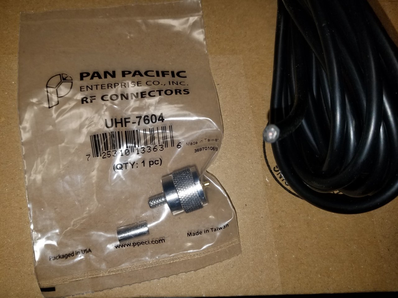

    Looking back on my original post here, for the Victory mount, I chose the:
    $26 Pctel A/S - 3/4" Hole Thick Roof Mount Antenna
    PCTEL
    And purchased a PL259 connector from my local electronics store to go through the firewall :notsure:. I had the same problem ordering the wrong NMO mount, but easily returned to Amazon.
    But, now I'm looking at not installing the Cobra 75, but instead getting a new FM band CB radio, so I might need to consider my mounting options. :confused:

    Does that cable have a stranded or solid center conductor?

    "RG58/U has a solid center conductor of 20 AWG bare copper." :thumbsup:

    Some does, but from what I've seen not all. It seems that the difference between R58/U and R58/AU is that AU is aluminum and U is copper. Most of it these days has braided center conductors. Which at least for me are harder to solder than the solid stuff.

    Confirmed, its solid.
