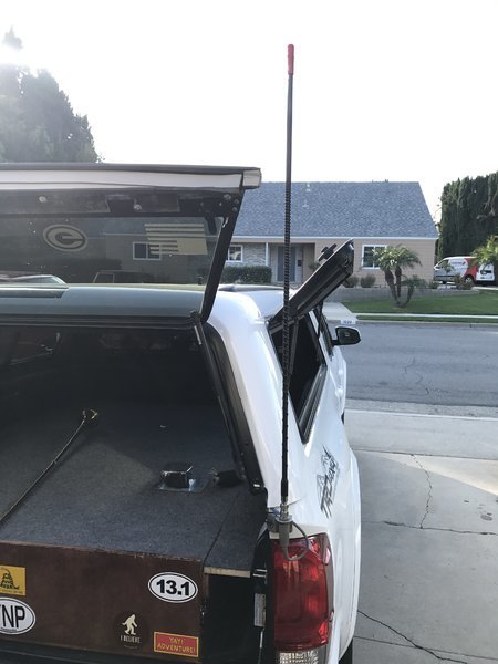

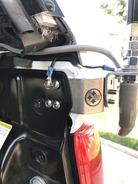

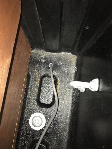

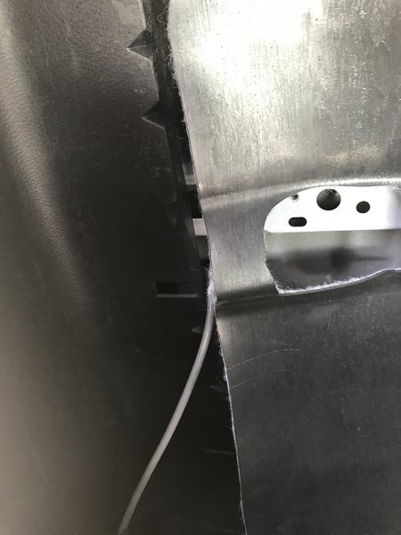

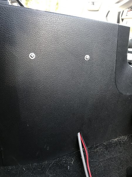

    Finally got around to installing my CB today. Ran the cable from the back, through the drain hole and into the cab behind the plastic storage compartments. It took a while to make it look good but I'm pretty happy with how it turned out

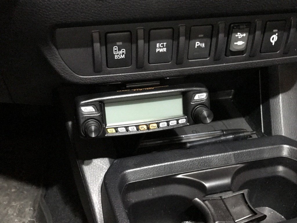

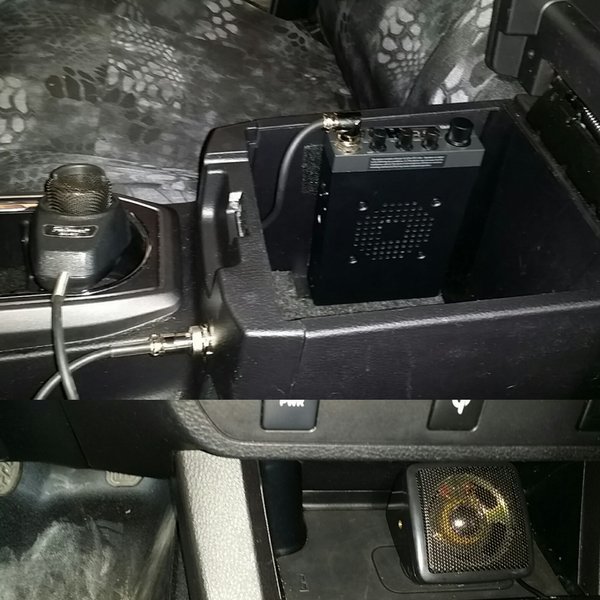

    I just passed my tech exam this weekend and installed this FTM-100.
    6878E6F6-6A09-44E7-8B5A-3F3173465022_zps_cd2416932e4bf7158daf7568cf09334c3ec4b40c.jpg

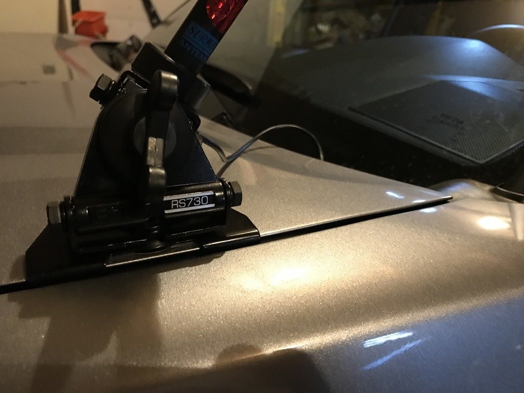

    I went with a Comet RS-730 mount on the hood with a Surmen antenna.
    7AEC021D-A91F-47D8-AA3F-4D70F8A2CB20_zps_5acc8a59bc1ef0ee3dc7592f740f6b19a30197b7.jpg

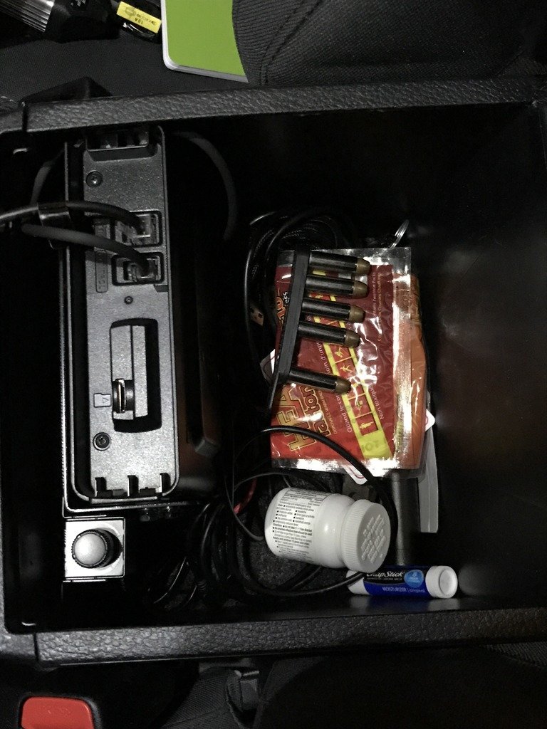

    I mounted the main body in the center console with some heavy duty Velcro.
    E2865373-8252-46C7-ACE8-3268AE55B1D2_zps_40f0af60fade81eb89e211e25d07169ffc1dc945.jpg

    Looks good man. Got any pictures of the truck with the antenna? Where does your mic hide?

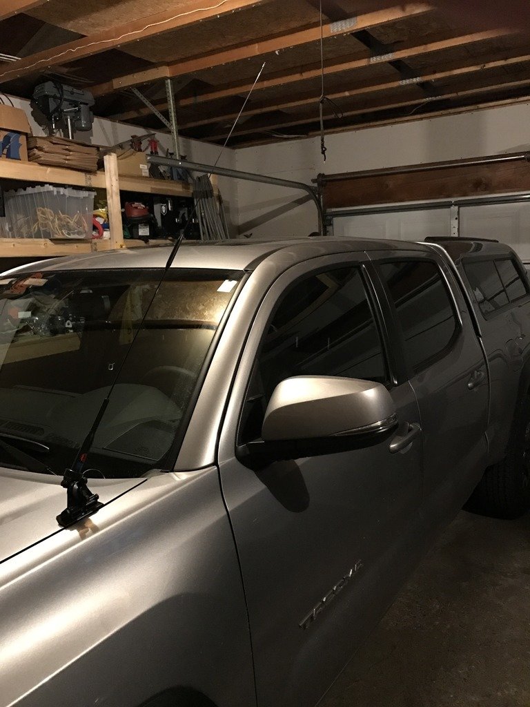

    Thanks!
    Here is a pic of the antenna, I have it angled back to get in and out of the garage without issues. Since I can't TX yet, so I am not sure how it will impact performance. At the moment my mic is in the cup holder, I am planning on running an extension similar to what @GPLarge has.
    Ill try to get a better pic in the sunlight tomorrow.

    Awesome man, looks good! I might mount mine up there once I get my licence squared away.

    Looking good, I'm taking my tech exam next weekend. Not sure what mobile ham rig to install yet, is that face easily detachable?

    The face is easily detachable from both the body and mount. The mount uses double sided tape and the face plate has one screw holding it to the mount. The FTM-100 was recommend to me by the local ham radio supply store, over the 8900 I had originally picked out. I didn't realize that the 8900 only supported 6 and 10m on FM.

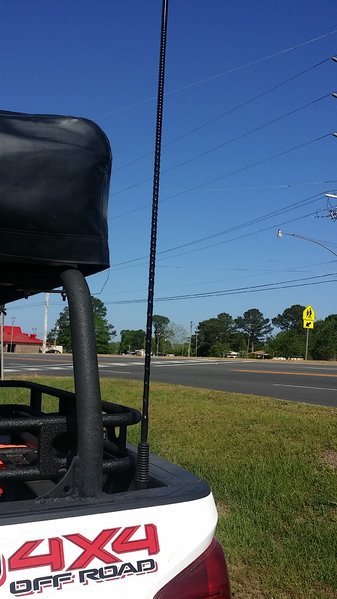

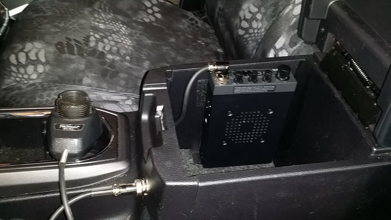

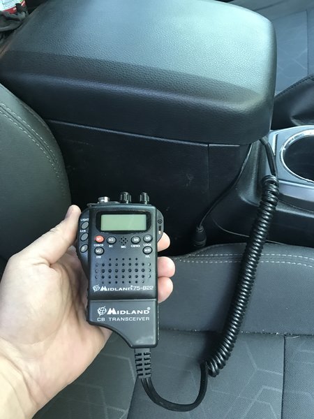

    Over the years and many, many trips I have learned that having a permanently attached communication system is not the best idea. Having a easy to detach CB/HAM comes in handy when you need to get out to help direct people over obstacles or walk out a bit to see the obstacles.
    With that in mind I have chosen this for my CB:
    Midland 75-822 40 Channel CB-Way Radio
    https://www.amazon.com/gp/product/B00000K2YR
    It gives me the option to attach an external antenna as I show in the photo below as well as as battery pack and small antenna if I need to get out the car. Once you use an SWR tuner and set it up properly it works great.
    and for HAM we use the Baofengs with or without external antenna and car charger adapter. and we love them.
