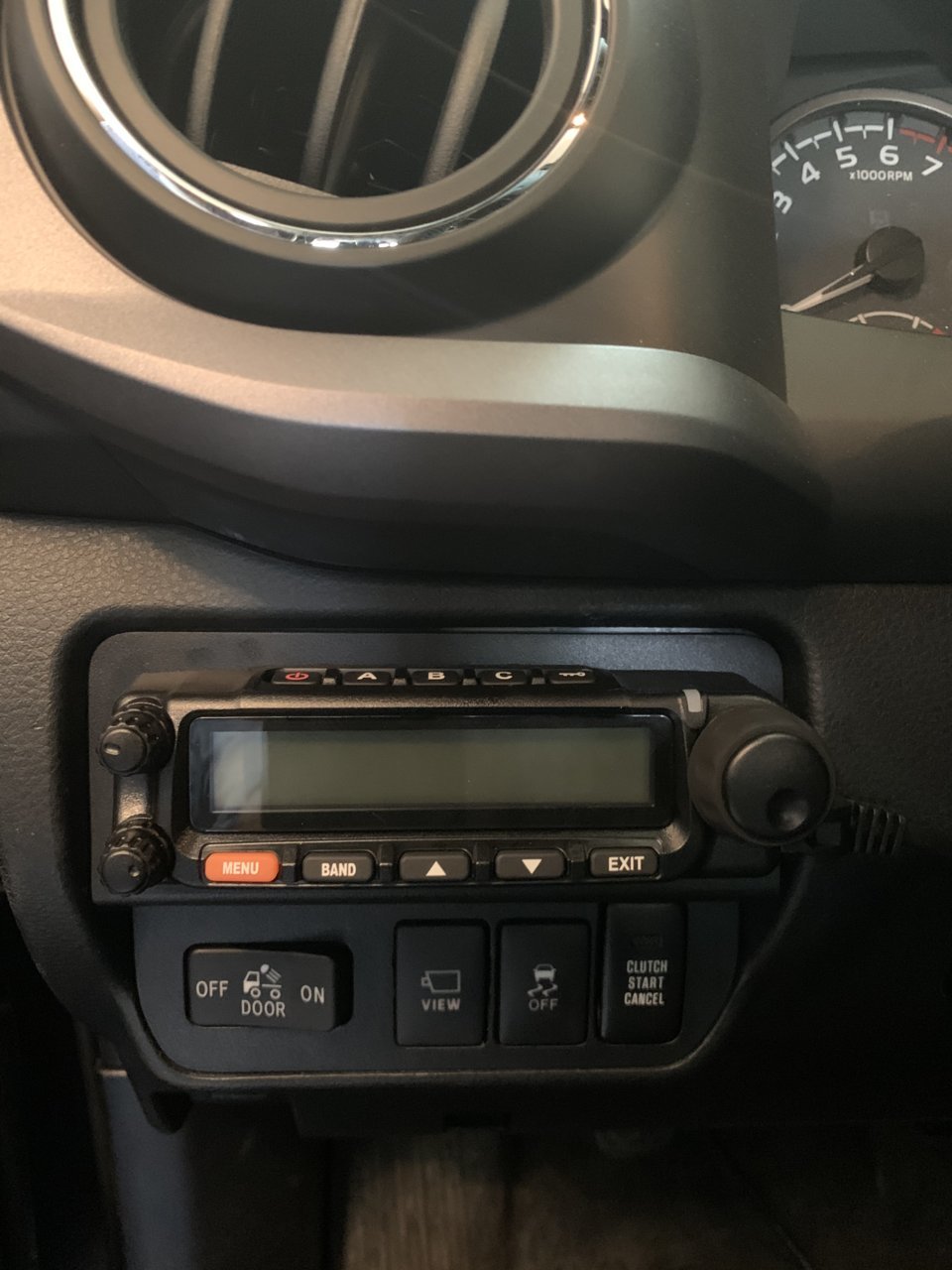

    Ended up getting that Wouxun KG-1000G after all. And, came up with a reasonably decent mounting location, I think.
    It's not 100% in the drivers' line of vision, because of the steering wheel. But, it'll do.
    Required shifting around a couple switches on the side panel, leaving 2 switches that I don't use out of the panel, and dremelling the panel to fit the ethernet-like plug on the back radio's detachable faceplate and to also allow the re-arranged switches to fit in their new slots.
    I took the faceplate back panel off (not the mounting panel, but the panel attached to the faceplate to which the mounting panel normally affixes) and used the removed screws to mount the faceplate to the Tacoma switch panel. The switch panel now serves as the faceplate's back panel.
    Will save the mounting of the radio itself under the seat to a cooler time of the day. Or, better yet, to another day altogether.
    If I end up deciding I want the functionality back of the 2 removed OEM switches (AC power toggle and the not-so-good auto high beam toggle, I suppose getting a pair of those 2-in-1 switch replacements might be an option later on.

  17. Jun 21, 2022 at 3:47 PM
    #2217
    RushT
    RushT Amateur Everythingist
    Dec 10, 2017
    #238171
    5,684
    North Texas
    '18 DCSB TRDOR Inferno
    Purty clean.
