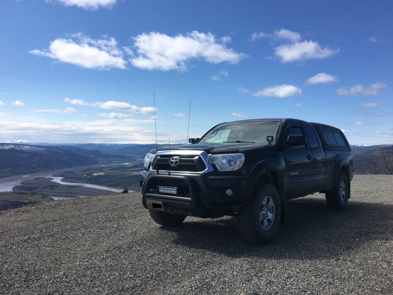

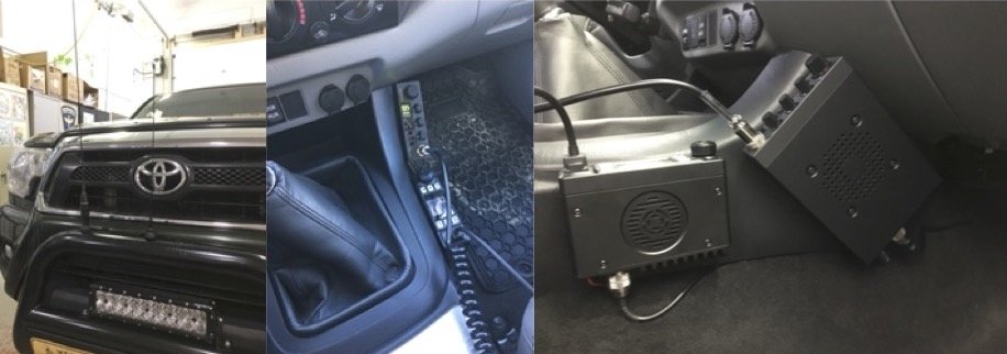

    So I'm totally dead-set against drilling holes into my truck. To each their own, I just like to keep things clean and leave myself the ability to remove something if I'd like.
    I try to workaround everything stock I possibly can. So far, I've been able to get by quite well, with every mod I've done able to be undone (if I wish).
    Which brings me to Radios. I have a VHF and a CB installed in my truck. Two whips, no magnets no holes. How, you ask? Well, this is what I came up with.
    When all's said and done, it works really well for me. I was fine with drilling holes in the aftermarket bumper. I used heavy-grade adhesive velcro patches to mount them. There's space so they can vent, both have an extra in-line fuse, and the adhesive (if removed) comes off the plastic with rubbing alcohol (I tested it). I regularly use both radios, VHF is huge for road safety (animals, weather, breakdowns, fires, etc.) on LADD1 where I live. Final pic is just a front shot. I don't love the stock radio whip, I may switch it for a short one. But I do still actually listen to radio, so I'm undecided at this point.

    I mounted my 2730A body in the same place but I found even the heavy duty velcro would unstick itself in high heat. What I did was take the console apart and used zip ties around the radio and console. They are thin enough to just slide through and around and they hold much better, plus no holes!!

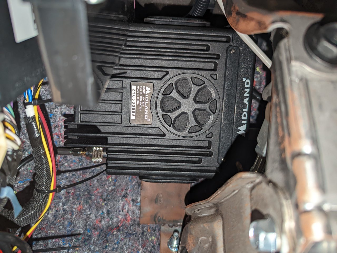

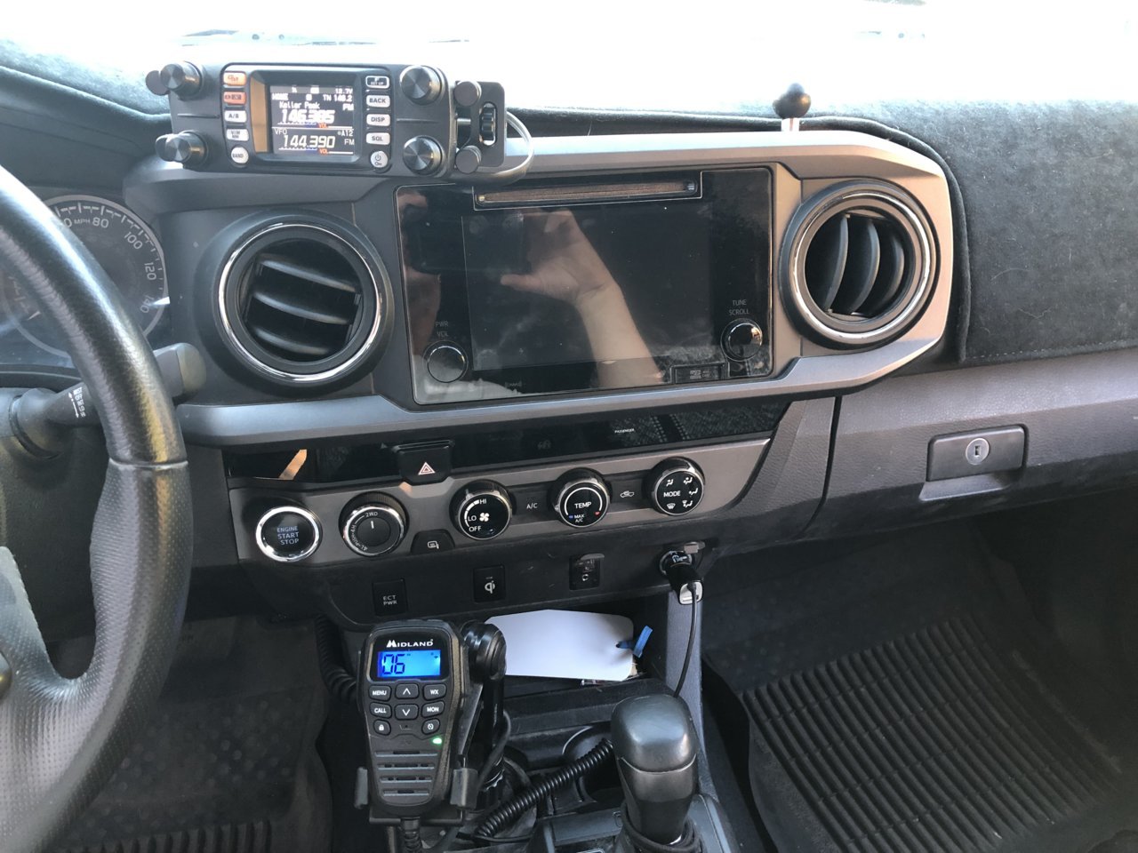

    I just installed a
    $165 Midland MicroMobile 15W GMRS Two-Way Radio with Integrated Control Microphone
    Midland MXT275
    micromobile-

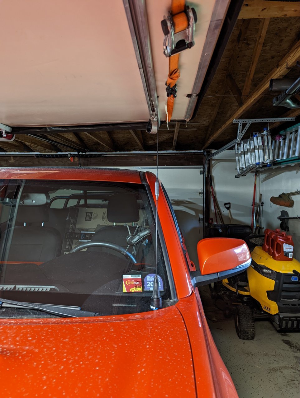

    the main radio body is small enough to fit behind the dash below the head unit and the microphone has all the controls and display on it, and the included mag mount antenna is small enough to put on the cowling between the hood and the fender next to the windshield on the drivers side. It’s a really clean install.
    The unit up top is my Yaesu FTM-300D dual band radio and I keep the radio in my cubby with a accessory tray above it.
