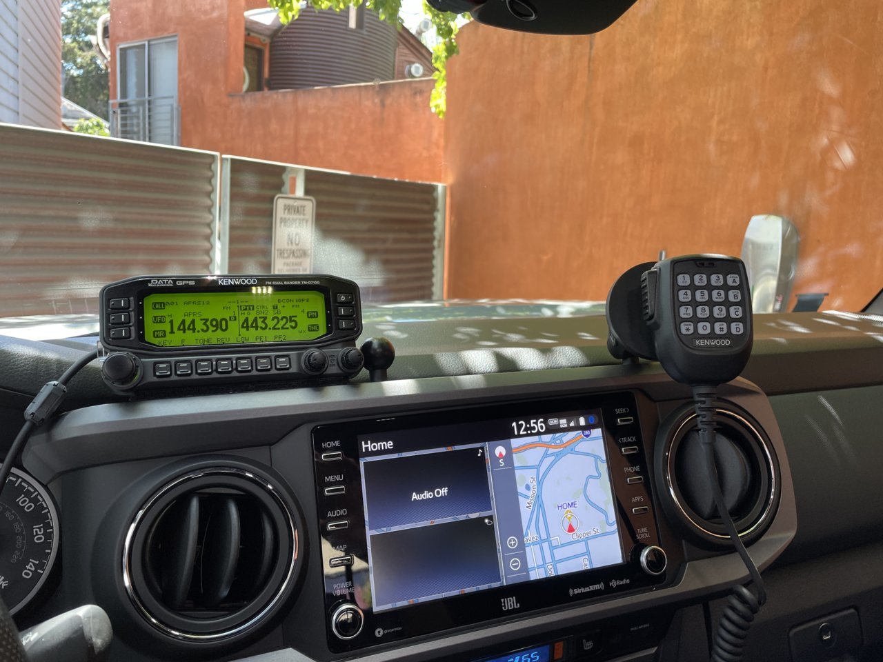

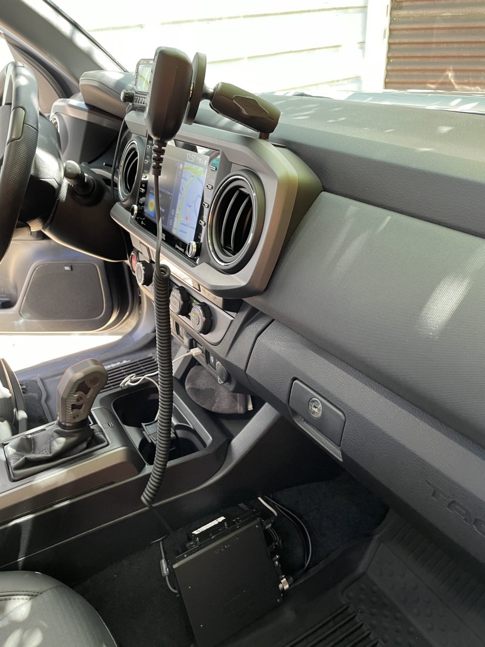

    Started with a DMM ( ). Control head is held on by the miracle that is industrial Velcro. Mic is held by the DMM Mighty Magnet pad accessory (no need for a u-hook, mic mount at the back of it is ferrous). Bonus, I can drop the mic to the center console and slap an old iPad on the mount (with a mag sticker pad on it) running GaiaGPS:

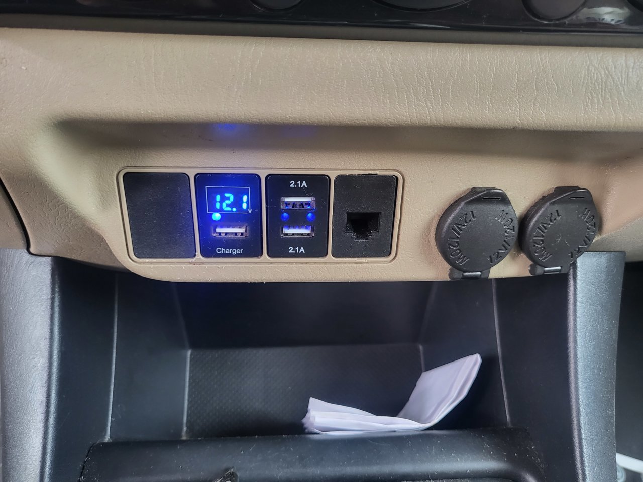

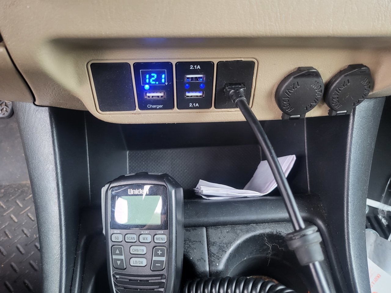

    where did you get that RJ faceplate?
    nvm found link at bottom of page
    thanks

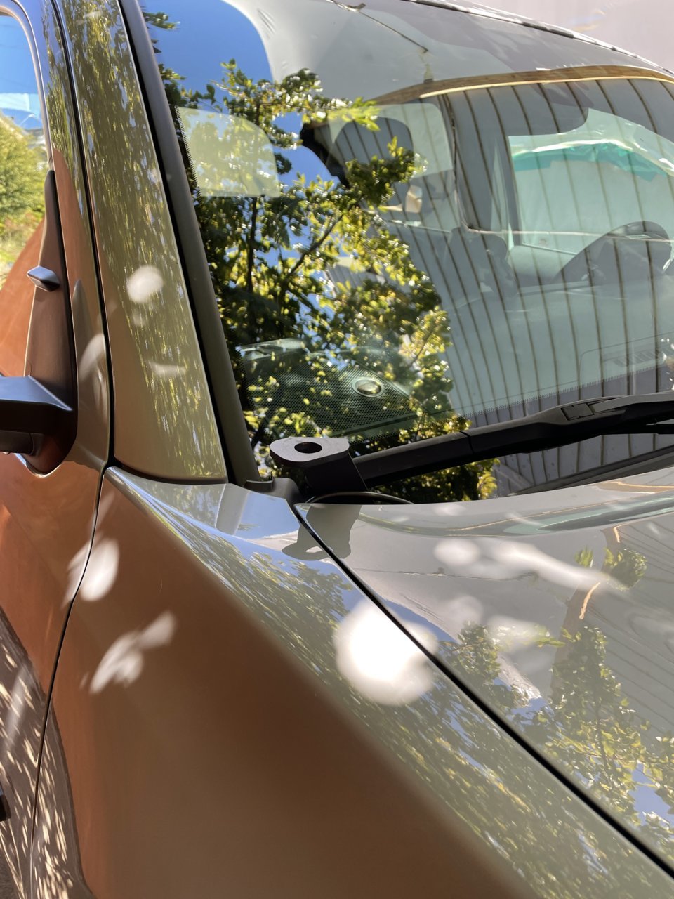

    My apologies for resurrection an old part of this thread, but I'm looking at possibly doing a similar installation for a RF scanner. Does the Victory 4x4 antenna mount obstruct opening/closing your hood?

    The Victory 4x4 works fine when opening/closing the hood. Two notes on that bracket, though, that I mentioned earlier somewhere in this thread: 1) The cable will probably get pinched a bit; there isn't really any clearance between the bracket and the cowl. A better design would have put a couple of bends in the bracket to give it some clearance. 2) Be careful which antenna mount you buy for it. One of the ones they recommend on their site (BMATM3) actually doesn't work.

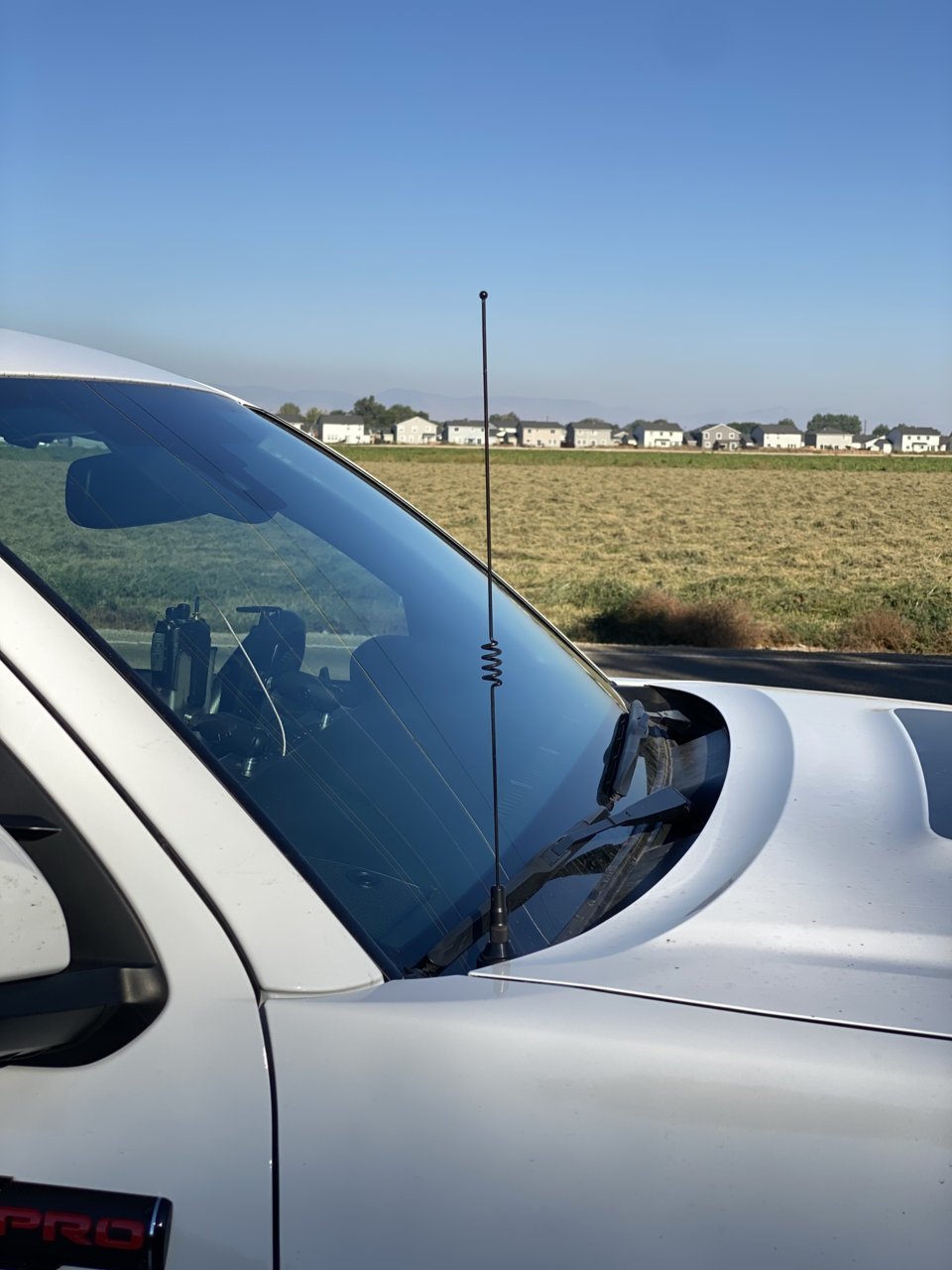

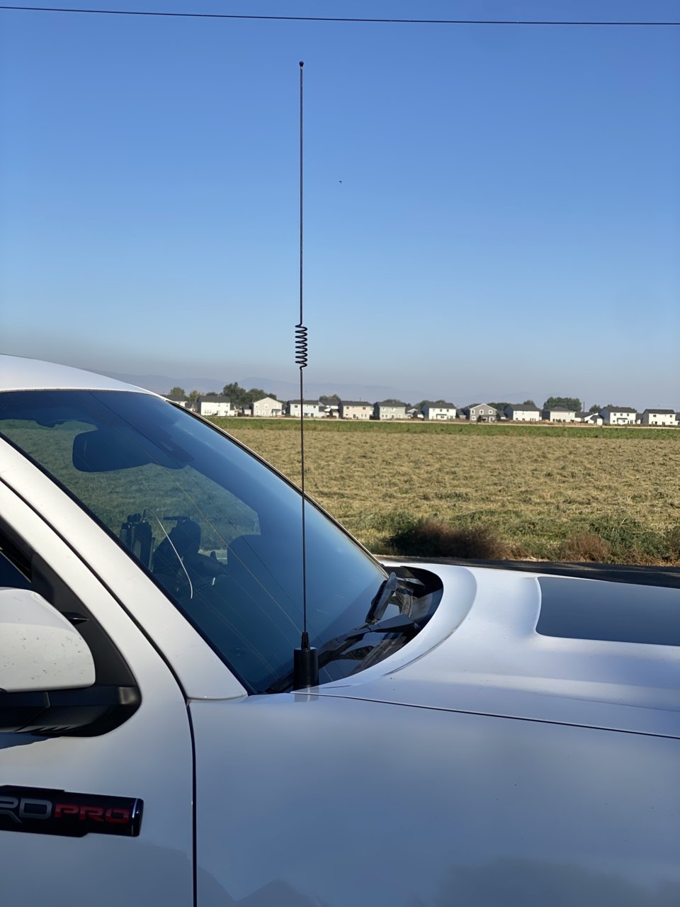

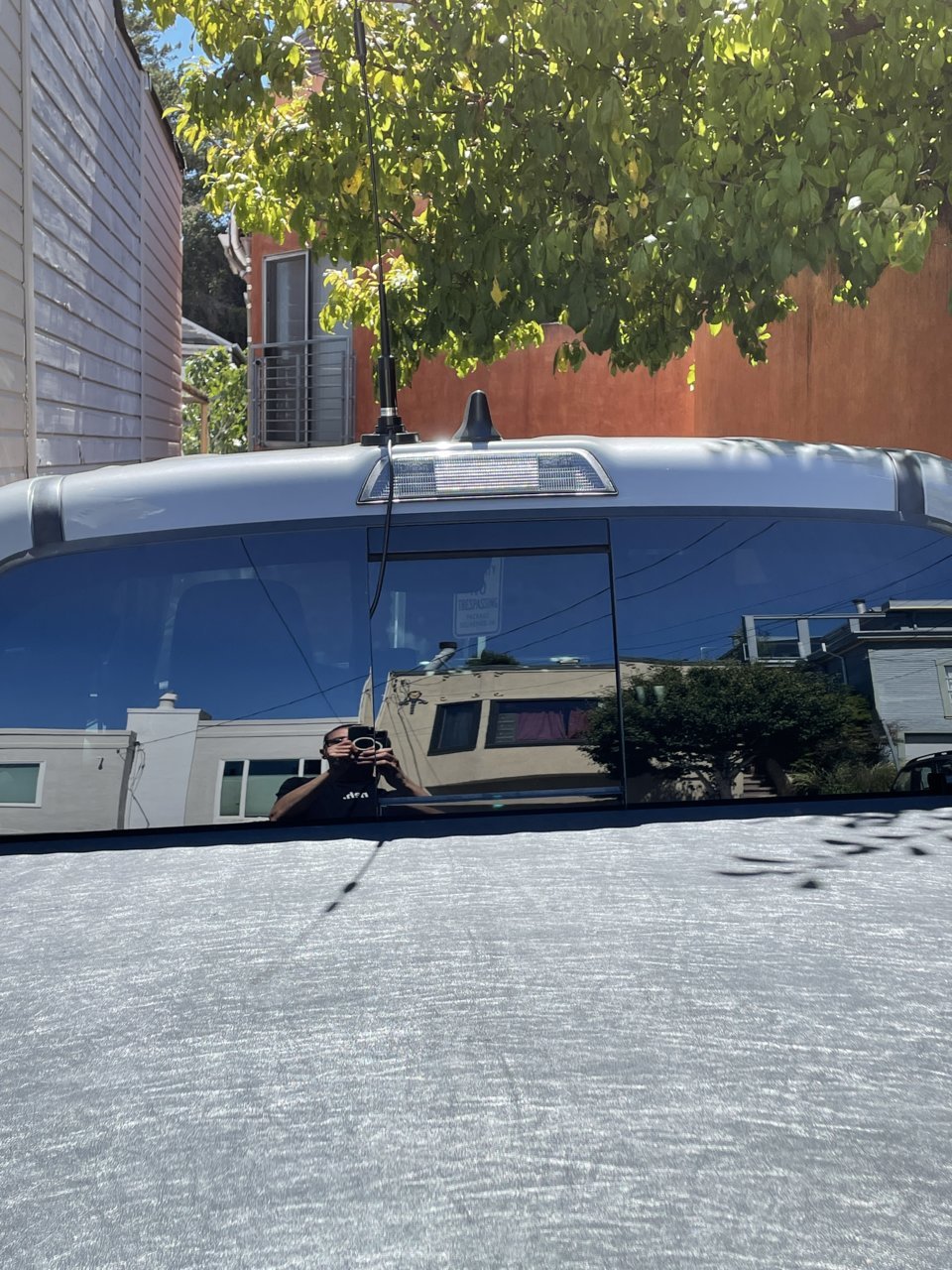

    For those who are interested, here is what antennas look like on the Victory 4x4 hood bracket.
    I used a Laird MABVTO NMO mount from eBay on the Victory bracket.
    I spent a bit of time bending the bracket until the antenna stood vertical. It leans a bit if un-bent. Would be nice if the bracket came pre-bent as this was the most difficult part of the job. The result looks and works well however.
    Tram 1181 2m/70cm ham antenna:
    Larsen NMO2/70B:
    note: the Larsen hears a lot better than the Tram. Where I live the repeaters are close enough so the improvement is not really needed. The Tram looks like an AM/FM antenna and is on most of the time. SWR of both are acceptable out of the box.

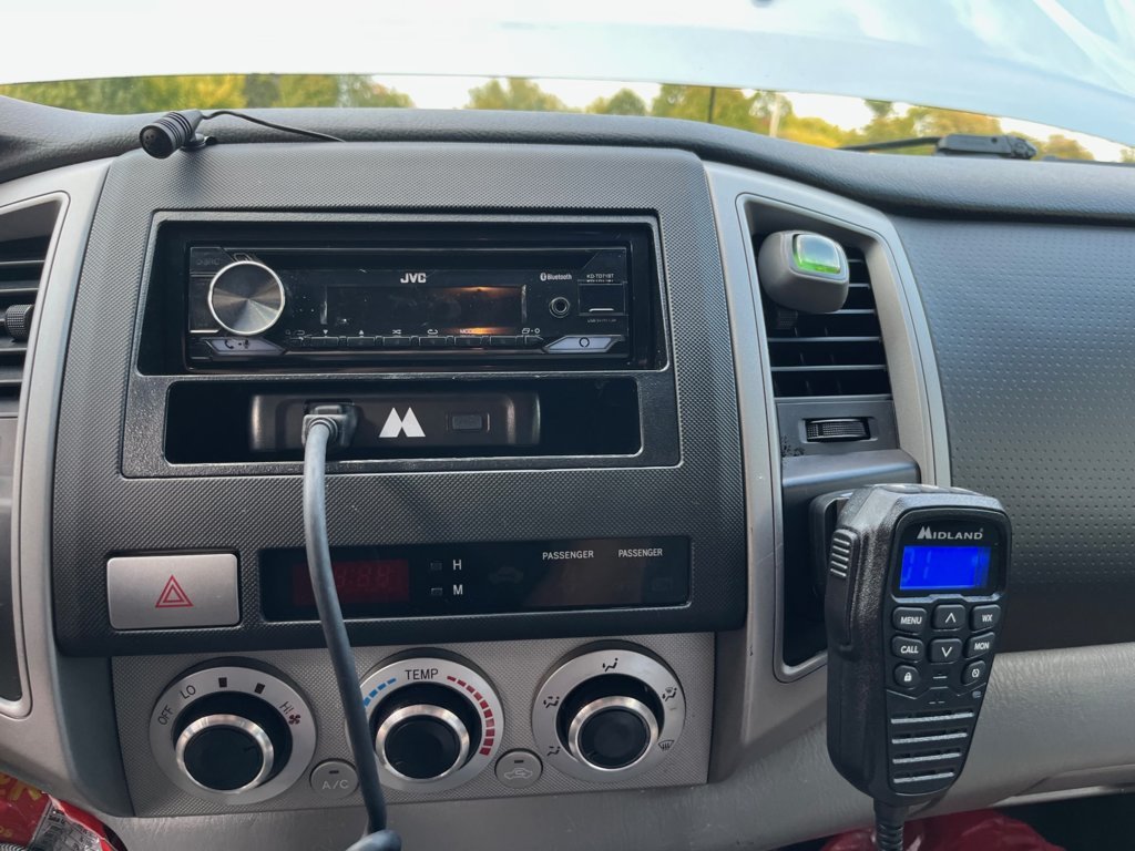

    So far: 2.5" Icon Lift, Steel Front bumper, steel rear bumper, Cali Raised Bed Stiffener, 12Volt.Solutions remote start, Stereo upgrade, A Pillar Ram Mounts, BAMF Behind the grill light mount with Sylania 20" bar; KB Voodoo Max 22" Rack, CVT Awning, Decked drawer system, pod lights
    Midlan mxt275 mounted in the cubby under the stereo in a Crutchfield stereo mount kit.

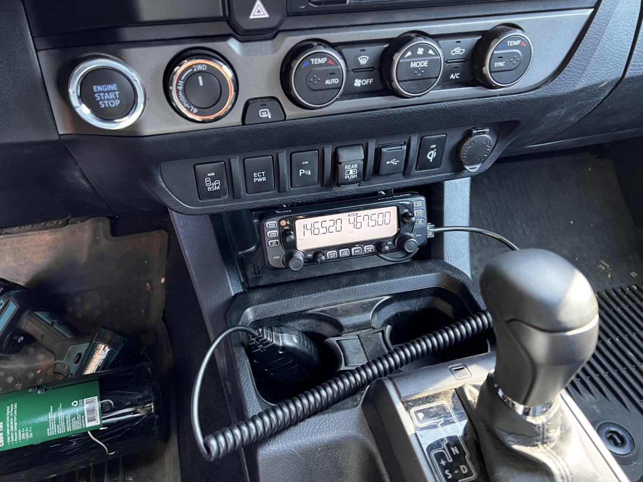

    Icom 2730. This faceplate has a magnetic adapter to be easily removed for theft protection. Main box is under the passenger seat. Brackets are from Home Depot, and I have a small wood backer on the inside of that center switch panel for extra support. Seems pretty solid.

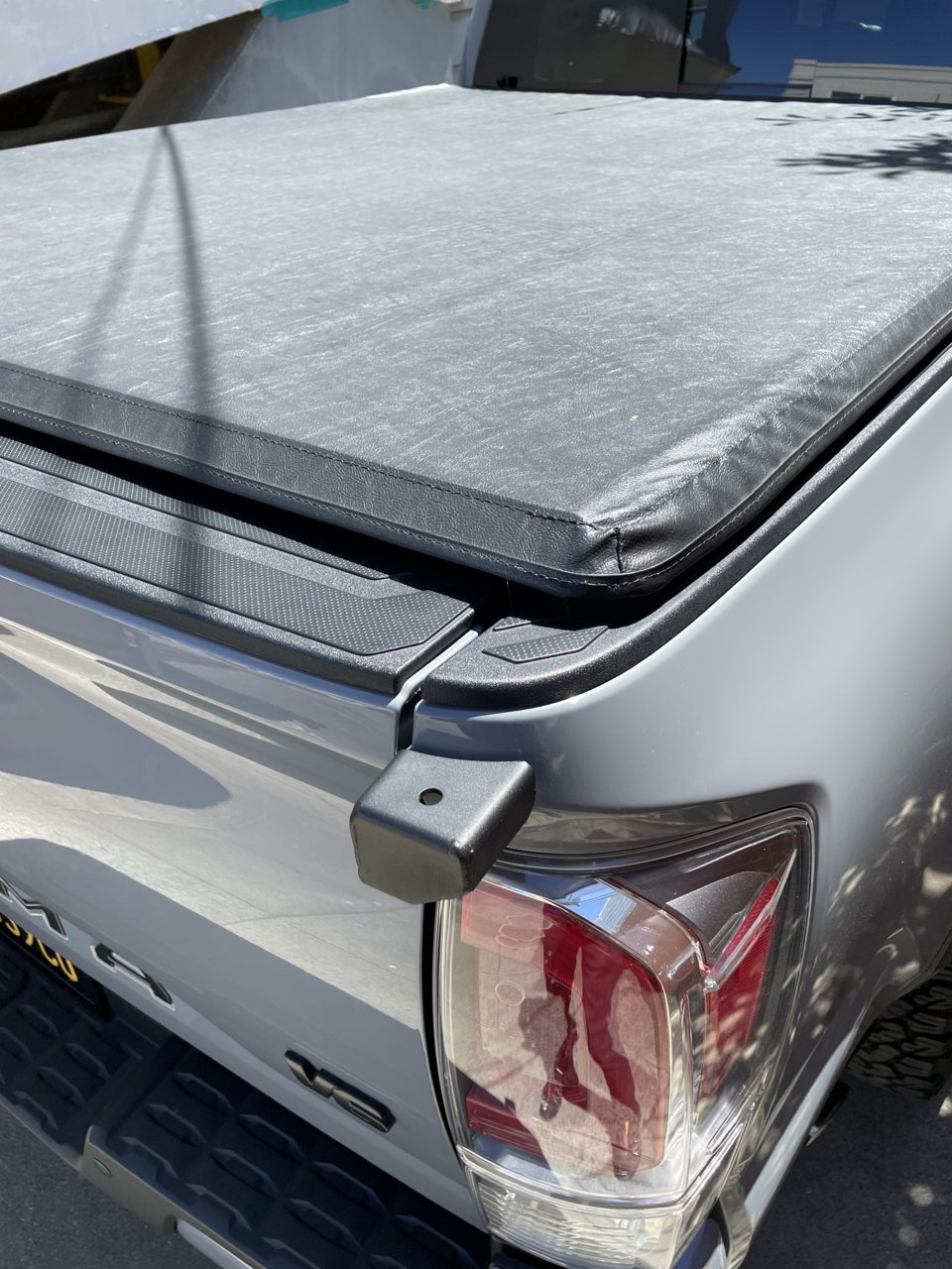

    Radio is an Icom IC-880H, still waiting on parts to finish control head install and not sure where I’m putting the microphone yet, but here are some pictures of the power cabling, antenna mount, and main radio under the seat. I’m pretty happy with it, thanks to all who posted already for the ideas.
    I am curious as I’ve seen some posts here where people appear to have added a nub to the back of an Icom microphone instead of the hook thing they come with, can anyone shed some light on what pieces I need to do that?
