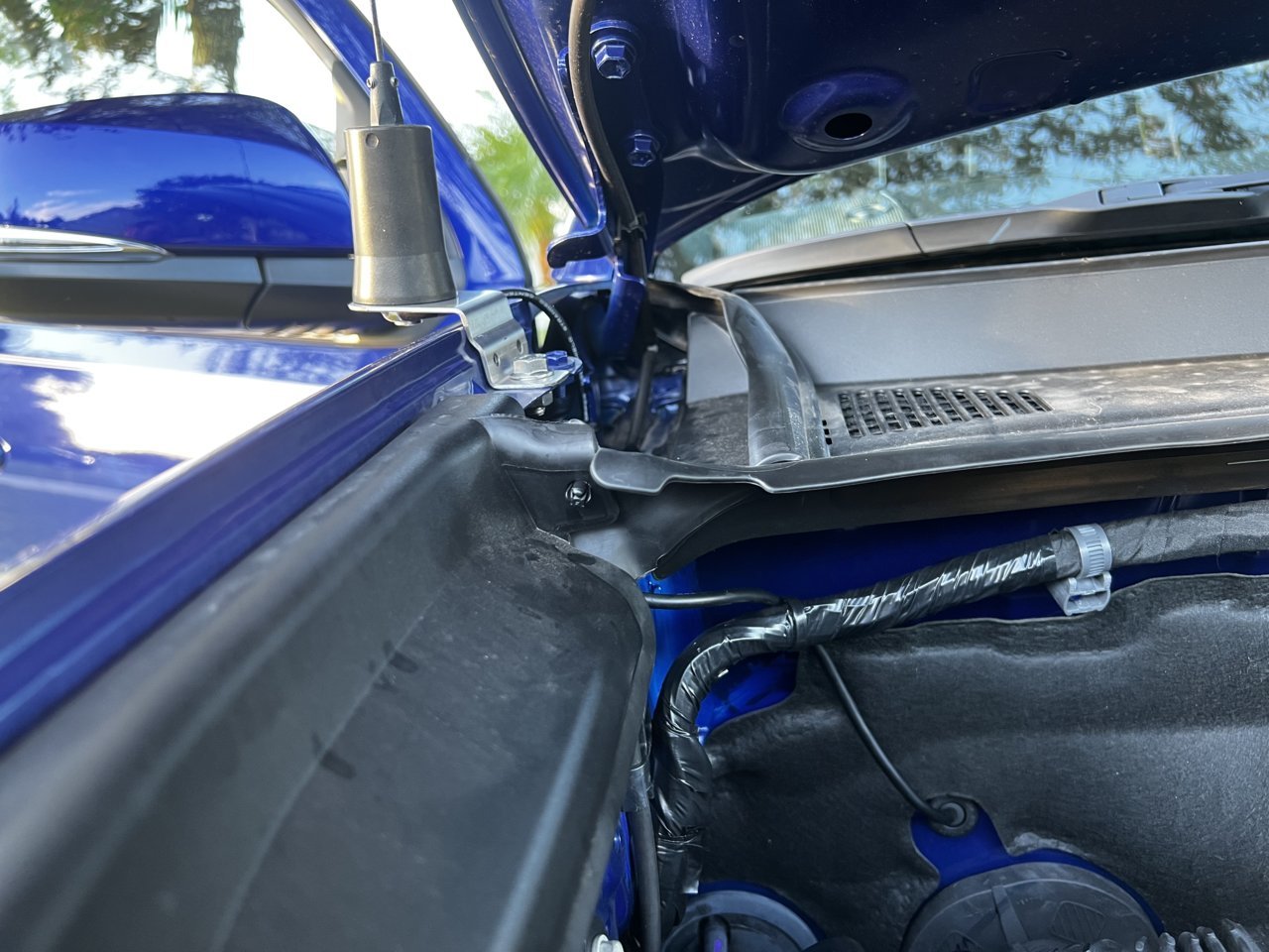

    I forget who pointed out the crimped antenna cable on my original install, but I redid it to avoid crimping.
    Here is the permalink to the post several pages back in this thread.
    Clean VHF/CB radio installs
    Last time I looked it was all fine, but I'll recheck it tomorrow to make sure that it's still fine.

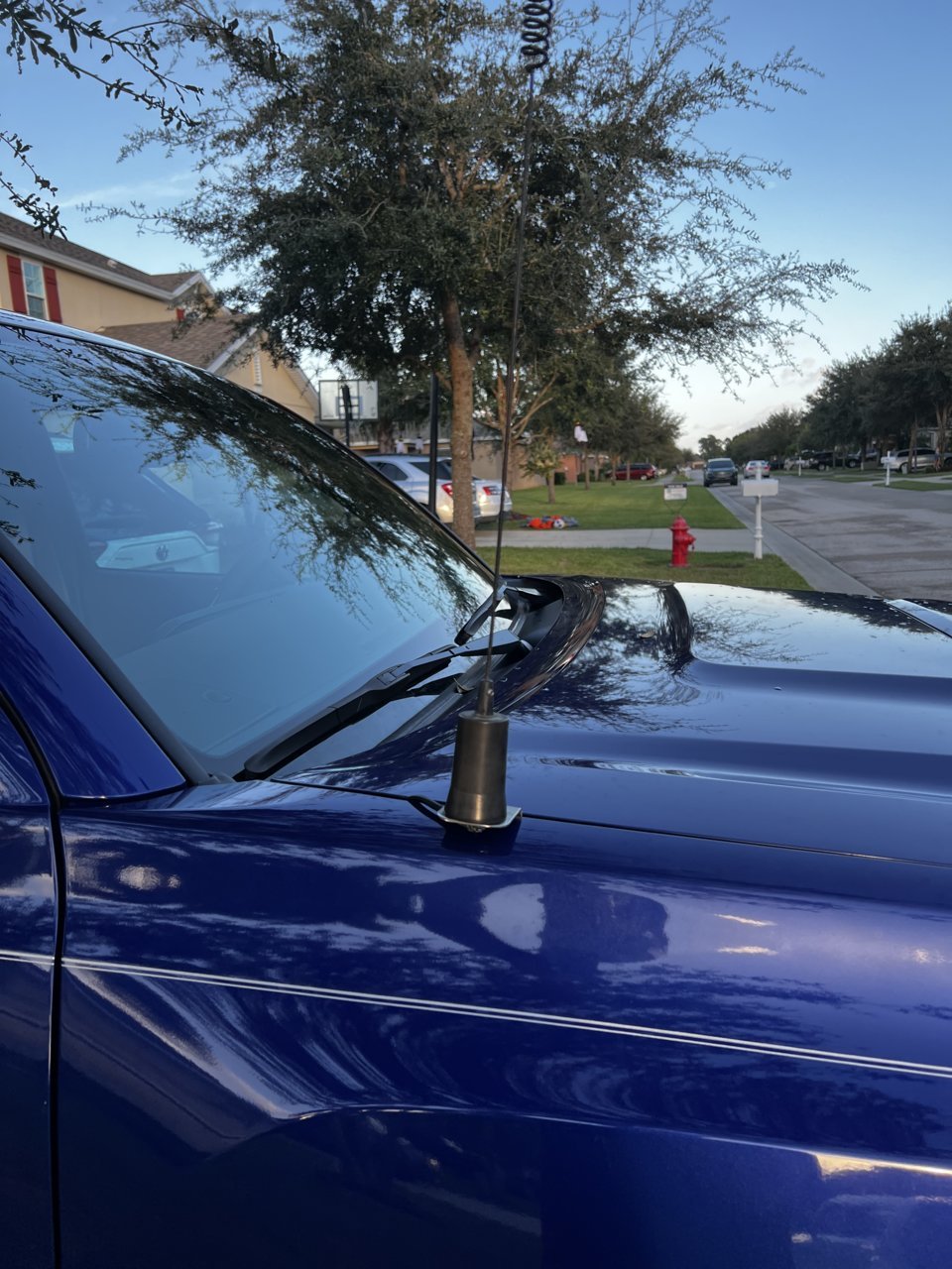

    Do you have a link for that antenna mount?

    I used the one from Valley Enterprises, they are really popular with the hams in my area. I ordered it direct as the Tacoma model was not available on Amazon though there stuff is usually available on there. https://www.valley-ent.com/store/fe...4-inch-nmo-mount-2015-2021-toyota-tacoma.html
    Also I recommend you get the browning NMO cable from them too, it is fully enclosed so it is waterproof on the bottom unlike many others. I ended up cutting off the SO239 connector to get it through the hole in the firewall (drilled the center of the existing grommet for a tight seal) and then soldered a new end on it inside.

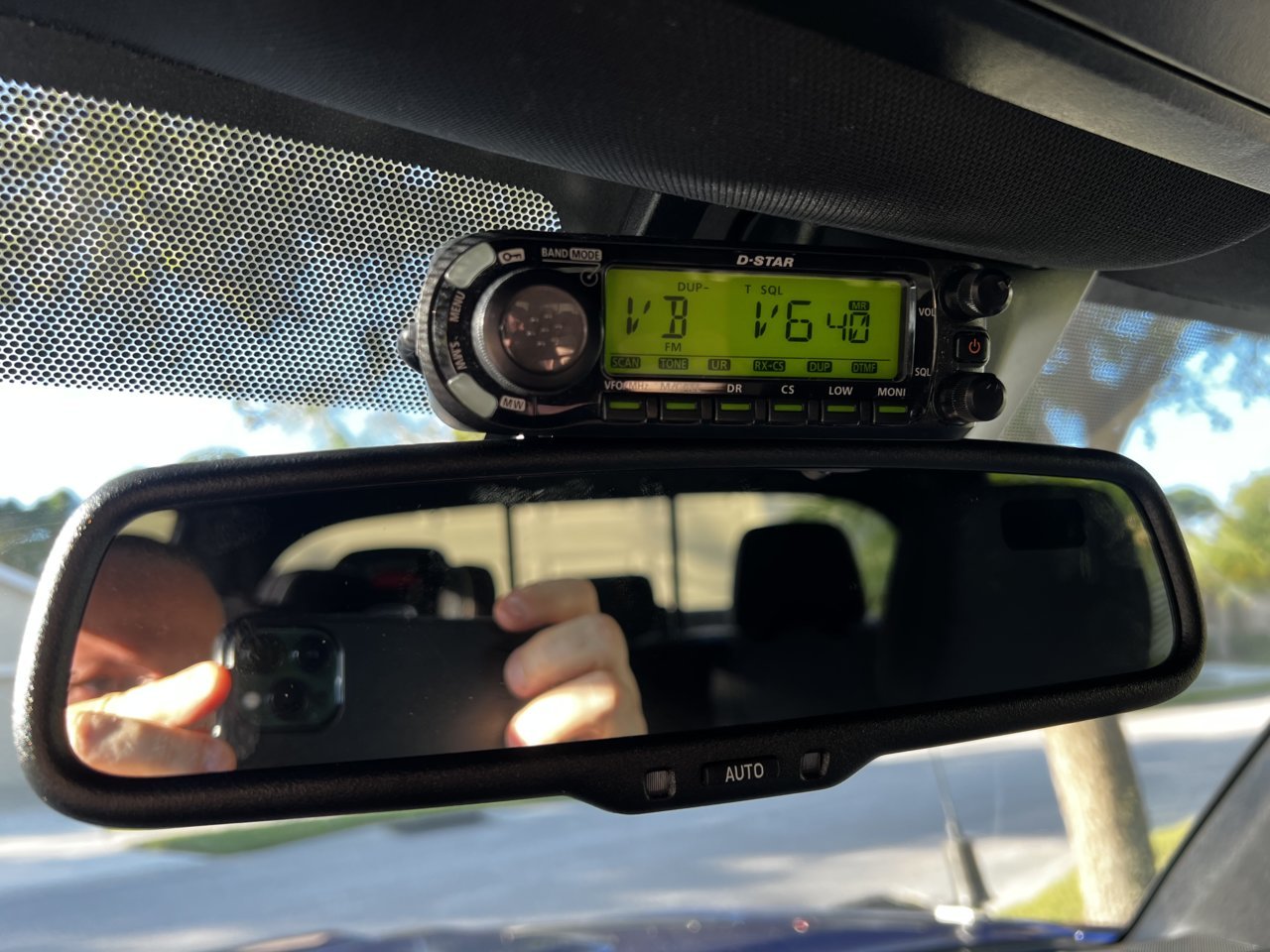

    Ok was able to finish mounting and wiring the head unit last night, wire is all tucked into the headline then down inside the A-pillar and under door sill molding to radio base under passenger seat. I have to say this is one of the cleanest installs I’ve probably done.
    Still want to do something better with the microphone and maybe install a speaker closer to drivers side.

    Nice job! It’s a shame that Icom stopped making the ID-880s and 4100s. The small control head is super for a clean install.

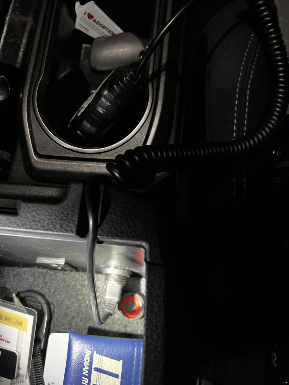

    How is the mic wired up? Interesting spot, I think I would find it a pain to keep reaching up to change freq/channels/etc but if you know your mic controls well enough it shouldn’t matter too much.

    Right now it just comes out between the passenger seat and the center console. I may wire a jack in the center console but Icom mikes have the silly hook to hang and I haven't found out how to convert it to a standard button yet, even though I've seen photos of it done, and I'd like to do that first.

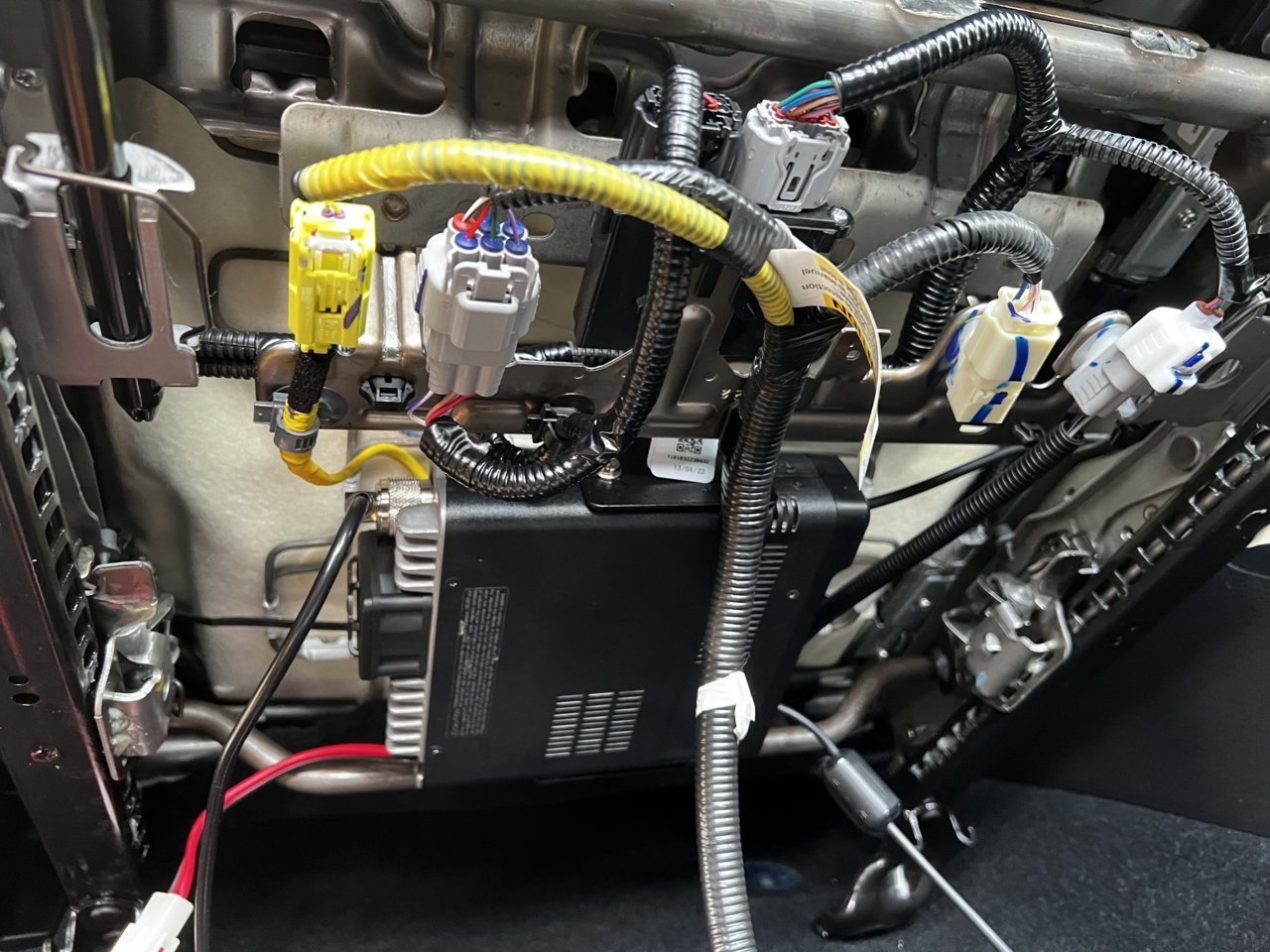

    How did you mount the unit to the bottom of the seat? I've also never removed my seats, anything to know about doing it? Just starting to think about installing a GMRS since most groups wheel with are moving away from CB and going to that.

    I just zip tied it to the bottom, there is a waving spring pattern under the the seat you can see in my photo so with a little planning it's easy to find a way to zip the mounting bracket tight and I've used this same technique for almost 20 years. Just think about seat movement so you have enough extra cable to allow it.
    Seat removal is easy, 2 bolts in front and 2 more in back hold it to the floor (remove plastic covers in back), once unbolted just lean it backwards and adjust the back until it stays leaning, no need to unplug any of the cables. When done just lean it forward, line up holes, and its done.

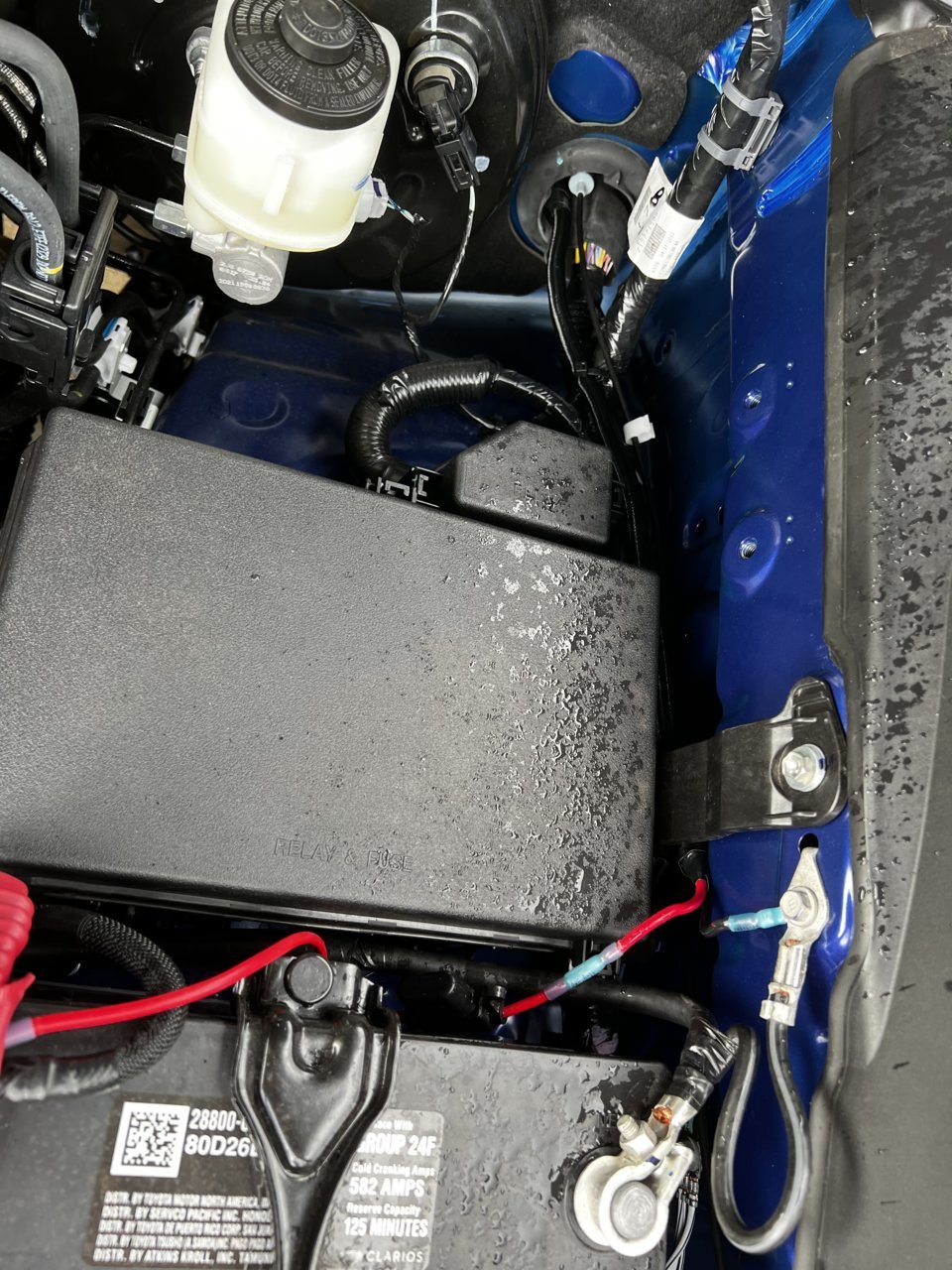

    I don't do this, but it's recommended that you disconnect the negative terminal of the battery. There is an airbag in your seat, and there is a risk it can deploy when you are working near it. Again, I don't do this, but I recognize the gamble, and you should have the info to make your own decision.
    Comm_Guy[QUOTED] likes this.

    I have removed and reinstalled the passenger seat (which also has SOS/airbags) twice (or three times?) now for my sleeping platform. Each time removal and install, I have forgotten to remove the battery lead. It has not popped, etc etc.
    Also, with install, I have NOT had to recalibrate the SOS system. Both times (3? can't remember at this point) the airbag/seatbelt lights have turned off when the truck was started.
    To be fair, I am not saying DO IT THIS WAY - in fact, I recommend DON'T do it like I did.......

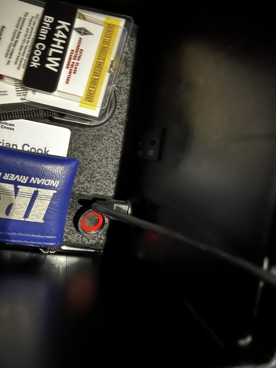

    053F1B96-50DB-4CF2-9289-2DA96235B45C.jpg 592341C7-059E-4E20-AFD6-77463BF5A6FF.jpg So for the microphone jack installed in the center console storage, cable comes up and out the phone charger cable groove. If I did it again I’d put it a half inch higher to clear the first loop of the microphone cable but it still just works.
