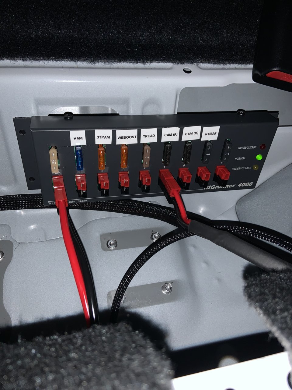

    Power Distribution
    One of the key components to any good radio install is good power--a noisy power source will make for a noisy radio. So, I pulled some 6 AWG zip cord from my battery through the drivers side of the firewall down the transmission tunnel and to the storage compartment under the rear seat. I ran the calculations for the estimated distance and factored in the maximum amperage that the 4008 could handle and came out at 6 AWG. From there, the cable was terminated at the Rigrunner side with Anderson Powerpole connectors and a Blue Sea MRBF Terminal Mount fuse block with the requisite 40 amp fuse; I also keep a few of these in the truck in case of an emergency.

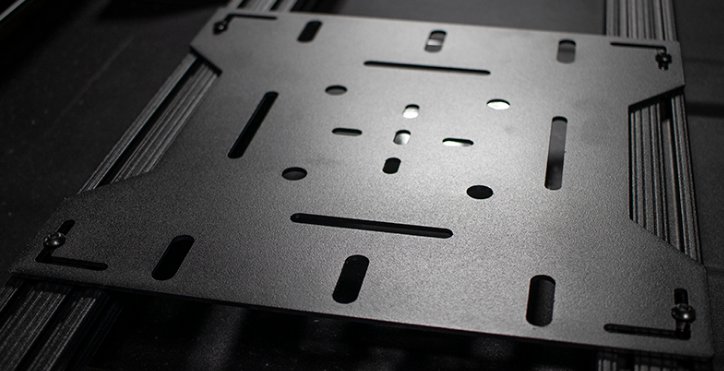

    Expedition Essentials 3TPAM

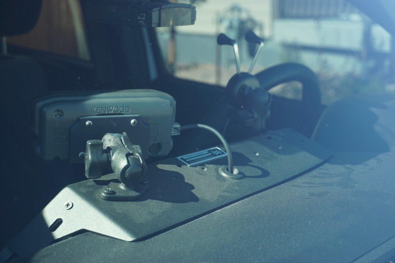

    Once we had power in the vehicle, we could start thinking about the head unit. Because the TMD710GA has a remote-mounted head and mic, this affords us a great amount of flexibility in where it can be placed. I knew that for daily driving, I would want the head unit easily visible and accessible. I also knew that I wanted things to be configurable for the type of situation I was in. As such, the 3TPAM was ordered. This module is known for being able to hold a full-size iPad without issues among other things. Coupled with the 1/4-20 threaded inserts everywhere, the 3TPAM affords an exceptional amount of stability and flexibility; the 5 amp USB-A ports are an added bonus and are wired to the Rigrunner so that they're always on. One downside to the 3TPAM, however, is the lack of a cable pass-through. Nothing a 1/2" Greenlee knockout punch and a grommet can't fix though!
    In order to get the head unit of the D710 on the 3TPAM, I used a diamond ball base mounting bracket from RAM coupled with a short B-size arm and this nifty 3D-printed mounting plate from Ozy at Thingiverse. And, due to the location of the head unit and the transceiver, I ended up using the extension kit from Kenwood.

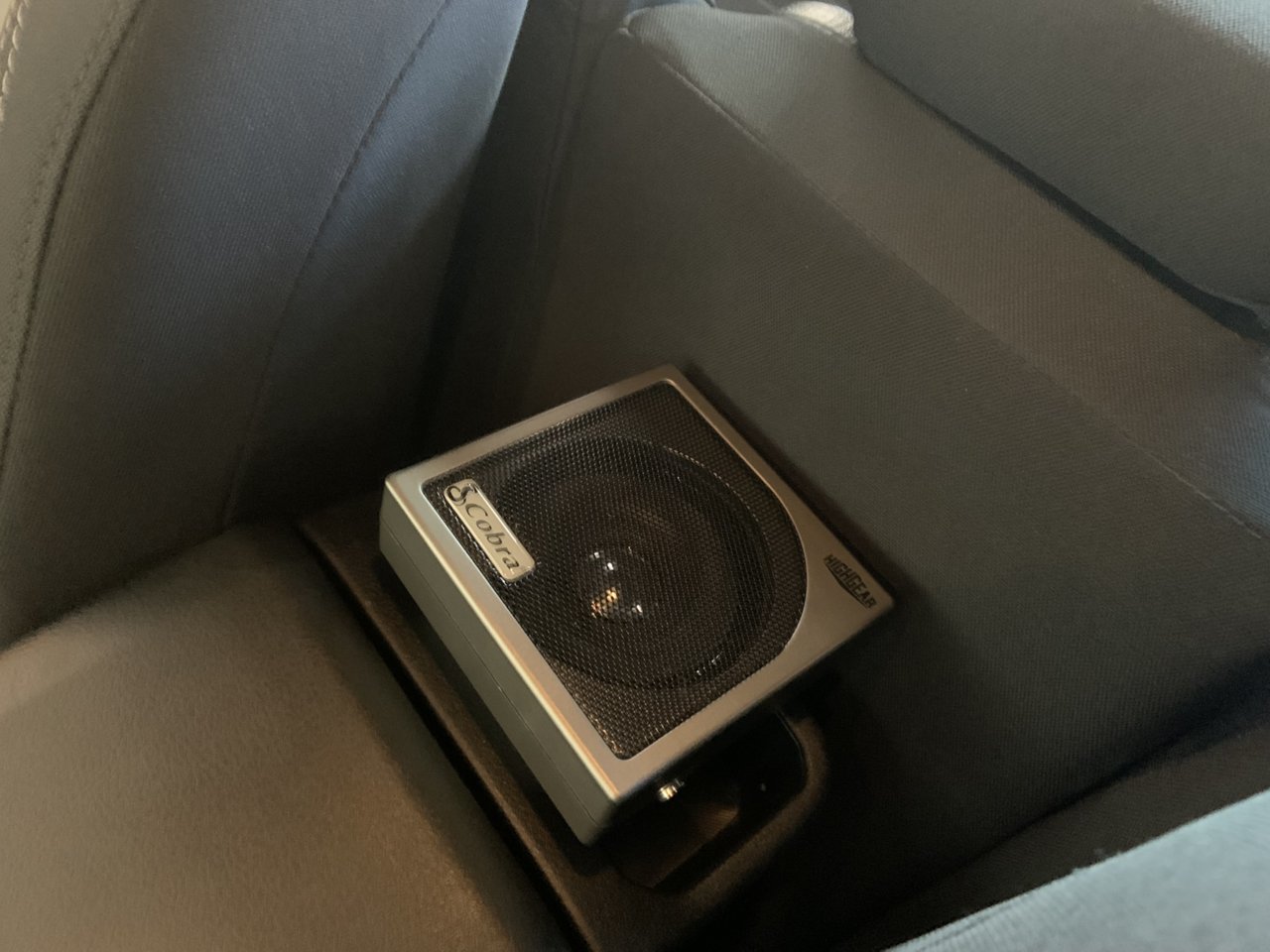

    Audio
    Because the transceiver, and thus the speaker, is mounted in the rear cargo area under what used to be the rear seats, I also had to run an external speaker. I've had great success with a Cobra speaker in the past, so this was a cheap, obvious purchase. This guy is 3M VHB taped to the rear cupholders and the cable is ran through a hole I drilled with a grommet installed.

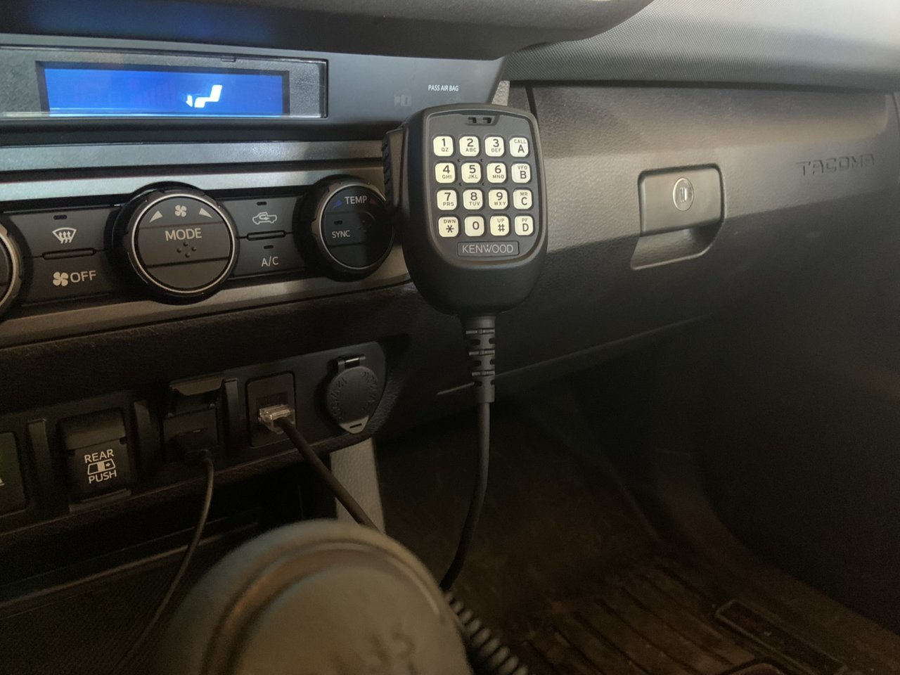

    Microphone
    Before I get into this component, I fully admit I stole this idea from the guys at XOverland; so credit to Clay and Tanner is owed--thanks guys! Again, due to the location of the transceiver, I had to run the mic mount to front dash. Initially, this was done with a switch panel keystone mount from forty2skates on Shapeways. This was a pretty clean install because the mic cable was right where I wanted it. That is, until, I went to install heated seats before winter. Because I have the Tech Package, I had to remove the mount and instead flush mount a keystone holder into the passenger side of the center console. Make no mistake that installing that keystone holder took a good amount of effort because I wanted the hole to be as square and as tight as possible; all-in-all, I think it took about an hour of filing after drilling the initial 1/2" hole. Finally, for the mic holder, I stole the idea of using a Nite-ize Steelie from the guys at XOverland. Clay really nailed this because I no longer have to hunt for a damn clip while I'm driving down the Interstate at 70 mph. Instead, I pull the mic off of the mount, make my transmission, and just put the mic back in the general vicinity of the mount and it just snaps back on; I have yet to have this come loose while off-roading in the Colorado mountains.

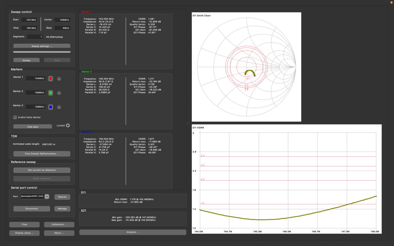

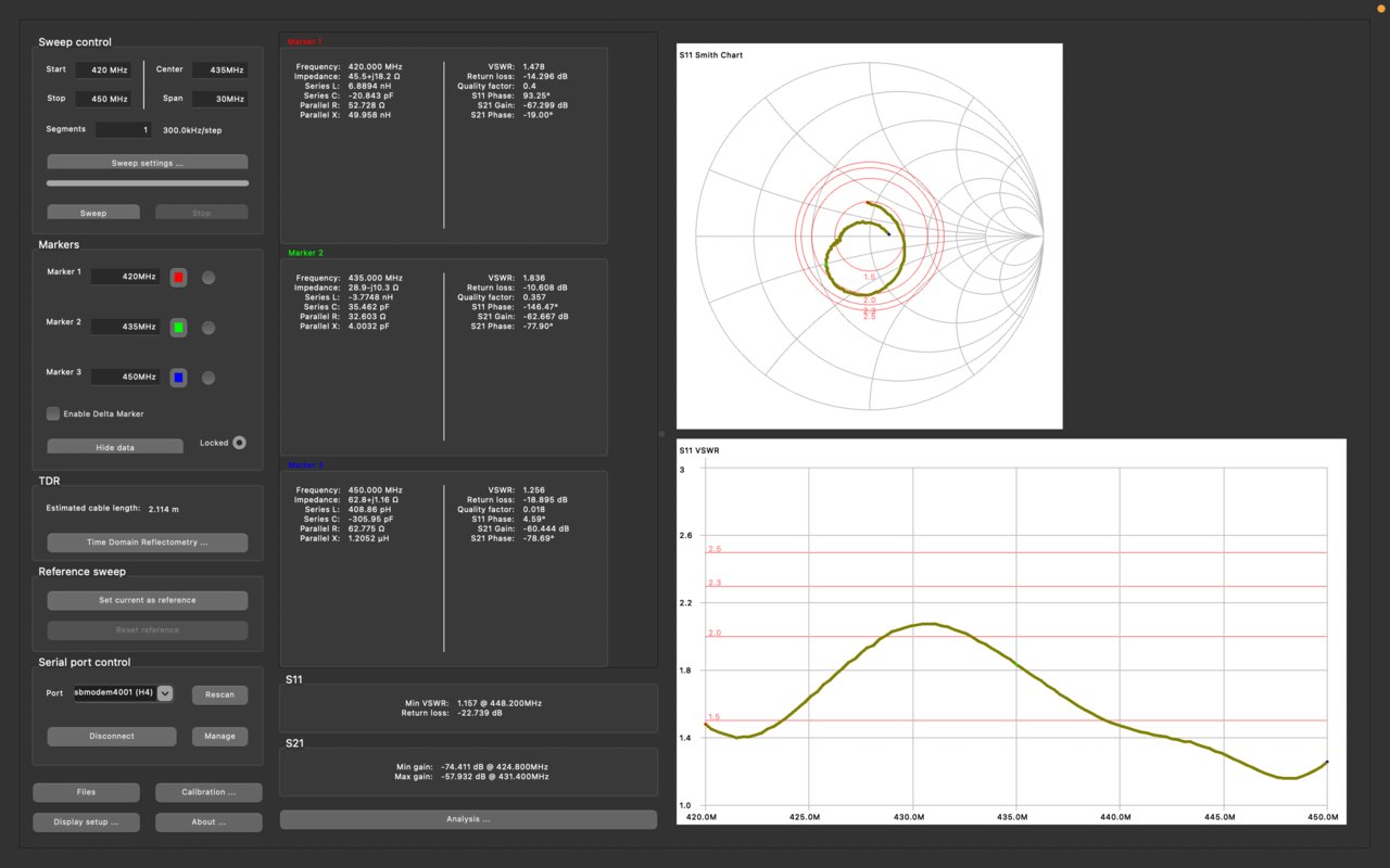

    Antenna
    Admittedly, I took the lazy route here--mainly because I wasn't ready to punch a hole in a truck that had less than 2000 miles on it. But, now that I've gotten past that, I have iteration two on the books--just need to order parts.
    For this component of the install, I used a Victory 4x4 Hood Mount, the aforementioned Larsen NMO 2/70, and the Laird MABTO antenna mount. And honestly, it gets the job done. I get less than 1.5 VSWR on 2m and closer to 2.1 on 70cm. I almost never use the 70cm band, so the high-ish VSWR in that band doesn't concern me. However, I open my hood every night to put the truck on a maintainer. After a while, the connection at the mount comes loose due to the cable flexing. But, this has only occurred twice in the year that I've ran this setup.
    I also run a Diamond NR-72BNMO for in-town operations or when I want to keep a low-profile.
    Larsen 2/70
    Diamond NR-72
    And here is some VNA analysis of the antennas performance in this location.
    The Larsen 2/70
    And the Diamond NR-72

    2025 Tacoma TRD Off Road i-FORCE Max, 2019 Sahara
    So you ran your Ground directly to the battery vice the common ground point on the body?

    In some respects, yes. The RigRunner is directly connected to the battery and transceiver is directly corrected to the RigRunner. The connection between RigRunner and transceiver is about 8 to 10 inches. Also, the RigRunner has capacitors installed on each power output; these capacitors act as noise isolators--just like your battery. Also, by going directly to the battery the circuit starts and stops at the source of energy thus reducing the chances for electrical noise. That and the TM-D710GA manual explicitly states, "[r]oute the DC power cable supplied with the transceiver directly to the vehicle’s battery terminals using the shortest path from the transceiver." While I didn't go directly to the battery, I did put measures in place to eliminate voltage drop and the introduction of electrical noise.
