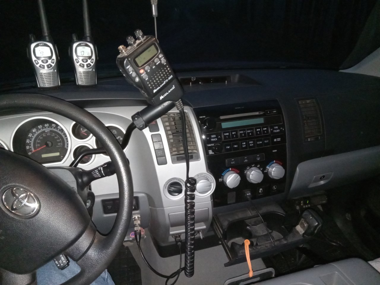

    My work setup in my Tundra.
    Cb- Midland 75-822. Hardwired one OE plug for it to have full time power, used a thru panel coupler for the antenna cable mounted above the brake controller.
    Handheld (s)- Midland GTX1000G
    VHF- Motorola GM300 mounted under the glove box with mic mounted to the side of the cup holder.
    Only thing I don't like is when all 4 are going at the same time. Easiest setup for the CB I've ever dealt with. If not wiring for full time power, only thing you have to add is the antenna cable and a way to attach it.

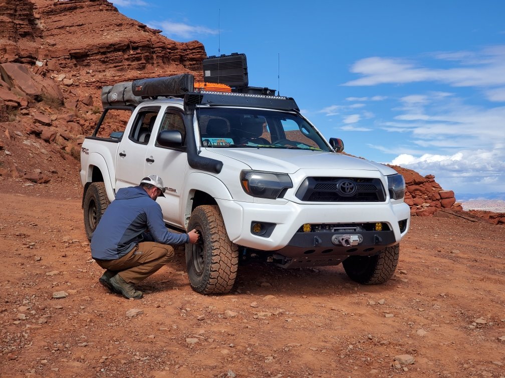

    Is there any good ham NMO radio mount that you can also install a ditch light to? That acts like a dual purpose mount.
    Also, would there be any issues to install the ham antenna next to the radio antenna? The 2nd gen has a physical radio antenna on the passenger side. I rather keep all the antennas on that side for a cleaner look. Any issues doing that?

  9. Jan 12, 2023 at 8:56 AM
    #2329
    Comm_Guy
    Comm_Guy Well-Known Member
    Oct 24, 2022
    #408791
    102
    Brian
    Vero Beach, FL, USA
    ‘22 Tacoma TRD Sport DCSB
    All about making it more useful, Bed Lights, Power Tailgate Lock, Flat Aluminum Tailgate Cover, Leer Topper with added lighting, Ham Radio, 12V Outlets in bed, 400W Anytime Outlet, Meso Customs Stealth Shifter Knob & Dual Color Cab lights, and bed mounting and organizations.
    An antenna should be mounted at least 1/4 wavelength away from other antenna, for VHF that's about 1'10", for CB its 9'2". (These are rounded up to nearest inch.)
    If you don't use your radio ditch the antenna or go to a hidden one of some type,.
    GarlicFarts and vicali like this.

    Too close for both those antennas to work without interfering with each other. Also watch for cheap LED with noisy RF mounted on there.
    I just added the NMO plate to my driver side ditch mount. Read up on RF dangers and understand the risk to having the antenna right beside you as well.

    The ham antenna being on the other side from the am/fm would add some symmetry and avoid interference.
    I can attest that Baja Designs S1s have not caused RFI issues with my dual band setup. Ultimately ended up moving the antenna up over the driver's head for better transmission success in hilly/rolling dunes areas.

  16. Jan 12, 2023 at 1:15 PM
    #2336
    4wdExplorer
    4wdExplorer Well-Known Member
    Dec 31, 2009
    #28499
    1,079
    Orange County, CA
    Thanks, thinking of mounting my Comet shorty attenna to my roof rack now. Any RFI or SWR issues with ths?

  17. Jan 12, 2023 at 1:18 PM
    #2337
    Gunshot-6A
    Gunshot-6A Prime Beef
    Dec 29, 2009
    #28389
    23,624
    Conner
    Everett, WA
    '15 TRDOR / '17 Africa Twin
    No issues for me, even when the S8 light bar is on in close proximity. Dual band top dead center, and sidekick APRS running on the shorty.
