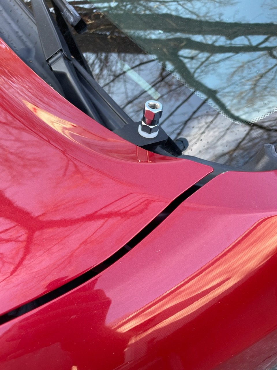

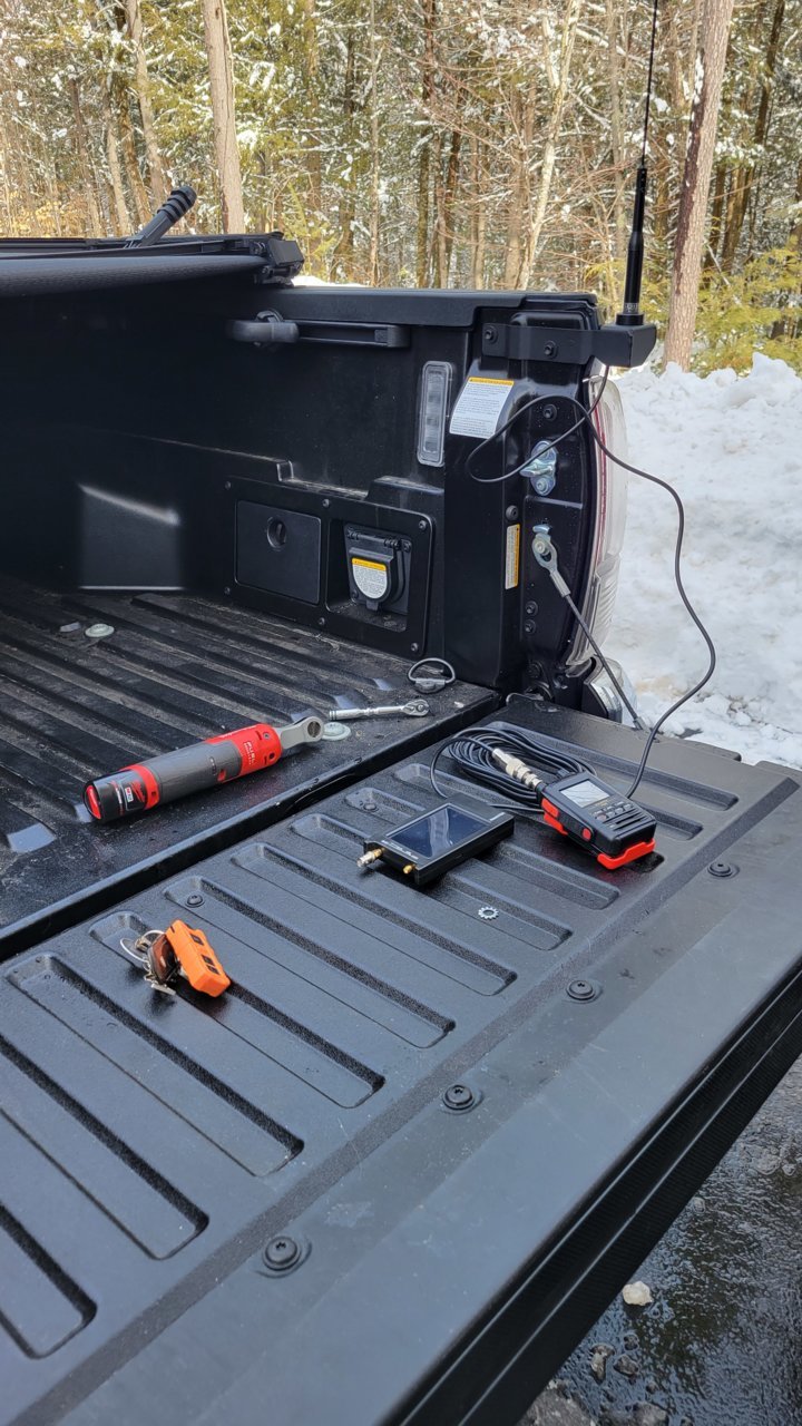

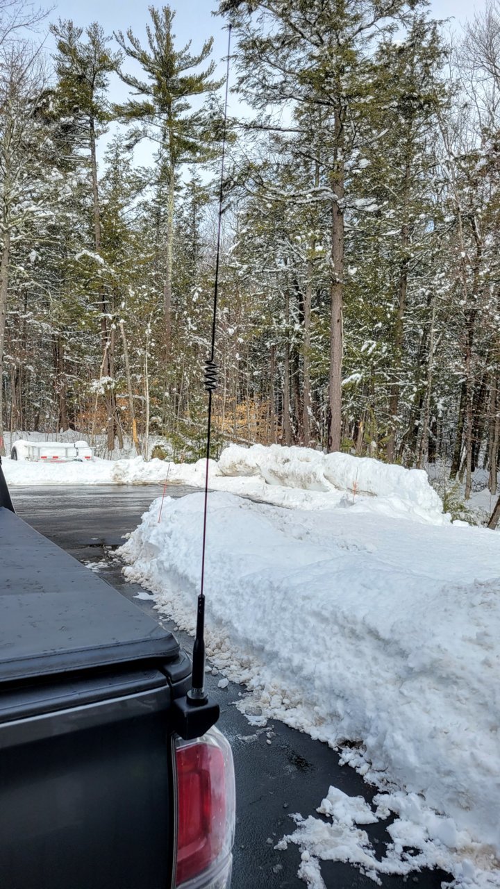

    I'm trying out a CaliRaised bed/tailgate mount for my Comet SSB5 antenna. Got the mount installed, and used a Laird NMO mount with the cable pre-soldered to it. I soldered a PL-259 to cable so I could test it with a Nano VNA, and a HT to see how it worked before running the cable inside the cab. It seems to be working well...swr was low at 1.08 @ 146.500. And I could hit a few local repeaters with no issues. Going to run the antenna for awhile and see how I like it mounted in that spot. It's about the same height as it was on the Crosstrek, and I had no issues with hitting any trees, etc. If I don't like it there, I'll try a hood/ditch light mount.
    I still need to run power into the cab, and get a radio mounted. I had a Yaesu FTM 400XD mounted in the crosstrek, but I also have a deposit on the new Yaesu FTM-500...so I'm kinda holding off on installing the radio until I see what the price on the 500 is going to be.

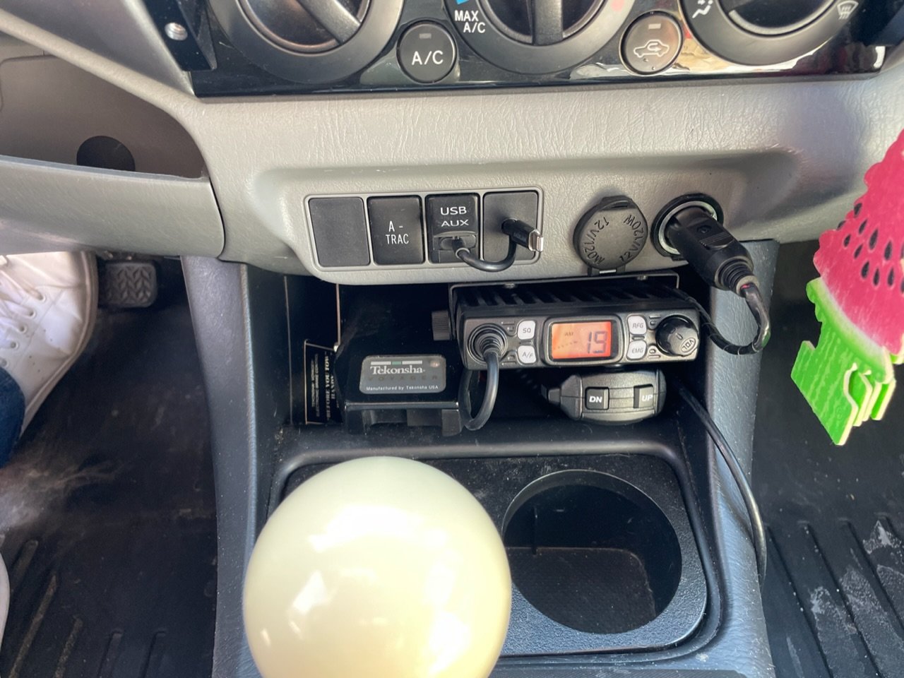

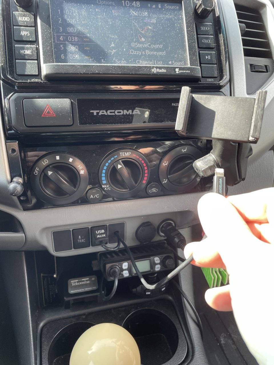

    Finally installed this little radioddity 27 pro.
    I made pilot holes with a little ice pick :D.
    Next is to install the antenna with a relentless fab ditch light mount.

    steevereeno on post #2390.......what is plugged into the USB port and found in the far right side? Not seen that before. I have a 2014 Sport that I am trying to figure out where I might put a Ham radio. Is that a ham or cb radio? Thanks! Doug

    Helps to tag or quote them
    @Steevoreeno
    looks like a cb to me

    The USB port is just a long iPhone charging cable. I tuck it into a hole in the empty switch spot to the right of it. Then I can just pull out as much as I need when I’m charging the phone
    The CB is plugged into the 12v socket
