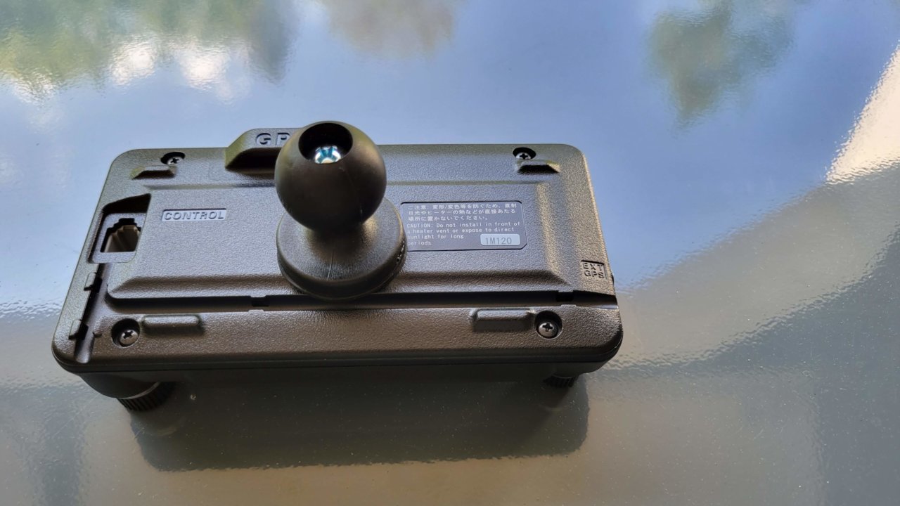

    Curios how you attached the Ram ball to the radio, I got an Lido Ram adapter for my FTM-500D but it’s much bigger and on the 500 radio head which is deep already it just looks comical.

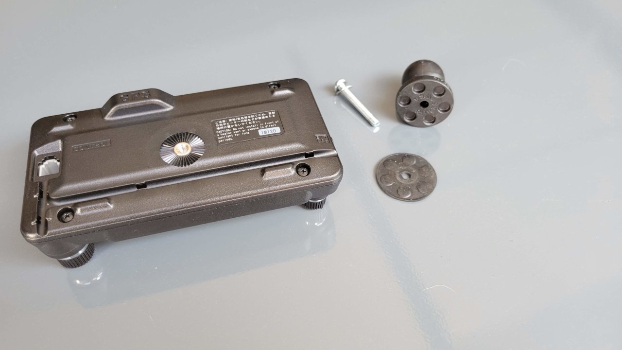

    I tried finding the mount I used on Amazon, but I must have got it off ebay. I'll try to get you a better picture later. I did have to use a different screw though...it is metric.
    Your comment on the 500 head being big is why I ultimately decided to keep my 400.

    Had a chance to take a couple of pics for you. The Ram mount is Ram #RPR-351-WBB. The screw is a M5-.80 x 35mm long. I put a rubber washer in between the mount and the radio face too.
