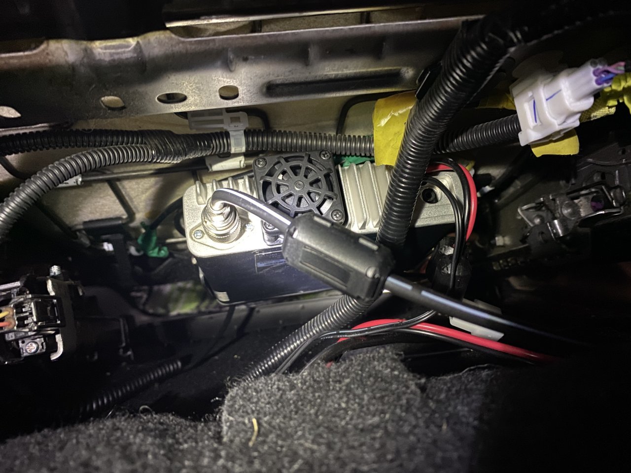

    I just set up the same radio. I’m impressed you used the sunglasses holder and kept it functional. I decided to remove the holder for mine. I wanted to pass along that I saw someone else hang the radio under the seat by working the bracket over the seat springs and then attaching the radio so it’s off the floor and slides with the seat. Pic of how it worked for me.

    Thanks! I was expecting some cutting but no cutting needed at the sunglass holder.
    I was going to use a bracket for the main body also under the seat, but I do not think its necessary. Using industrial strength Velcro holds on to the carpet really well, used a large zip tie also around the bottom vent and the body of the radio just for extra security.

    I cut two pairs of slits in the carpet and ran zip ties through them to my mount. If I ever have to pull it out, I may swap to Velcro.

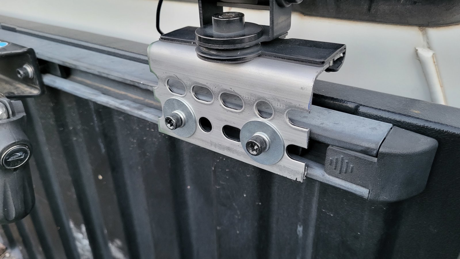

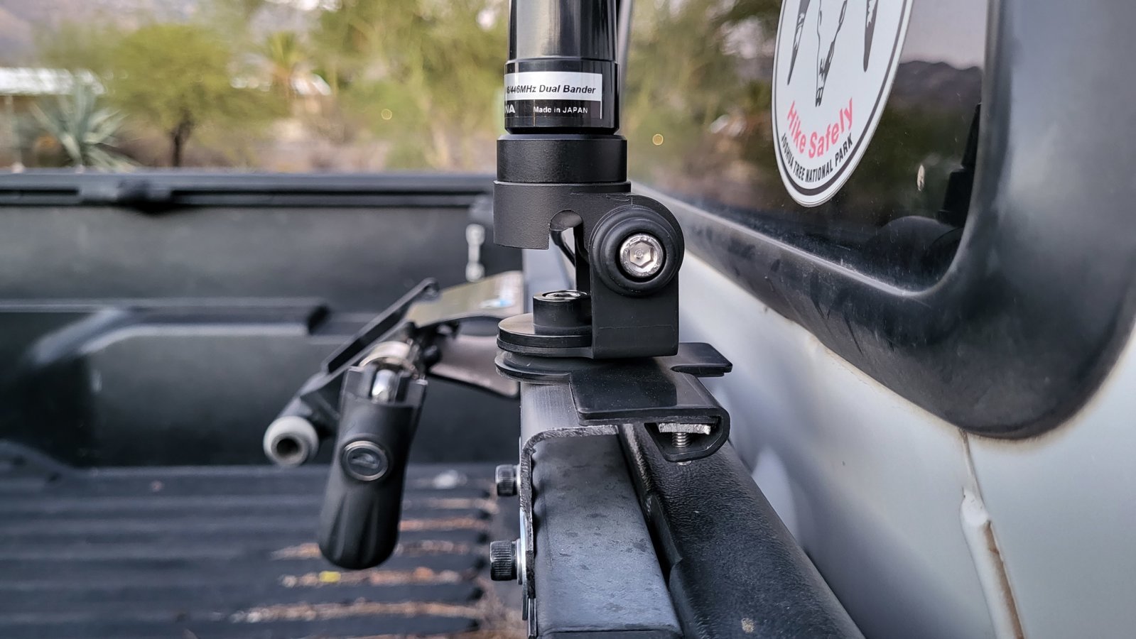

    Maybe not super clean, but I created a makeshift antenna mount with a short piece of angled steel scrap from the hardware store.

    Nicely done. Looks sturdy.

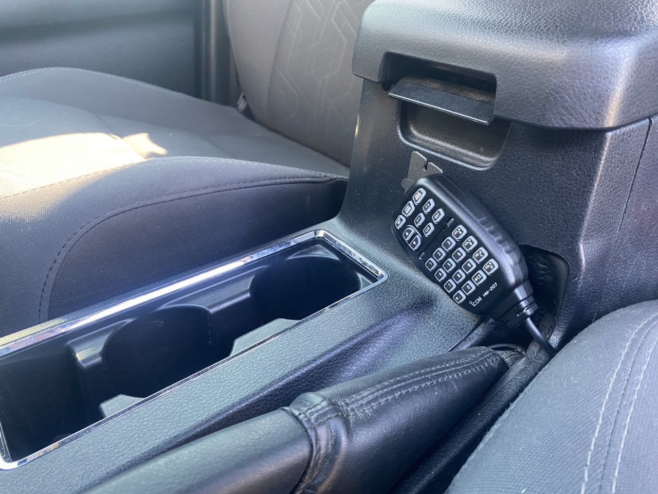

    I recently finished my FTM500DR install also. grabbed a 2.5" PVC coupling covered it with some leather and mounted a plate for the mic. also installed the antenna up down DPDT switch. Now when I drive my arm can rest on the console top and hand on the mic, allows me to make quick changes without taking my eyes off the road. Also, added 2 Icom mini speakers to the rear cab for an almost surround sound effect.FTM500DRx.jpg micmount-3.jpg micmount-2.jpg rearspeaker.jpg
