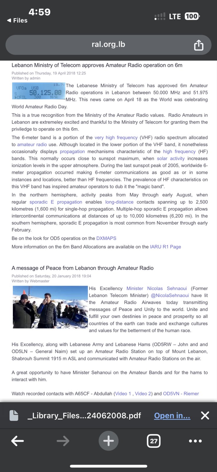

    I found this.

    ok found this. So would American radios work here? Thanks.

    US CB frequencies range from 26.965 to 27.405 MHz.
    Yes, it's true that a pair of simplex radios will technically talk to each other in any country. If all you need to do is communicate with other people in your party at close-ish range (and don't care about the legality, like would probably be the case if shit hits the fan), then that could be a potential solution.
    If you need to use repeaters to go longer distance. Or if you care about legality. Or if you would like any chance of talking to other people outside your party, then you'll have to use frequencies allocated for the use you are looking for in your location.

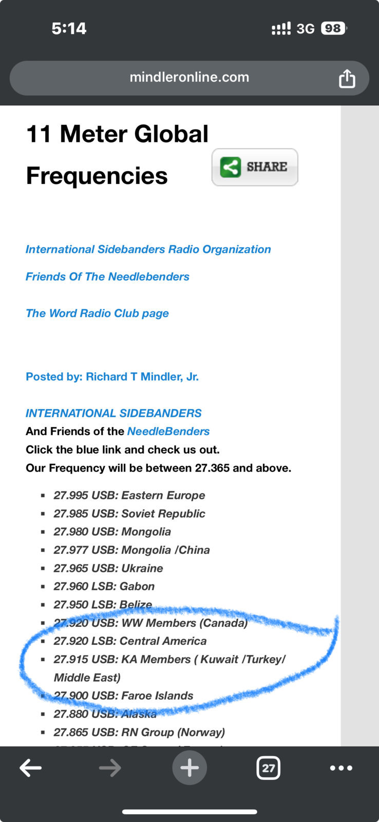

    Ok so I did some research and this is what we use here. Can radios on Amazon usa support this? What radio would you recommend?

    Those are HAM radio frequencies not CB which are 26.965 - 27.405 MHz. The issue is that each channel on the US CB is set to a specific frequency and not adjustable by the front dial. You just turn to channel 21, for example, and that is a single frequency in that range. I would suggest getting a CB radio specifically made to run on the frequencies in the Middle East.

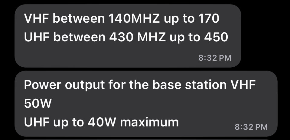

    the guy told me that everyone here uses VHF/UHF radios so I guess I’ll get that.
    are those only ham frequencies or also vhf?
