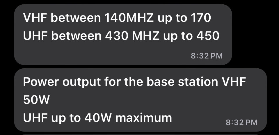

    I think this one would work.
    QYT KT-980PLUS 50 Watt Dual Band Four Display Car Mobile Radio VHF/UHF 144-148/420-450MHz Quad-Standby Mobile Radio Amateur (Ham) Two Way Radio with Free Programming Cable Black https://www.amazon.com/dp/B09G966HFN
    It says
    Output power 50W Max ( VHF / UHF
    but the guy said UHF should be 40W max.
    would that be an issue ?

    That’ll work just fine. There’s also some antennas on the page.

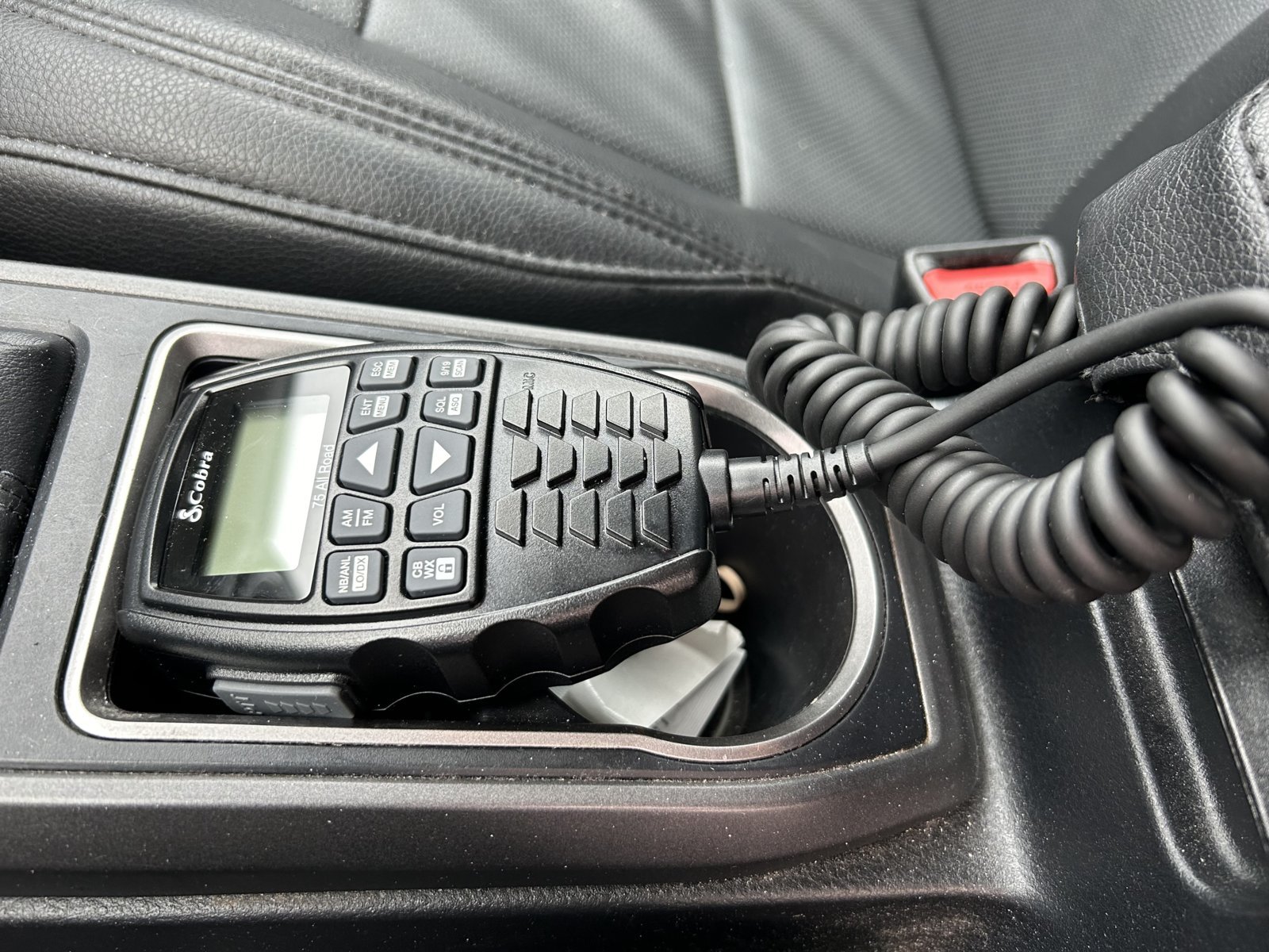

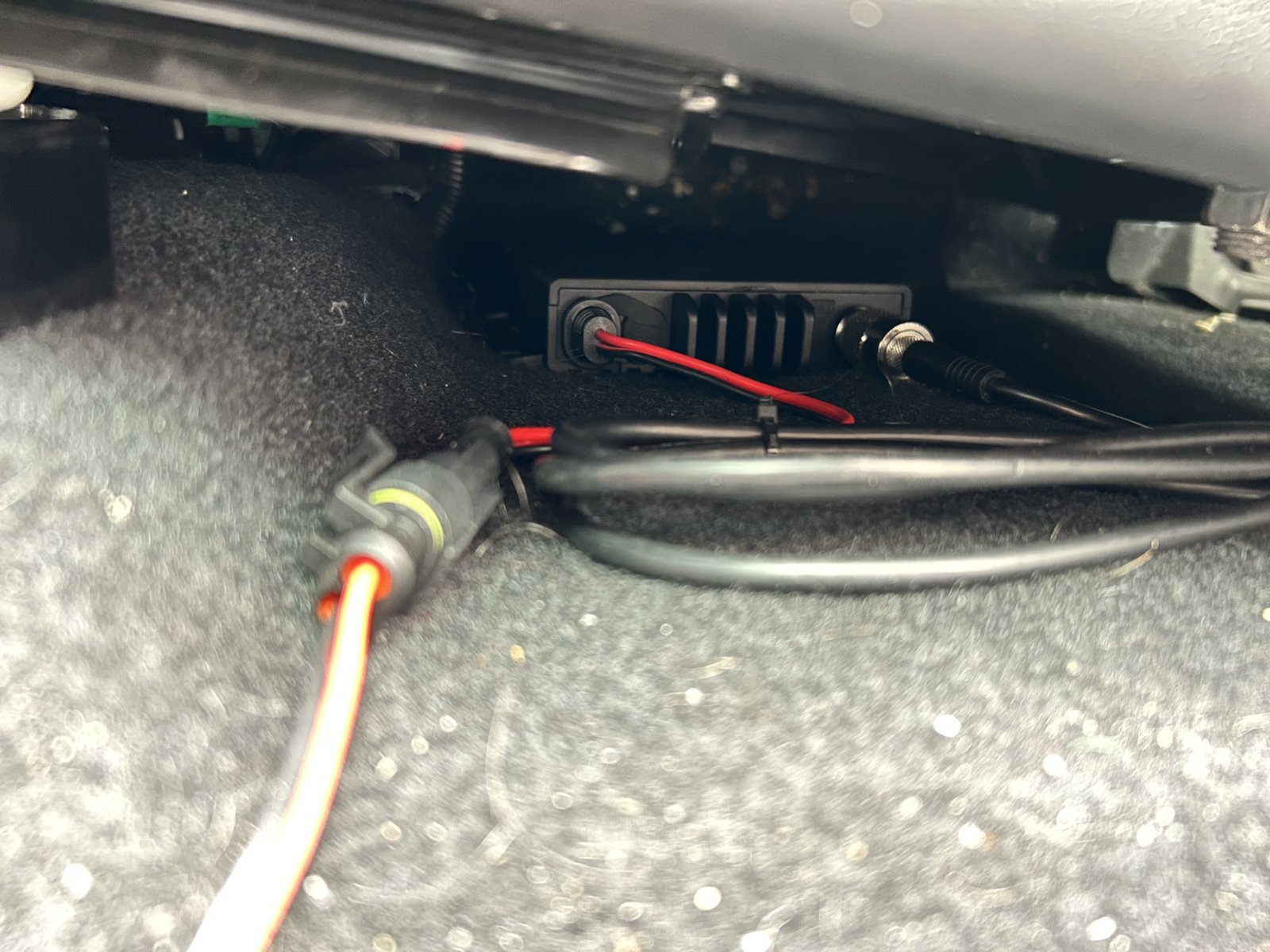

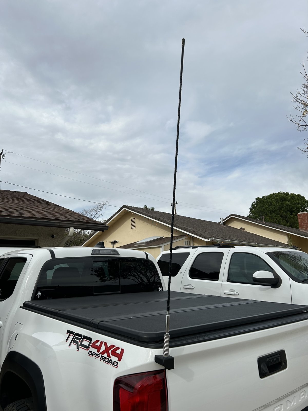

    Finished my CB install last weekend, but didn’t get around to taking photos until today.

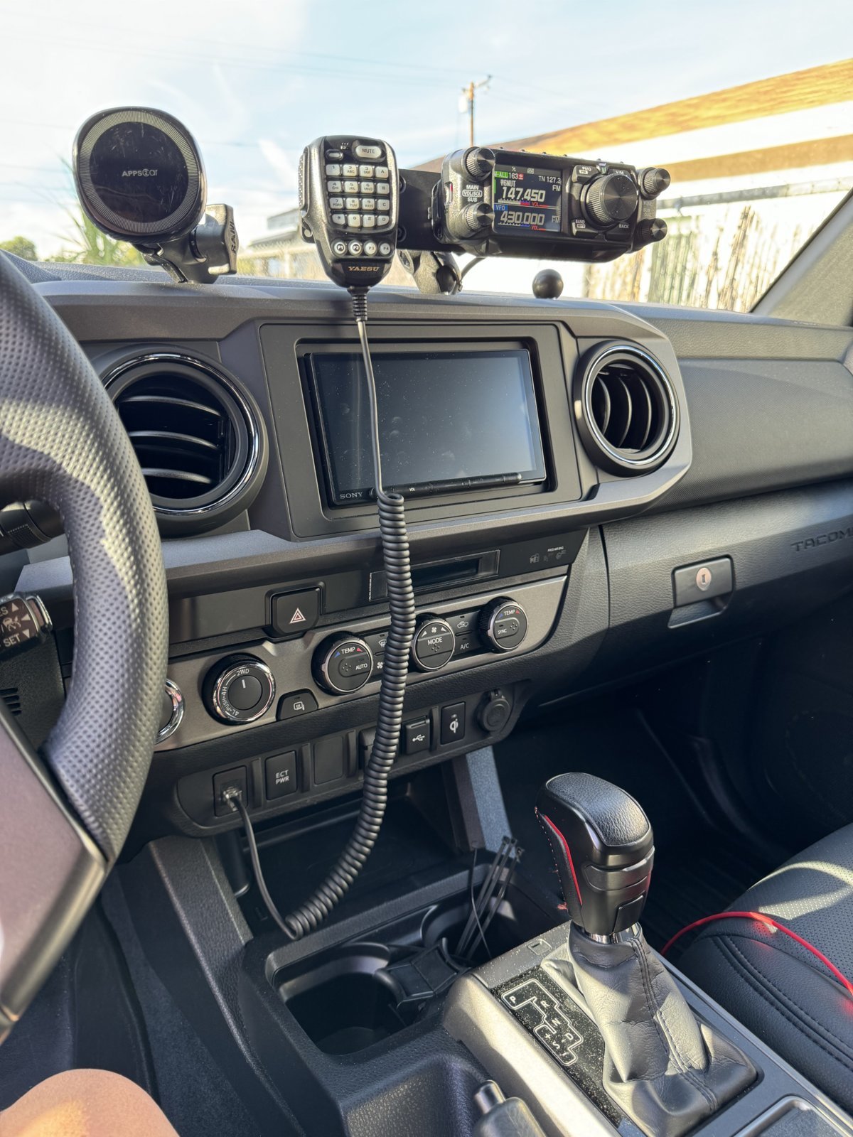

    Hey folks, need some input. I have my Yaesu mounted well; base under the passenger seat and head on the dash. Pulled my rj12 wire for remote mic, but can’t seem to get the mic to work on an rj45 keystone. I thought rj45 was backwards compatible to rj12? Ponied up for the Yaesu extension just to make sure. That works, but I think it’s just an overpriced rj12 and 2:1 plug (which doesn’t work for mounting).
    Any thoughts on why my rj12 extension with an rj45 through connector isn’t working?

    Yep, it’s a 6 wire, it’s just the 8 wire keystone pass through that doesn’t seem to work. That’s what I thought was backwards compatible. But I’ll check the wire again for redundancy. I haven’t run the Yaesu wire to the keystone yet…. Have to take the dash apart a little. What’s your keystone? Is it an 8 or 6 wire?
