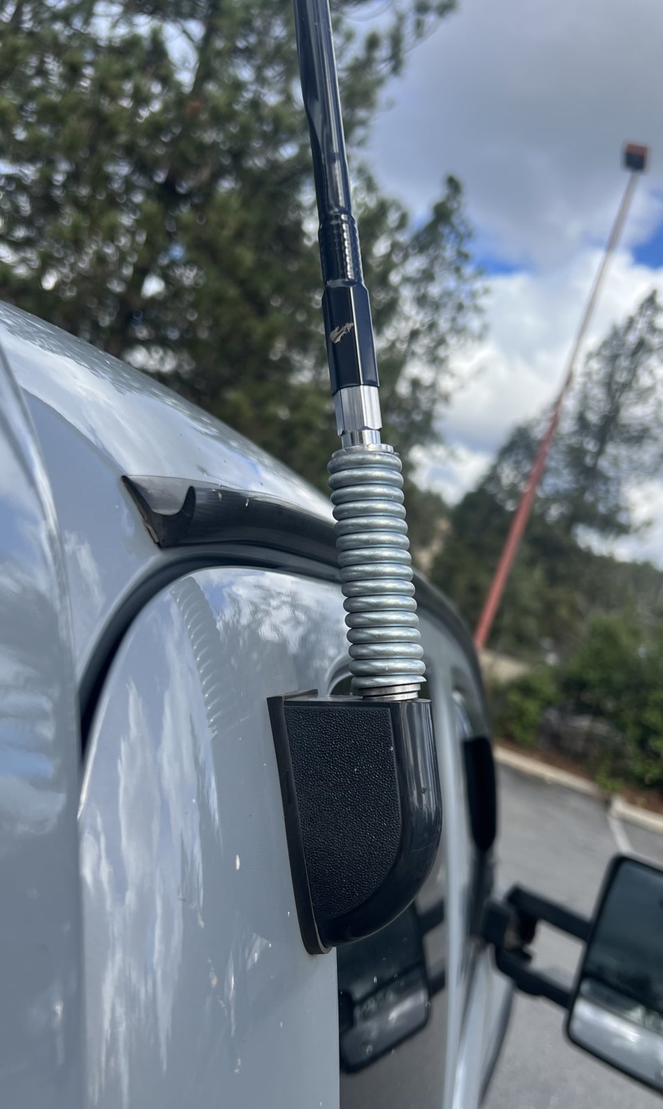

    OK, I got a bit ahead of myself and installed a 2 Meter FireStick antenna for my anticipated future 2 Meter mobile radio. Only problem is I upgraded my thinking to a 2M/70CM radio. The FireStick mount is a 3/8" by 24 threads mount. All the duel band antennas I have found are UHF connector or NMO Mount. Is there an adapter to change from the 3/8" thread to something else? Since this is an off road truck a spring will be used as well.

    I dont know how to link but try Amazon
    3/8 threaded to so-239 adapter.

    I ended up drilling out my mount to accommodate an NMO mount and then purchased an NMO to 3/8-24 adapter from Amazon if I want to run a Firestik.
    If you're just concentrating on the CB band, you could always purchase an NMO-27 coil and appropriate whip to fit the NMO mount.

    No CB here, if it was I'd just stay with the 3/8" mount.
    Amazing what the proper "search words" can bring back. My searches didn't return much of anything, but still not what I will be needing, or so I believe.
    The ground stops at the Firestik mount. I believe the UHF239 & the MNO both have the ground or shield at the base. See picture of my installation. I would prefer to use the MNO as I believe it is a stronger mount.

    Can you give details on the black base/mount that your antenna is attached to? (Also, what did you use for your ‘drip edge’ above your doors?)

    CATALOG Main Page (Frame Setup) (firestik.com) Mount Model M-2 in case this link does not work. Can not link directly: go to "Mounts and Accessories" at the top then from the left side bar select "Side Mnt Molded". There is a drawing in the description as well.
    I was afraid that picture would invite unrelated questions. Not saying this is the identical, but I picked the drip rail up at a Trailer Supply store:
    RV Gutters, Drip Rails for Cars and Trucks | Trim-Lok (trimlok.com)
    I've used it on two vehicles so far and am happy with it - does create some wind noise. It can keep the snow on the roof as well, so it does not come in to the vehicle as much.
    OR
    Amazon.com: Essential Products BL01002 Black 10' EZE RV Gutter : Automotive

    Ha - and I just noticed the custom side mirror. :D
    Thanks for the Firestik link. I found the side mount. :thumbsup:
