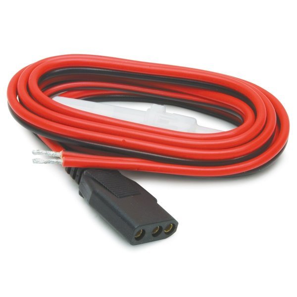

    I have a Uniden CB and it uses a 3pin 2 wire power connection
    Has anyone seen a 90 degree angle connector for this 3pin plug?
    I shoved my radio in the din slot below my stereo in my 1st gen, but this cord is making the Uniden unit stick-out about 2.5 inches further than necessary:frusty:
    I cant find one anywhere, I was so sure someone would make one lol:rofl:

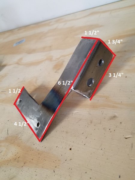

    this is how I make them if you are willing to try it out. Its really easy. I went to home depot or lowes I forget, and grabbed 10 guage steel 3 ft by 3 inches long. but all you really need is like 6 inches of it.

    I wish I could bend and weld metal with my mind..... someday.
    I'm sure I could probably take these pics to a shop that has the tools and they could bang it out pretty quick. Thanks for the pics!

    Here are the measurements
