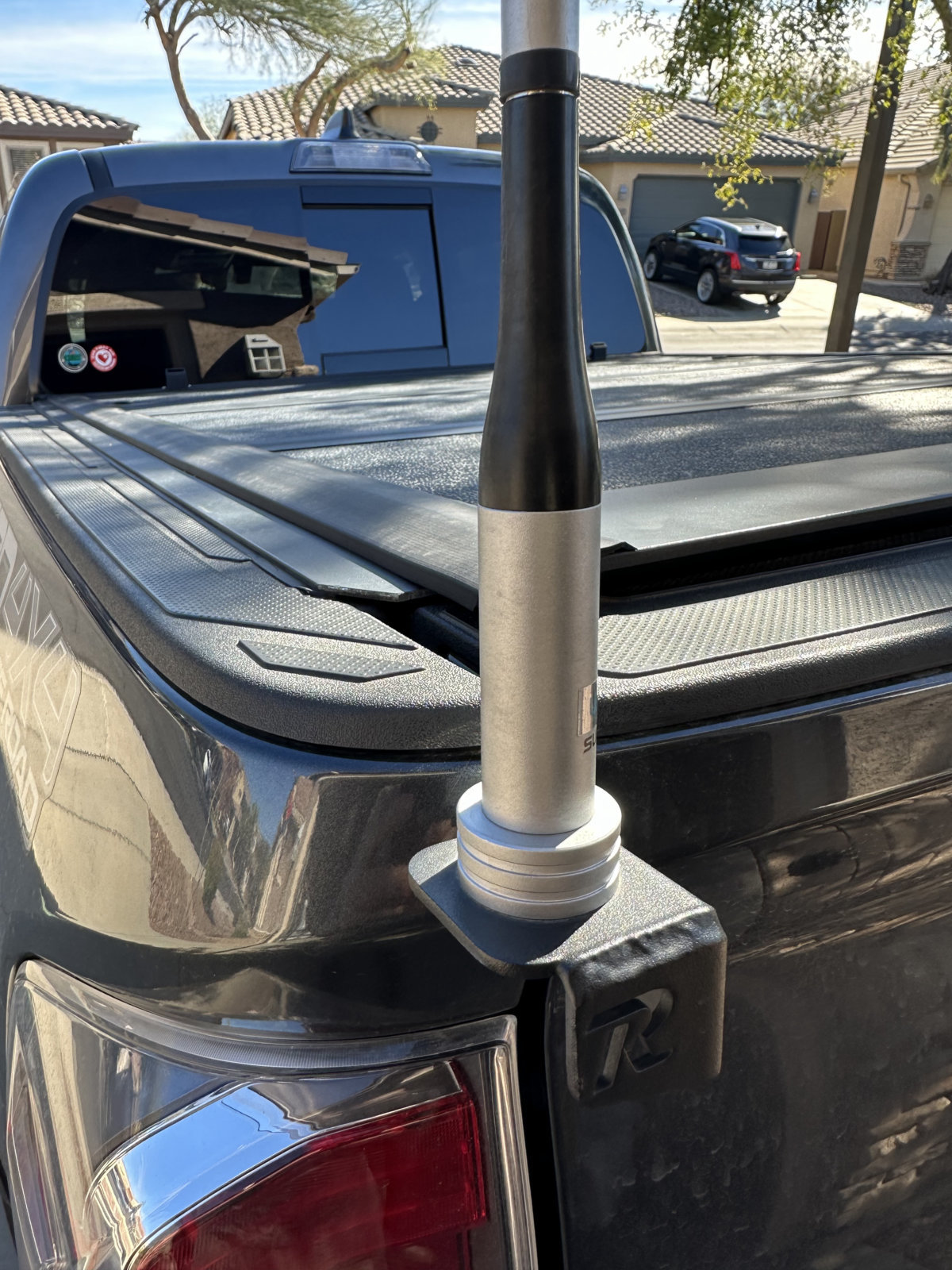

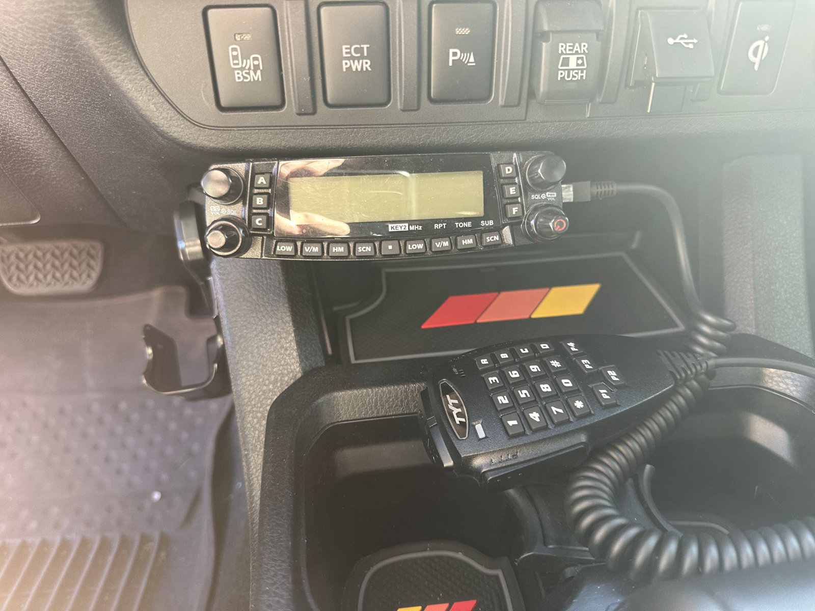

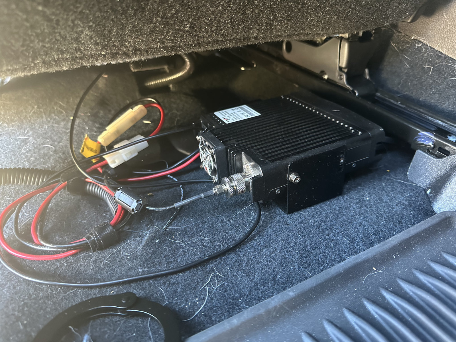

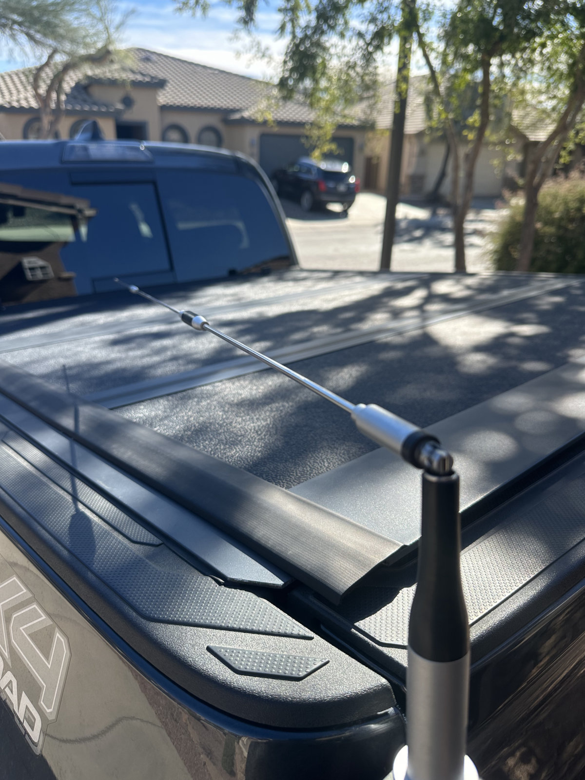

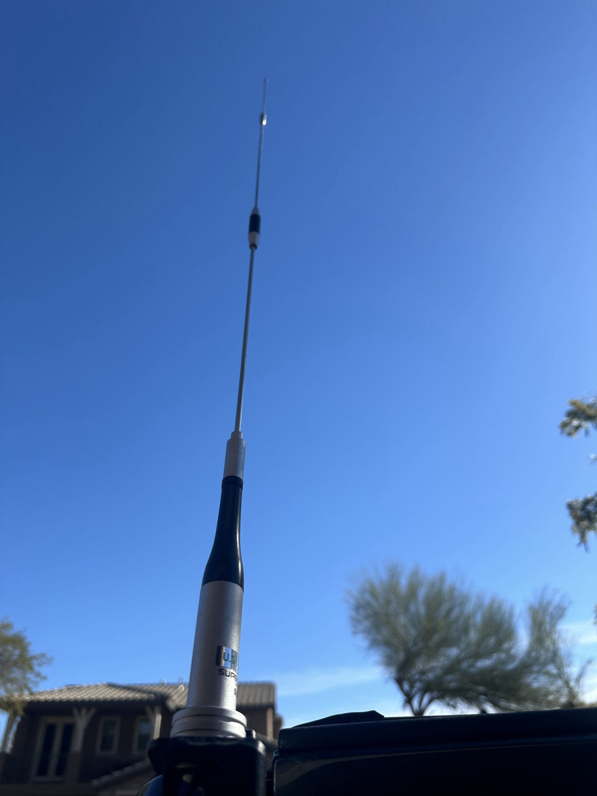

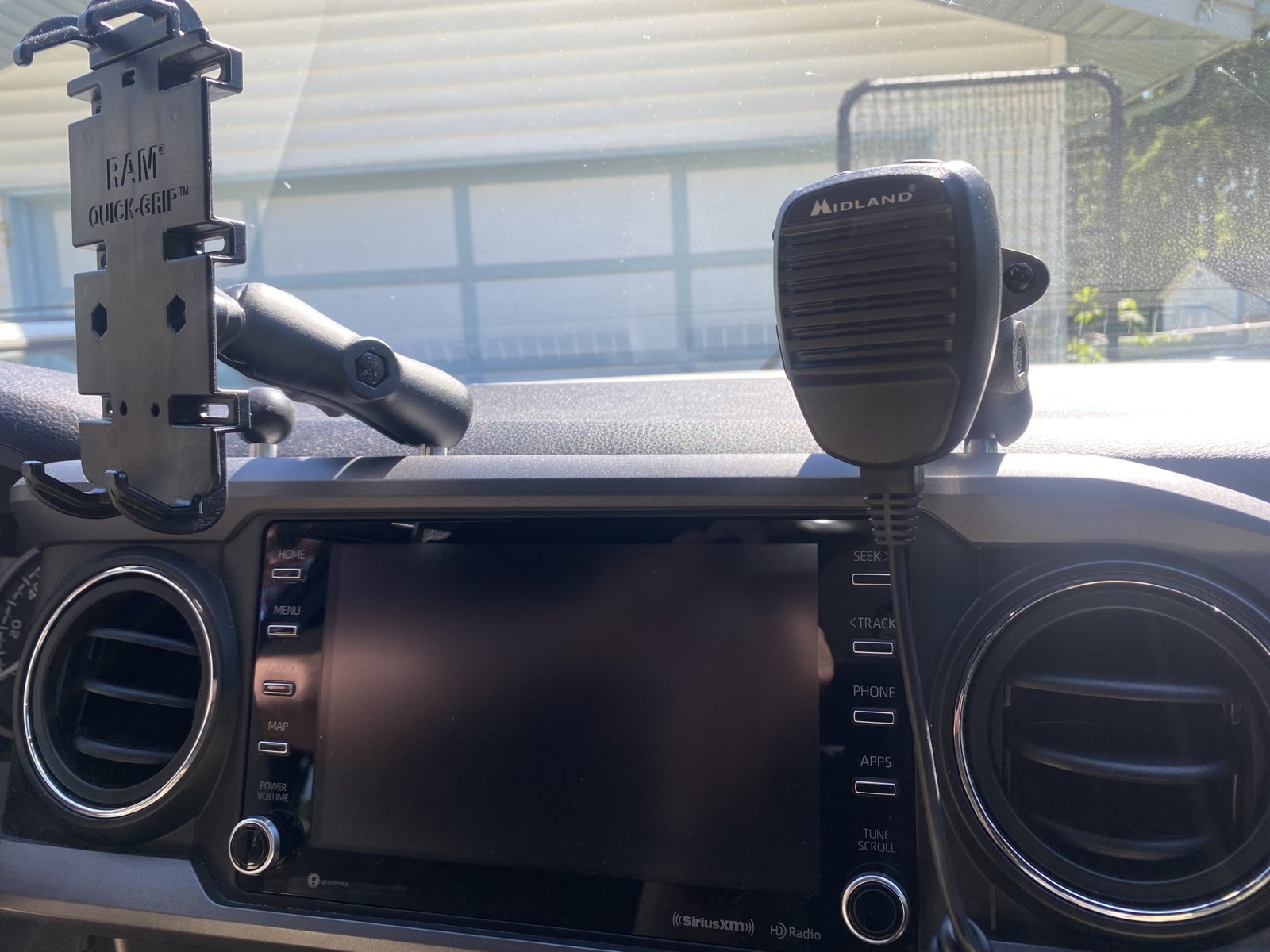

    Finally feeling good about my clean install to show pix.
    IMG_4660.HEIC.jpg IMG_4657.HEIC.jpg IMG_4662.HEIC.jpg IMG_4659.HEIC.jpg IMG_4661.HEIC.jpg IMG_4658.HEIC.jpg
    Works Great!
    TYT TH-9800 Quad Band (But I don't use 6M/10M yet). I just put the coarse side of hook and loop / velcro (r) on the bracket and stuck it to the carpet under the seat.
    Remote head mounted with the cable flowing up the trans tunnel plastic.
    Power goes under the channel where the door kick plates are. It's in a switched fuse with a power tap.
    Antenna runs under the lip of the bed and between the cab and bed. There's a grommet under the cab near the drivers seat. Antenna Cable runs through that, under the carpet and I cut a little hole for it to come through.
    Antenna is a Diamond SG-7500 (2M/70CM) with decent gain. Parking garages haven't been an issue YET but it hit's right at about 7 feet at the tip and does lay down.
    No mic clip / holder yet. That'll come later.
  13. Feb 12, 2024 at 3:50 PM
    #2593
    dwcfastrice
    dwcfastrice Bacon makes everything better.
    Jan 13, 2021
    #352627
    794
    David
    Southeast PA
    2007 Silver Mica DCSB
    So far: 2.5" Icon Lift, Steel Front bumper, steel rear bumper, Cali Raised Bed Stiffener, 12Volt.Solutions remote start, Stereo upgrade, A Pillar Ram Mounts, BAMF Behind the grill light mount with Sylania 20" bar; KB Voodoo Max 22" Rack, CVT Awning, Decked drawer system, pod lights
    Nice handcuff.... ;)
    Seriously though. REALLY liking that folding antenna mount.

    The folding feature is part of that antenna. One of the reasons I got it was that it doesn't require a ground plane. It's all self contained in that bottom area apparently. Can be mounted on Fiberglass Boats, Camper Shells, etc. Right where it breaks and folds over is where the bottom end of the match or self contained ground is located. Really slick antenna. 3.5db on 2M and 6db on 70c.
    https://diamondantenna.net/sg7500a.html

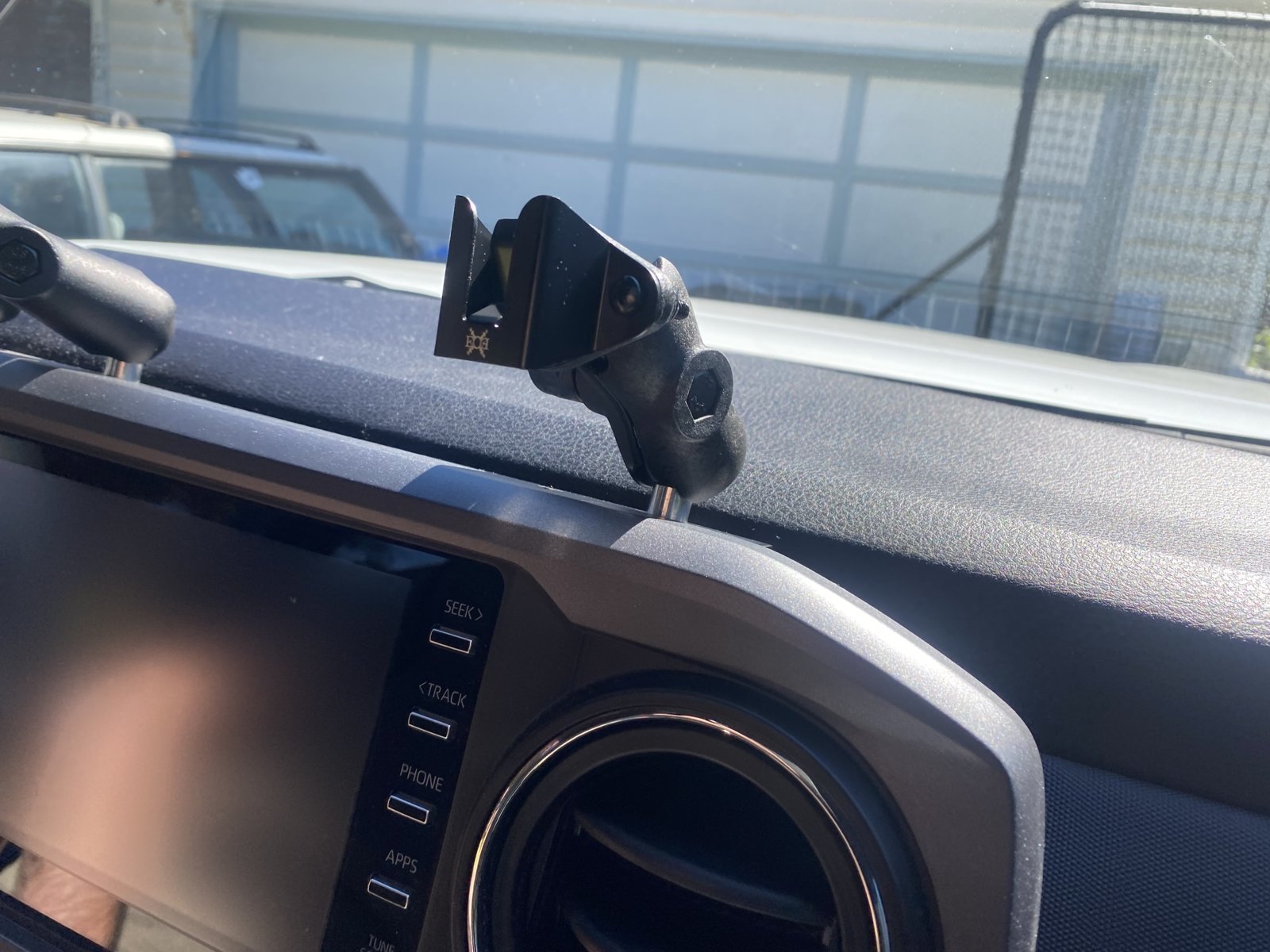

    I did the same, for a pair of cuffs for the keychain. Never thought of using them to mount anything but that’s a great idea for securing a small truck safe for a handgun size safe or case. Way more durable than the small cable that can be cut with a pair of side cutters.
    For the mic mount, do you have a dash mount? I used the DMM from taco garage and then got a mount for the RAM system and fastened it to that. It works great and right above where your radio is mounted so the cord isn’t being stretched constantly.

    SG7500 is a great antenna. I used one on my motorcycle for years.

    One of the next upgrades more than likely.
    Thought I would do wireless car play (WCP) but then I have to plug my phone in to charge.
    But if I get WCP and then put a mag safe charger in the center console cubby.
    Then I forget the phone in the truck.
    So now looking for how to get a mag safe phone mount to keep it up and visible so I don't forget it in the truck.
    Mic Mount will go next to it.
