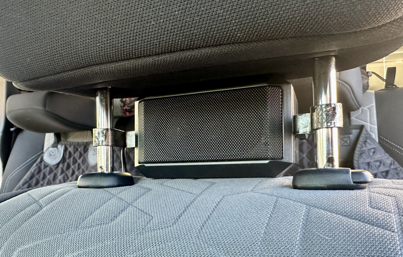

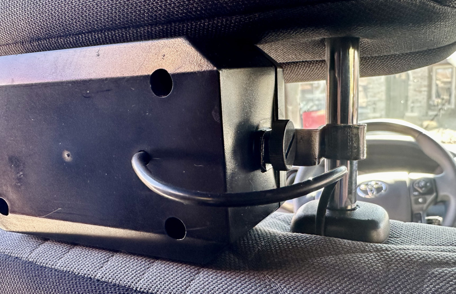

    Forgot the external speaker.
    Just bent some aluminum bar stock / strap around a mandrel and then worked it to the same diameter as the head rest posts. Pained it black (which didn't really stick and rubbed off).
    Ran the wire down the inside of the seat cover carefully avoiding airbags.
    I like it because on road trips I can keep it low volume and still hear it but the wife can sleep.

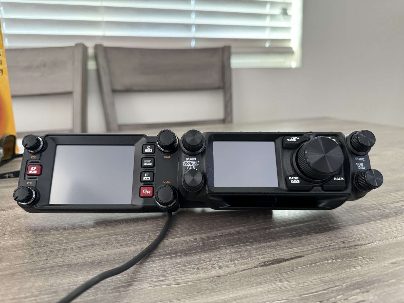

    Curious as to how you are going to use them as they are essentially the same radio?

    The FTM-500 looks sweet with the big VFO knob but functionally, I prefer the FTM-400 on the left. Bigger screen and I don't "spin the dial" on VHF/UHF as much. But the FTM-500 Remote head would make a great control for a Mobile HF Radio.
    Still, @fake4x4 has two amazing great radios there and I can't wait to see the install and see how he's going to use them.

    just trying to figure out where I’m going to mount the antenna for the 400…. Will probably do a lip mount on the hood with a comet 2x4sr, might swap 500 with the sbb5 and the 400 with the 2x4sr

    Since they operate the same Freq's, I'd put them as far apart as possible. One on the front bumper corner like the Aussies do, and one off the back tail gate on a Rago-Fab mount like I did. Try to get at least 2 meters of separation.

    That is the plan, just gotta decide which radio is going to stay in digital
