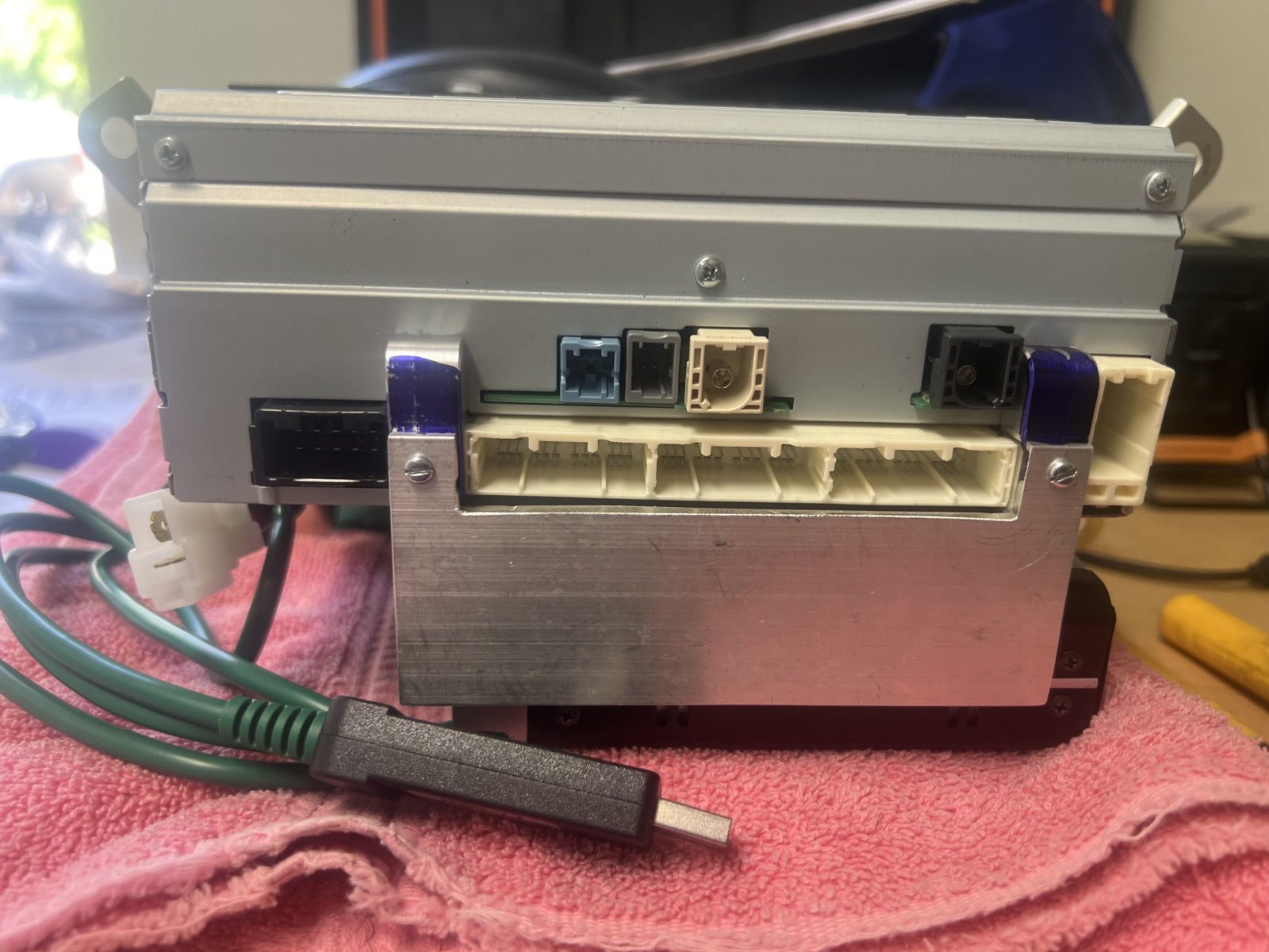

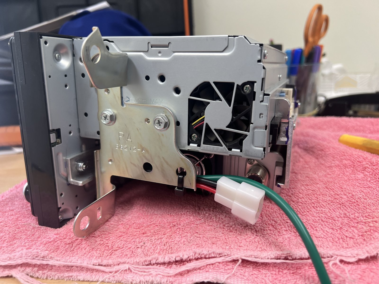

    No, when I plan on using the Yaesu I won’t care about the radio. Haven’t any experience yet as it is a new install and I haven’t even programmed the Yaesu or tuned the antenna.

    Audio is how ever the radio came with in default. I believe I am hearing the speaker in the radio head on the dash immediately above the radio, may also be hearing the base unit speaker, but it sounds fine to me. No external speaker.
    I picked this location because I will, sooner or later be going in deep water and the only other location acceptable to me was under the front passenger seat. I know from experience with another vehicle the chance of that area becoming soaked is high.

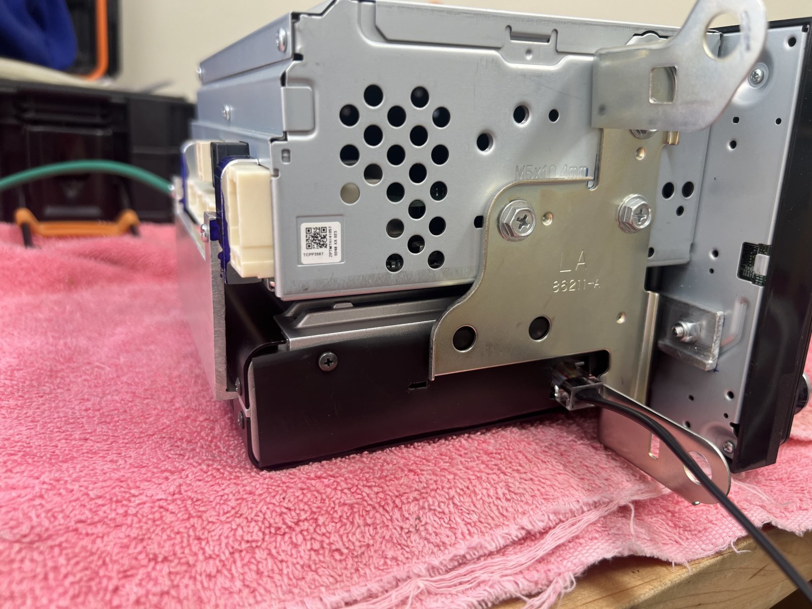

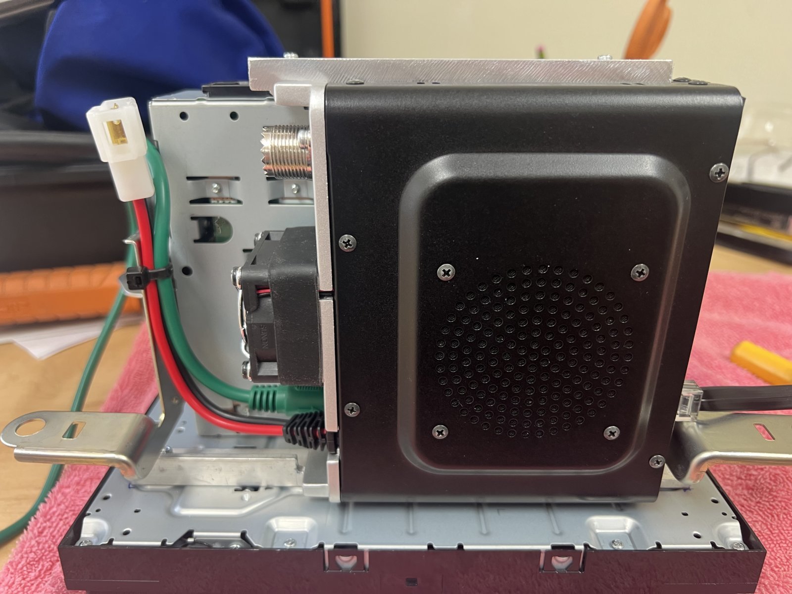

    Mounting hardware was indeed custom and very roughly handmade utilizing the slide mounting slots on the Yaesu. Aluminum right-angle extrusions .125 thick were used with taking the .125 down in thickness at many places. Disassembly of the stock radio to a moderate degree was required. Nothing difficult. Just to note the radio uses M2.6 0.45 screws which I sourced from McMaster Carr. The regular Hardware store available M2.5 0.45 screws were too loose a fit for my liking.
    I suspect you are correct in that not all Toyota radios use the same chassis, year-to-year and option-to-option. The mounting tabs did have various different mounting hole options that I assumed were for larger chassis radios. My suspicion is the older the radio the larger it is, electronics always seems to get smaller.
    Now, as to your heat concerns - I too have that concern; only time will tell. The stock radio has an internal fan, as does the Yaesu; both fans are facing the same direction, this was coincidence not design. My use of the Yaesu will mostly be for vehicle-to-vehicle communications in a group, so no large power requirements, thus I hope no large heat generation. I initially mounted the Yaesu ~3/16" away from the radio but had to move it into contact with the radio to get the assembly back into the stock radio hole. Your ICON is 2MM thicker than the Yaesu, this is the only dimension that I can see being a problem.
    I discovered this location as I had the glove compartment out for other projects, and I just happened to look up at the radio and saw a gaping hole for the Yaesu. Otherwise, the Yaesu would be under the passenger seat hanging from the seat springs.

    I remember reading that M2.6 spec for my Icom head and thinking it was a typo in the manual. I didn’t even know that was a size, what’s the point? It does the same job as M2.5!

    The M2.5 was a loose fit in the thin sheet metal designed for 2.6 AND where 2.6 were previously used. The original screw attachments were designed to fit two pieces of sheet metal together only, not hold the weight of an additional radio over a bouncing trail. It is a small difference, but one that felt very large to the touch. This is the physically weakest part of the installation; do not want it to fail.

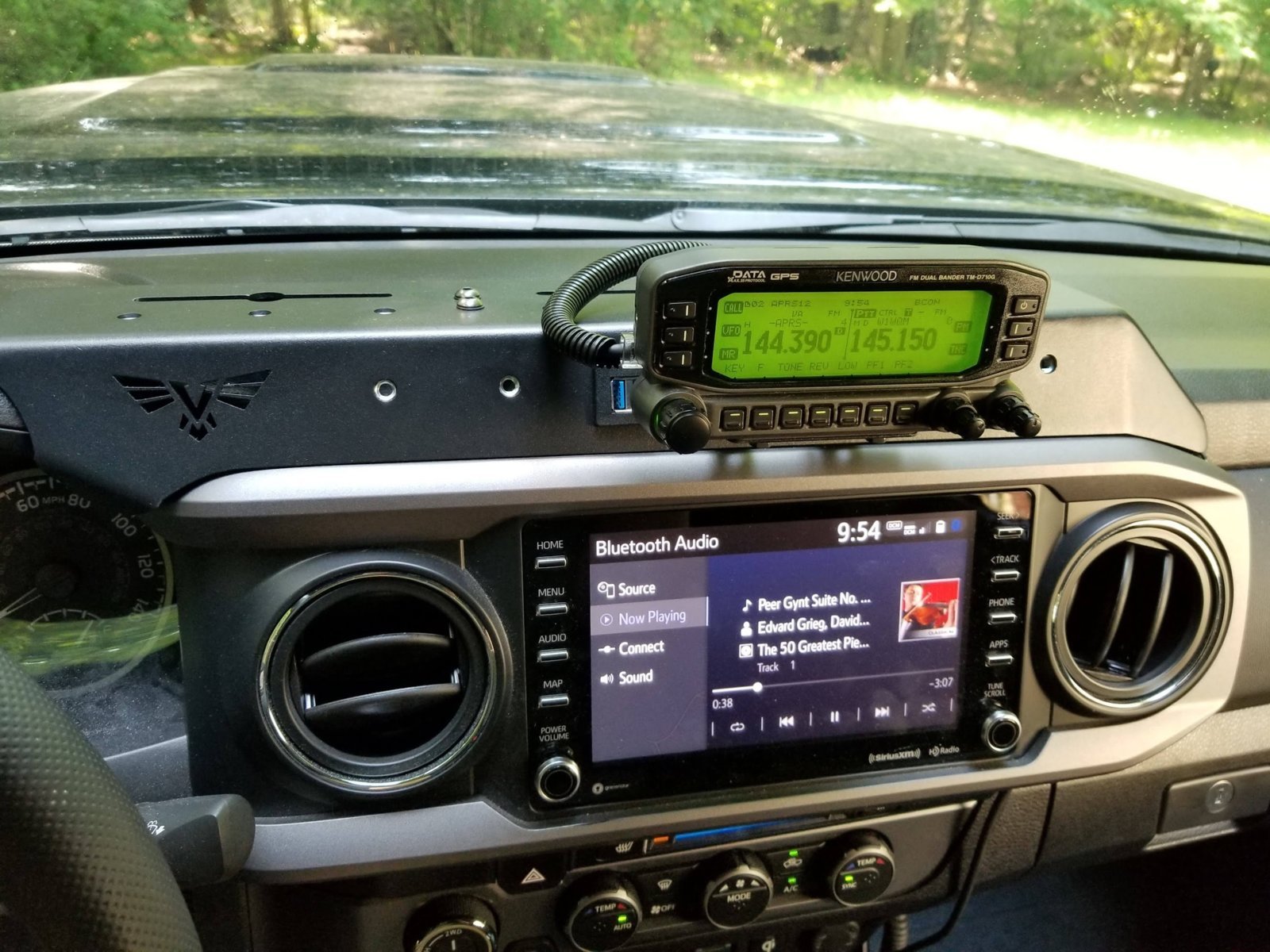

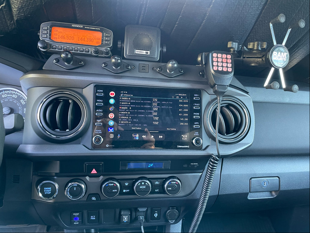

    New to the site with my recent Tacoma purchase. Have seen a lot of great installs/setups and figured I'd add a pic for others like me in the future.
    Below pic is how I have the dash setup with my Kenwood TM-D710 along with the phone mirroring APRSdroid on the stock touchscreen via AndroidAuto. For those unfamiliar with APRS, radio gets gps coords, broadcasts it for others to locate (direction + distance) and see what freq each radio is on.

    I separated the TM-D710G face plate's mount at its two screws and fabricated a bracket that allowed me to mount the unit to the front of the accessory mount in place of a ram ball. This required no appreciable modification to the part of the OEM Kenwood mount that I retained, so it can all be reassembled if I ever sell the radio.
    The result is the face plate sits a little bit lower and closer to the occupants, which has cut down on the glare when driving during daytime, and I can still unclip the head unit from its mount when I want to remove it from the vehicle.
    I have the mic clip down on the MOLLE panel on the right side of the center console but plan to move it up to where you have yours.

    I'm curious if you have any pix to see how your faceplate looks in that location and what the bracket looks like as I've thought about possibly moving it lower as well. As for the mic location, that ended up being the best for me due to accessibility, the cable not blocking any air vents while also allowing me to view and use the touchscreen without anything in the way.

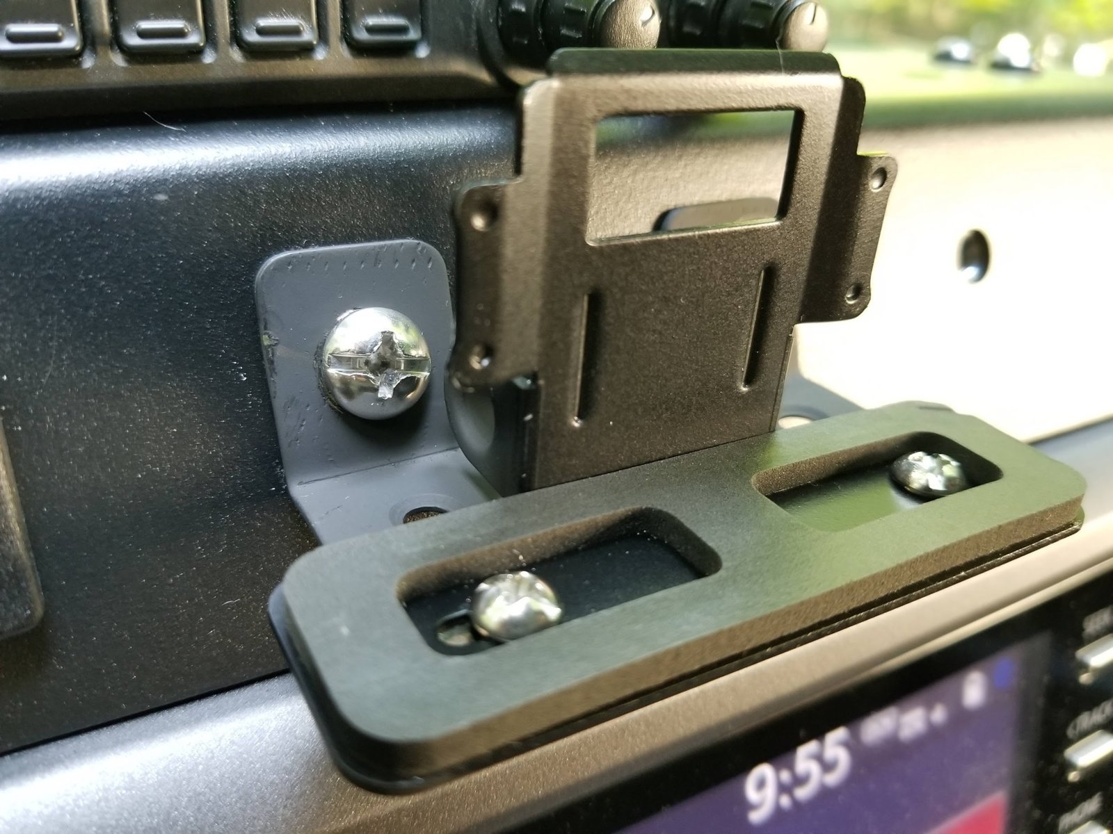

    Closeup of bracket:
    AP1GczNIRvLsYUsmk4wuJdbCBLwB4yQdO2wtPBPL_dffef81d920bcaa81125d246d68d7c3078041cbd.jpg
    I simply took a couple of angle brackets, drilled the existing holes out to handle the screws, and bent them to an obtuse angle. Note the tool marks from the vise at the top of the left angle bracket. Smaller screws with flat washers, lock washers, and nuts were used to affix the angle brackets to the forward part of the Kenwood mount. Rivnuts would be better here.
    Mounted:
    AP1GczPX8qmjMvGLEBaEIDhihZdr5MEXNp3_-pMV_a8068c69aecaeca127e0da765b121a5e9529ffa9.jpg
    It's worth noting there is no on-the-fly adjustability, but changing the vertical angle would just require another trip to the vise. With the face plate at the current angle, both my XYL and I have equal access to the radio. Also, you may notice my mount is by Victory 4x4 instead of the Expedition Essentials version everyone else has. That affects how the face plate is positioned.

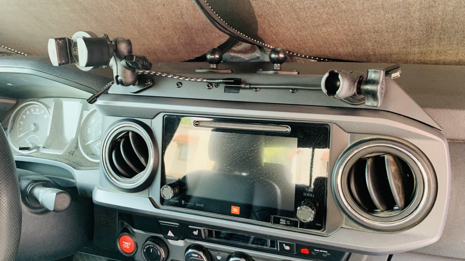

    How are you mirroring APRSDroid onto the radio screen?
    I've got a FTM-400 in my truck, and while it has APRS, the message capabilities aren't great. I usually use a Mobilink connected to the radio, and use either a PC, or an android phone for APRS messaging. It works well for hitting the space station too, but you gotta be quick with your messages! I'm usually using a different radio for that though. I have an Icom IC2730 for satellite work as it has full duplex.
  17. Jul 12, 2024 at 8:11 AM
    #2637
    AlBrewer
    AlBrewer Well-Known Member
    Jan 21, 2023
    #415988
    76
    2023 TRD OR
    Don't know if it's the best, but I'm using the Dashtop Multi Mount from the Taco Garage. Very happy with it, and the install was easy. I'm running a phone cradle, a Garmin ZumoXT sometimes, and can hang a portable radio off it too. I use a Moto APX600 for GMRS and P25 stuff once in awhile.

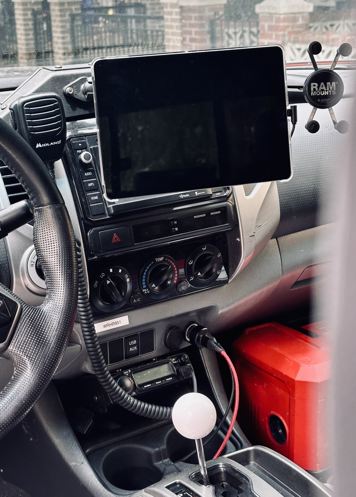

    2nd Gen but Im stoked on how this Midland has been working out for me. Keep a few rocky talkies in the center console to hand out to plebs without comms.

    Get the Expedition Essentials 3TPAM. It had been nearly $300, but it is currently on sale for $129. I got mine for $116 w/ vet discount. Your choice of USB-A or USB-C power. I opted for USB-C.
