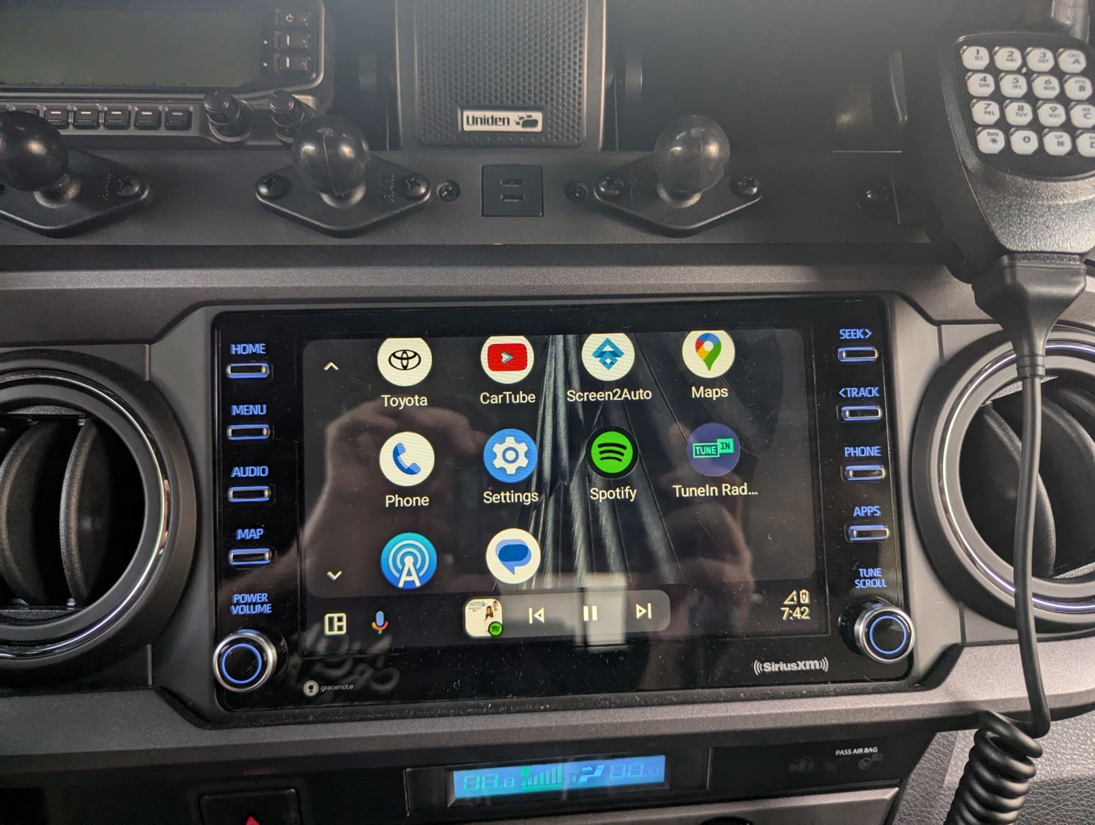

    Kenwood TM-D710 APO3: Automatic Power Off 3 American Roll Cover Petal Commander PC Quick Release Mount Anytime front camera MillerCat Shield Expedition Essential Dash Mount Mezo Puddle LEDs Fitcamx dashcam Seat Covers - Clazzio Black Nappa Leather Blackout sequential turn signals Bed Step AVS window visors Seat Jacker - Driverside Hood Struts R4T Tailgate Lock SeBellCo tailgate lock Flag hitch cover with Hitch lock VLEDS Interior Lighting Screen protech Center hidden console cubbie Center console organizer Glove box organizer AJT RESIGN Oversized Cup Holder Gas cap holder B/W Distressed Flag Sticker - Rear Center Window 146.52 Sticker - Rear Window Radio IT Sparks Sticker - Rear Window Flag Decal (Doors) Steering wheel cover Bed Netting (box style) Windshield Shade Black/White Flag B/W Flag license plate frame Bed Mat ReadyRamp FOB Replacement Solar Battery Charger Battery jumper + bag Empty space seat filler
    Sorry for the delay, just got back from a TDY.
    Gonna address gvfs first, I'm gonna check out that as an option. Seems quite simple just not sure if the placement will work with the spacing im tying to achieve without losing a mounting point by dropping down the faceplate. Thanks for sharing the pix!
    Back over to you AlBrewer, For the screen mirroring, ive gotta first relay that I always root my Android phones upon arrival so I can unlock some restrictions including android auto limitations, add a system level ad blocker and block certain apps from inet access for various reasons. With root access, you can use apps not found on the playstore to make some additional admin/root changes. Screen2Auto v3.7 (https://inceptive.ru/projects/s2a) is the one I use that creates a desktop/launcher on android auto and also mirrors the phone screen allowing touch on the dash screen to passing thru to the phone. I also used AA-AIO-Tweaker v5.2.2 (https://github.com/shmykelsa/AA-Tweaker/releases) make some changes as well. This allows for complete usability of the phone apps like Nest app, APRSdroid, FitCamX, YouTube, etc to be used from the dash. I used this route specifically since my phone already has all of the internet access that im willing to pay for and does not require a hotspot like some other solutions.
    Here are some pix of the launcher and apps I frequently use.
    Last pic I took was to show how my phone is displayed outside of the launcher using the stock camera app.
    Hope this helps explain some.

    Yes, spacing is different between the Victory 4x4 accessory mount and the one you are using. Mine worked out perfectly for centering between driver and passenger, but my guess is most people want the faceplate mounted more toward the driver or at least angled toward the driver.

    Thanks for the details and pictures...nice setup!

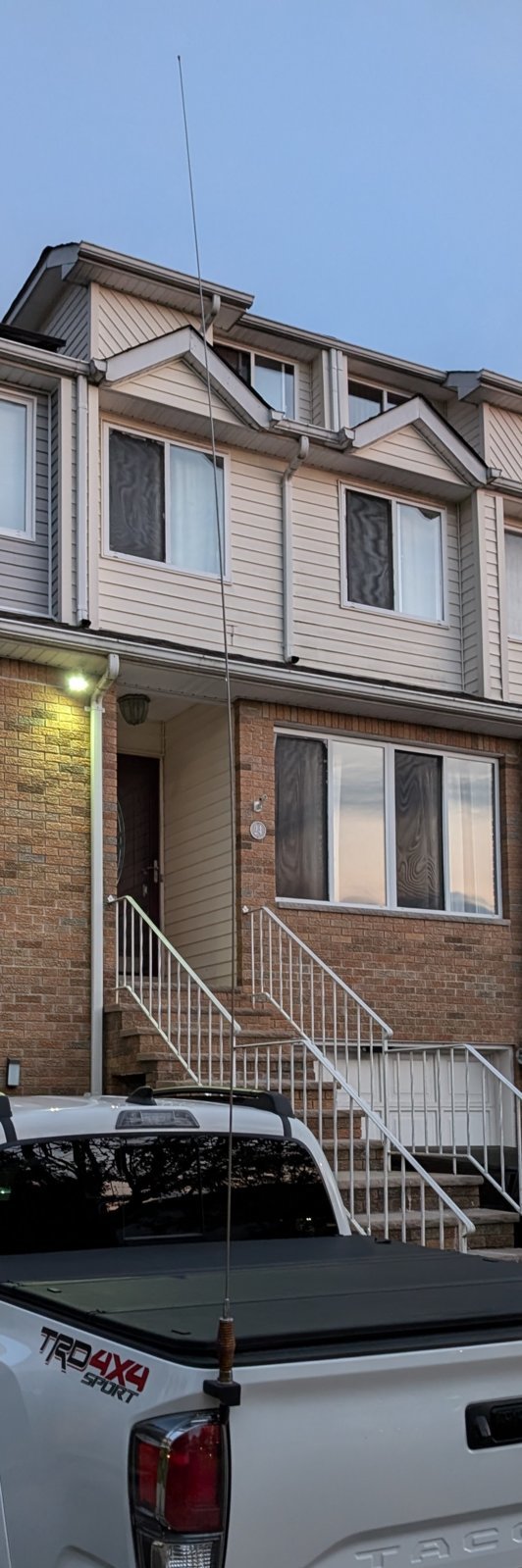

    I mounted my old 102" whip from my old AMC SX/4 on my Tacoma . I sold my old CB with the car years ago but a friend of mine gave me a little radiooddity cb so I got around to mounting it. I'm going to get a shorter antenna for around town, this thing is almost 13ft tall.
    Inside:PXL_20240726_003555585~2.jpgout and swinging:PXL_20240726_003858627~2.jpg
    Folded away:
    HKG, trdo-r and willtill like this.

    I absolutely LOVE the full 102" whip antenna! :bowdown: Seventies man! :dancingbacon:
    What type mount are you using on your left rear quarter panel for it?

    For starters - Much Love on that retro look. The full antenna is amazing.
    That angle where you have it bent forward has some history most people don't understand.
    In the normal straight up position, the radio waves come out the sides of the antenna - so they radiate around you like an orb or more technically a doughnut. It gives you line of sight to the horizon in 360 degrees. About 2 to 6 miles of range.
    But tipping it forward in the "Cloud Warmer" position means that when the signal shoots out of the sides of the antenna they shoot straight up to the sky and during the day the ionized atmosphere reflects it back down like a parabolic dish - so you can talk OVER the horizon. Gives you up to about 250 miles range - optimally.
    So that tip forward isn't just to fit in the drive through, it it a performance tool.

    I used a mount off of Amazon. I had to cut up some plastic to make a bushing for the rear tailgate mount to keep it from striking the bracket. Just take the tailgate off and add a plastic bushing or two on the mounting stud on the left. The tailgate moves left and right anyway without striking either side, with the bushings it can't move close enough to strike the mount and it still has a little side to side play, plus the plastic is soft. I like the 102" whip, had it on both of my 83 eagles. This one will hit every bridge on the parkways in NYC, so I gotta keep it tucked. SWR showed 1.2 and 1.3 on 1 and 40, with it as it sits. No fuzzy dice yet, but I have an 8 ball suicide knob I can add from one of my old eagles as well.

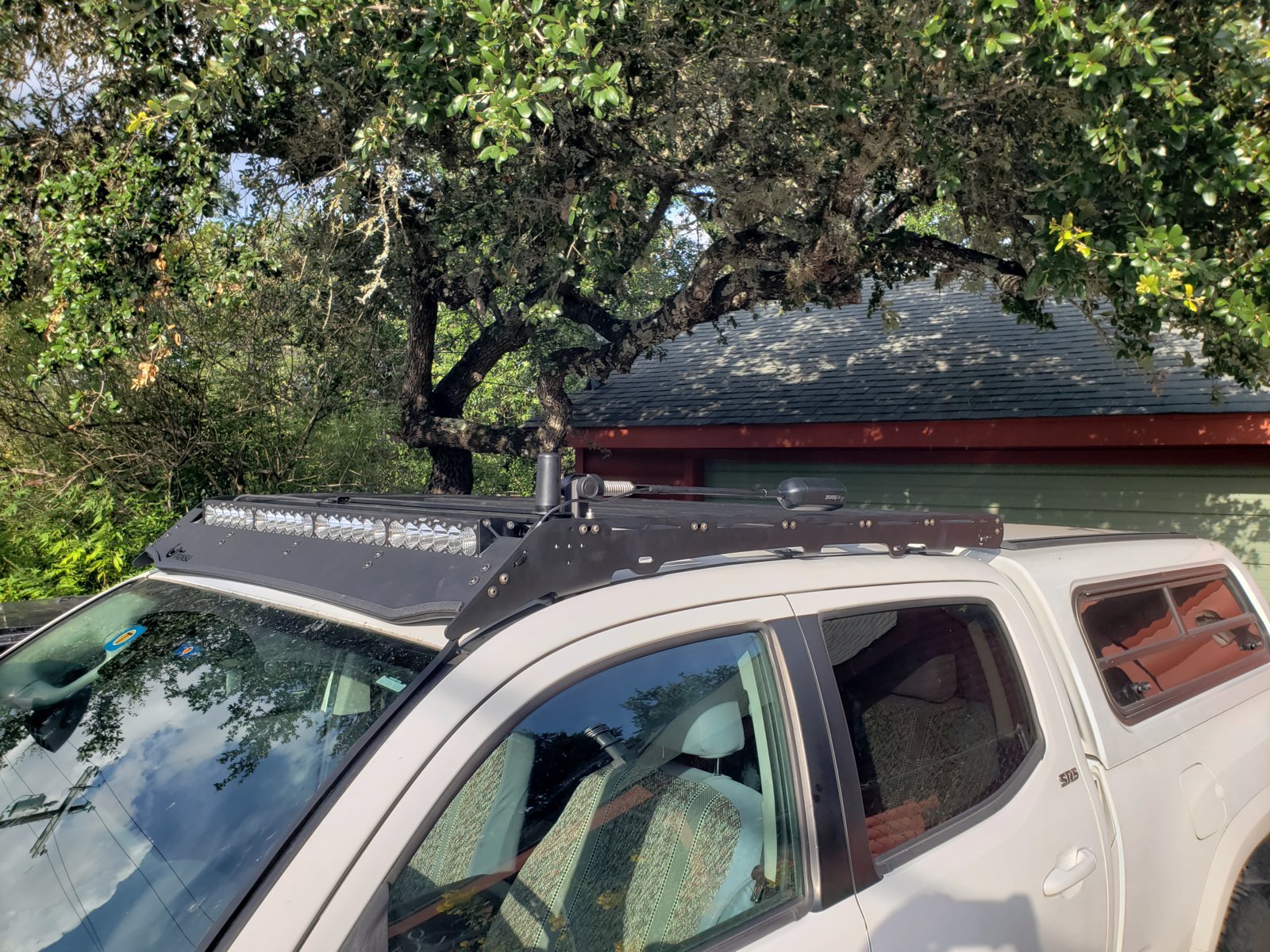

    I mounted my gmrs with the rugged radios bracket then mounted the antenna on the roof rack with the sherpa gmrs mount next to my we boost antenna
