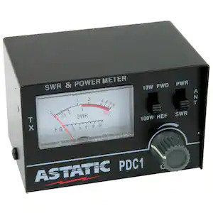

    I’m just using a external SWR meter commonly found, like this:

    I guess that's better than nothing, but I wouldn't live or die by what it says.
    VNAs are $60 bucks on Amazon.
    I'd also put a quarter wave piece of wire at the ground and see what that does.

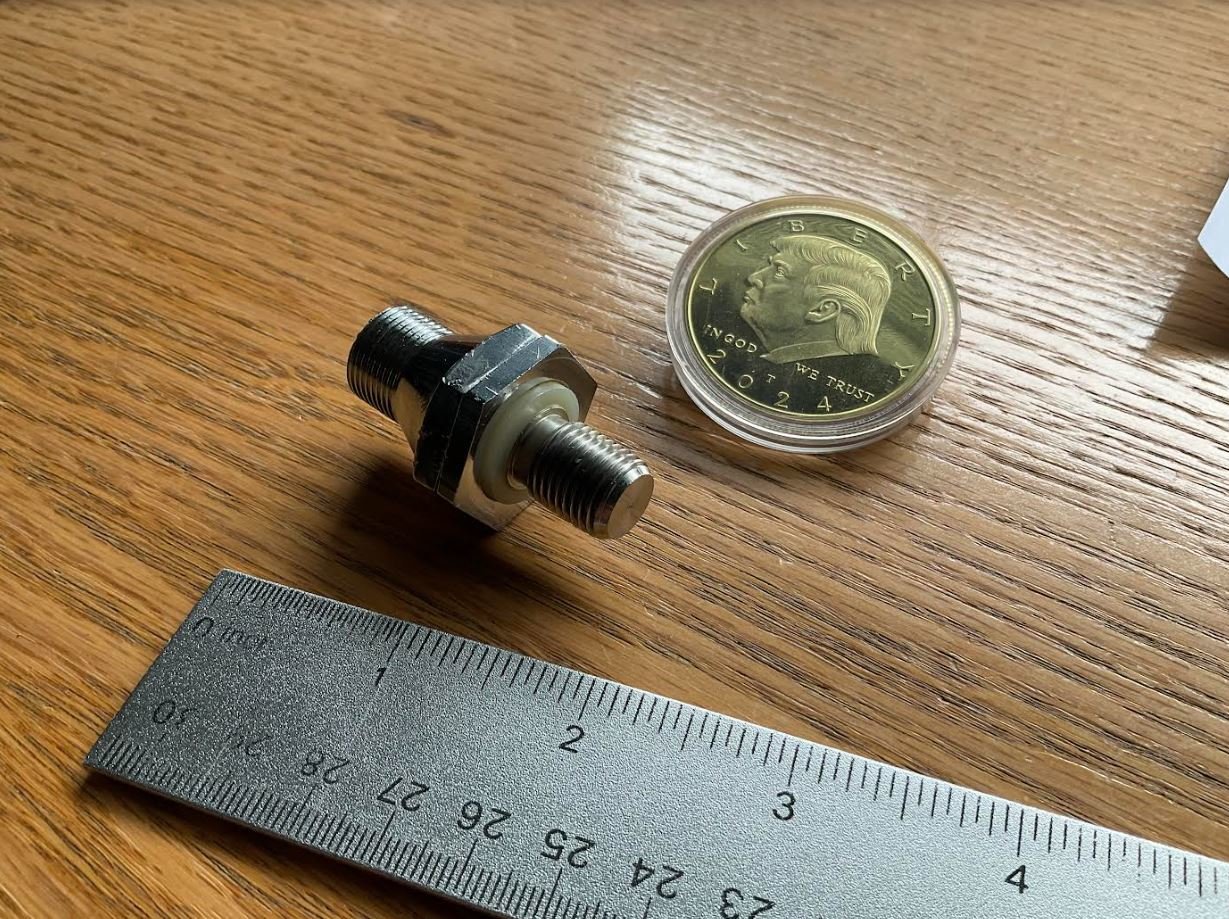

    I just discovered something interesting about the bottom half of my mount's SO239 connection to the antenna stud.
    As you can see in the picture, the bottom half is screwed together. I was again checking continuity (yes, I'm beating that dead horse again) and I was getting very sporadic readings from checking these two halves that are screwed together (the ground portion of it outside the insulator - not the stud)). Took two wrenches and gave it a snug and to my surprise it moved 1/8th of a turn. Tested ground continuity again and it's now constant.
    How much more tighter can I tighten this? I don't want it to snap.
