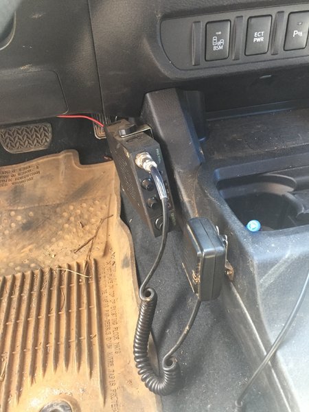

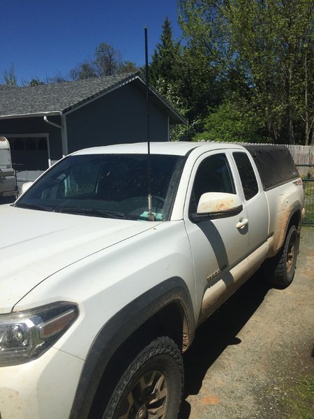

    @Sirfixalot, I don't know how the knee airbag deploys or what area it will fill in the drivers side area, but if far enough in the deploy zone that radio could be turned into a projectile ripping the mount out of the plastic. Would also look at getting the power wire up out of the way.

    But then you have internal install...and problem solved.

    Good point! It looks to be enough out the way, hopefully I never have to find out. Haha

    What antennae u got there? I'm thinking I may need to ditch my 2' fire stik :/

    It's a fire stik, i think it's 4 foot. I forget. Its plenty above the cab and gets really good range.

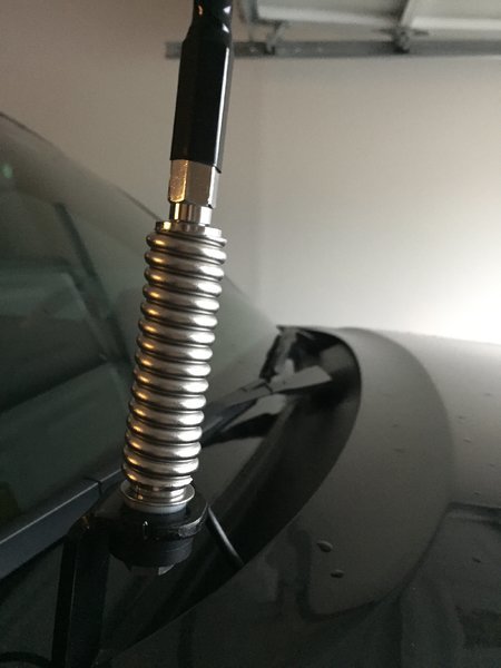

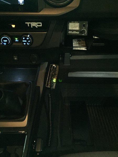

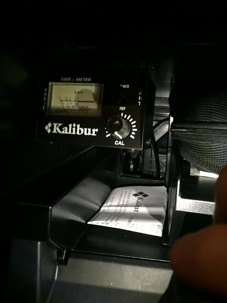

    Alright so killed some time while I wait on longer antenna by mounting my swr in the glovebox... probably won't run it inline all the time once I get the new antenna tuned but it looks cool in there ha. Just need to cut out a hole in the piece that pops out in the back. Also I mounted the spring directly on the mounting hardware to get the antenna low enough to go in driveway... swrs haven't changed for the worse so I don't think there's anything wrong with doing so but we shall see. Thanks guys!

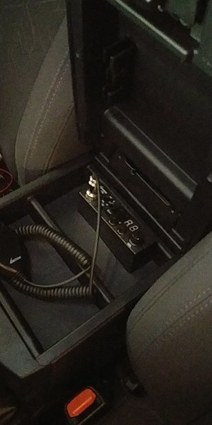

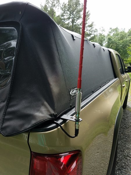

    Mounted my CB in my center console. I'll need to redo some wiring and run a dedicated hot/cold from the battery to my radio, but otherwise I'm satisfied.

    Pro 510 / 520 is probably one of the best all-around cb radios ever. Very solid performers and clean. nice job. Wait, is that a uniden?
