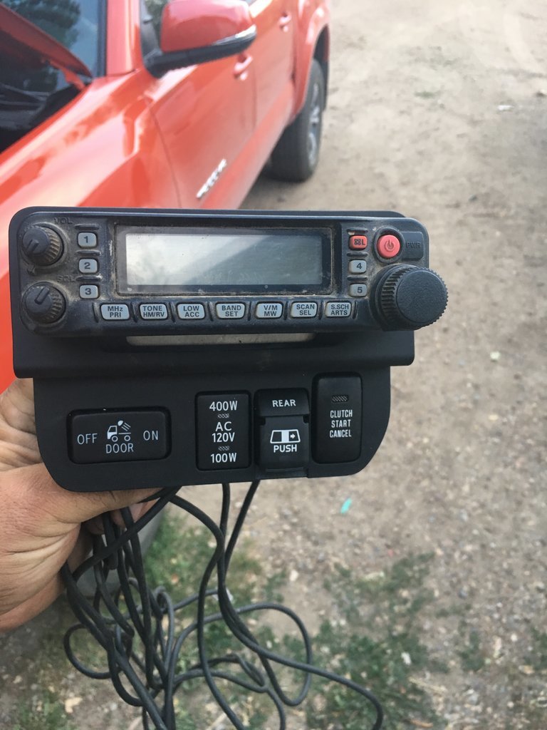

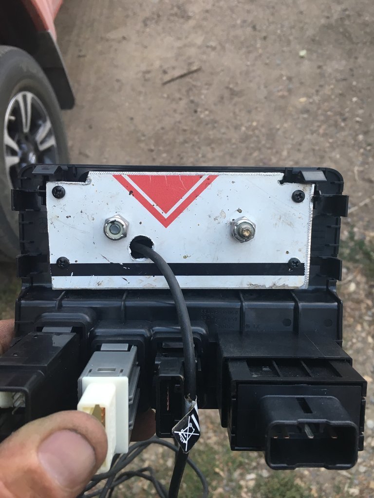

    Started on the install of my VHF in my new truck. Built a small plate out of an old aluminum sign I had laying around to fit where the small pocket is left of the steering wheel. Was able to bolt the face plate bracket onto that nice and solid. Probably mount the head unit under the drivers seat and the external speaker under the dash. Probably just do another fender mount for the antenna again.

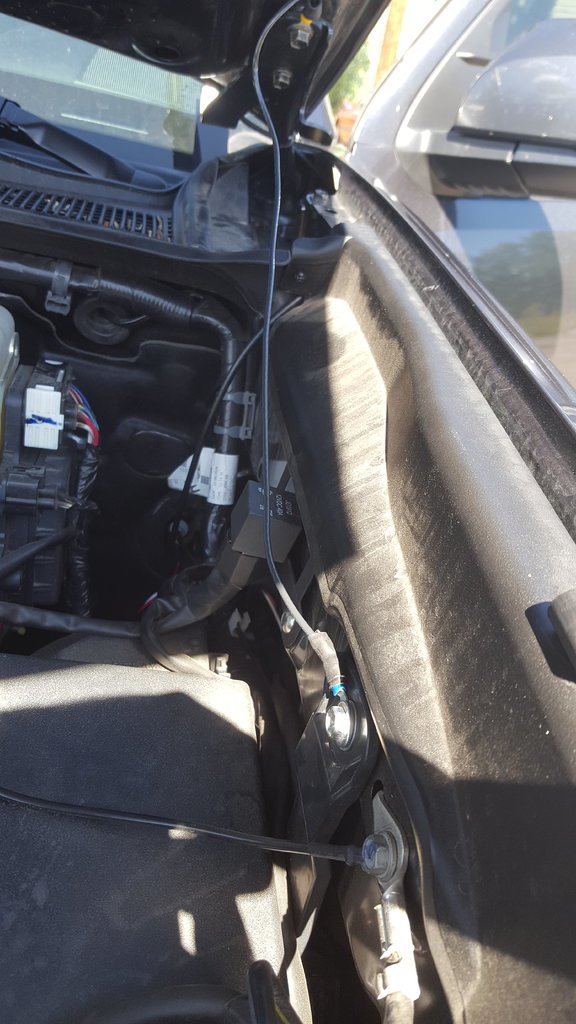

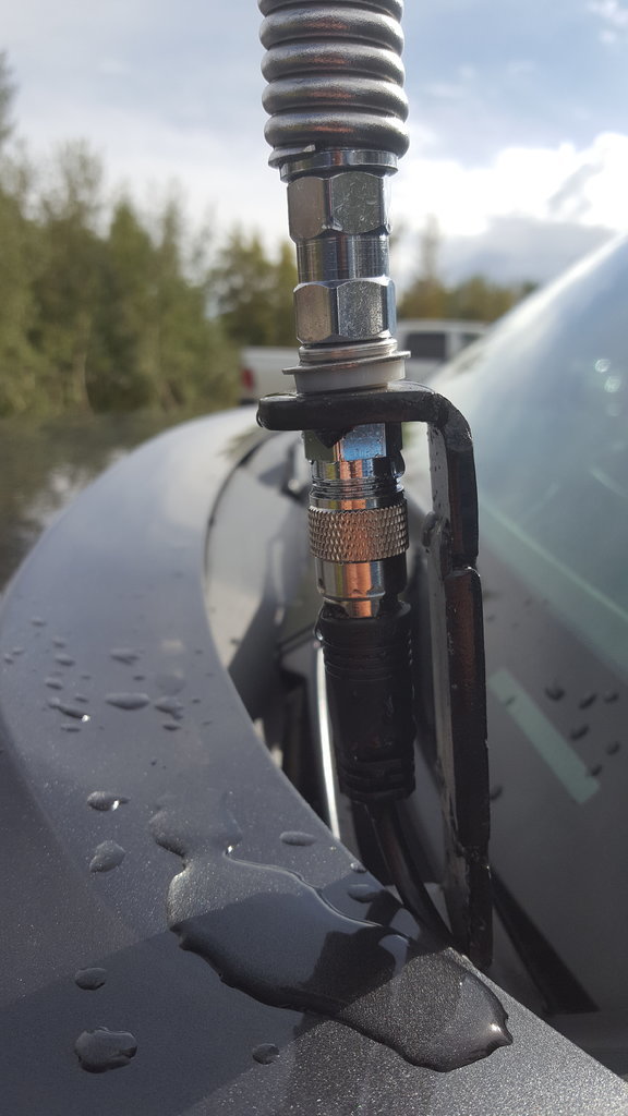

    All the wires are ran up behind the am/fm truck radio and through the firewall. Antennas are mounted with edge mounts to the hood. Very clean install compared to how I first had it set up.
