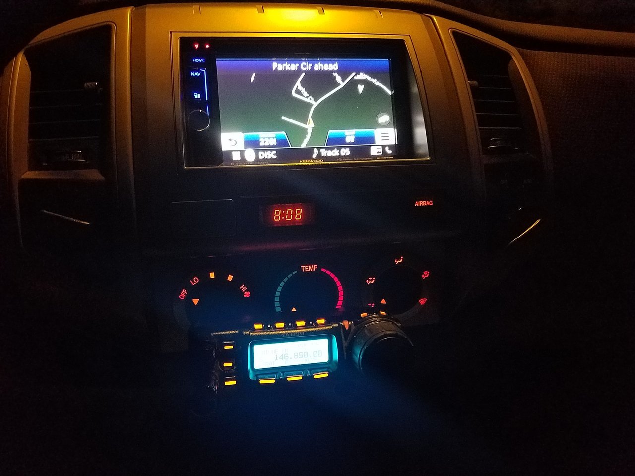

    Looking for clean installs of Ham setups, I've got a FT-7900;
    Previous install was under the seat with the faceplate tucked in nice in the second gen pen cubby;
    Trying to come up with something similar in the 3rd gen.

    I really like how tidy that looks, but I usually keep my phone in that slot since it is close to the charger cable.
    I am putting a switchpro face next to the rear cup holder on an XPOTRPR mount so the whole unit would look super clean. Hmmm...

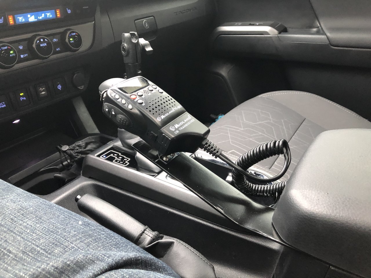

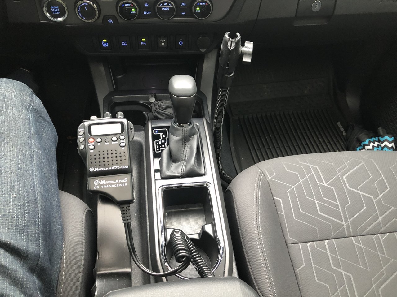

    I use the Midland 75-822. There’s a hole in the center console already to run the antenna cable through and plug the cb into. Then I made a simple bracket that mounts to the console lid using two existing screws from the lid. I can easily take the mount off whenever I want. It’s not in the way of reaching anything in the cab at all, and very easy to grab when I need it.

    Looks real good dude. Especially that custom ARB twin mount w/ custom bracket!

    Just switched from a Uniden to the Midland 75-822 and its pretty sweet with 2in1 feature.
    FYI your truck is to clean...

    Haha - it was only a couple weeks old in that pic. I assure you it’s dirty now.

    Looks good! I just got this and the cobra 75 the other day and I am going to send the cobra back. Love how versatile this midland is. Where did you mount your antenna and how?
