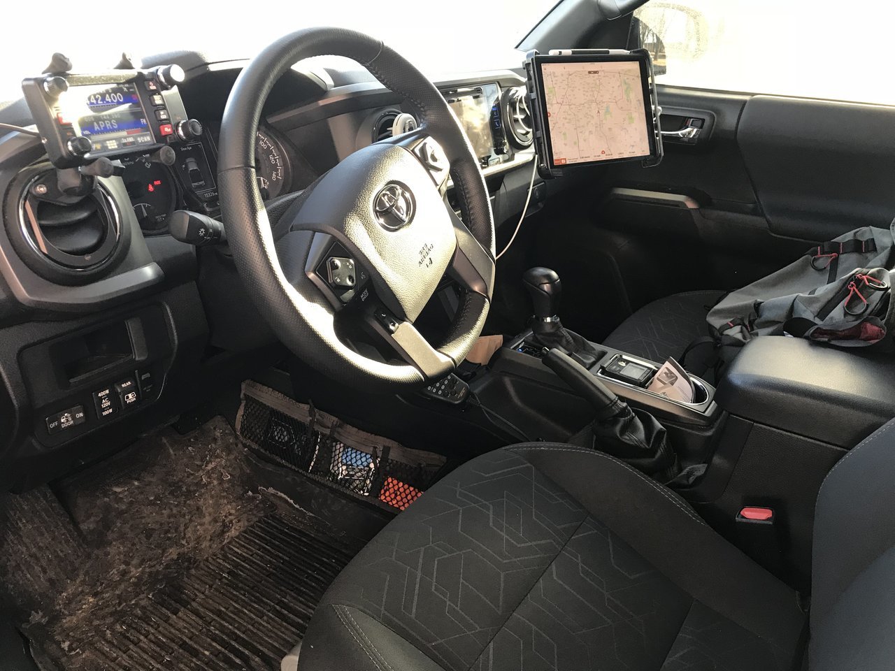

    No I am tuning aprs just on the 400dxr. I don’t have it running to the tablet. I run iPad Pro 10 inch. My maps I use google and HEMA Explorer. My gps for my tablet when not on cell service is done by a Garmin GLO.
    The 400xdr runs AMS, digital, and fm. I run System Fusion quite a bit in town. I like the dual monitoring function of the radio. I also like the remote head unit. Very well laid out. I love this yeasu radio.
    My other radio on passenger side is the midland 40 watt grms/Frs. I like it instead of cb. I have two handhelds. I’ve handed them out to friends who didn’t have ham. Works really well.

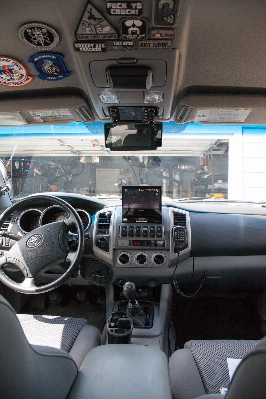

    Im not sure if you are familiar with the 2nd Gen interior, but where I have my radio in the overhead is where there used to be a temperature and compass display that was notorious for having a circuit go bad on the board. I probably soldered the thing 5 times before just removing it and putting my head unit in its place. The bracket that came with the 400DXR fit so perfect, it was like it was designed for installation there. I put an external speaker where the sunglass holder used to be, another useless feature for me. I have the microphone on a Nite Ize magnet, just like the one you can see above the 4WD selector switch. When I am driving around urban areas, I like to keep everything tucked away as much as possible to keep the crack heads from peeping around. I just disconnect the microphone and throw it in the glove box. My stereo also folds away.
