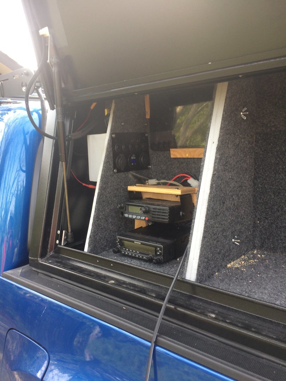

    Mobile ham shack done - I fabricated a canopy cupboard for my Alu Cab, wired it for a dual band Kenwood TMV71 for voice and Yaesu FTM 3100 for full time APRS using Mobilinkd TNC. Put a 10 inch android tablet for maps, music and APRS when in camp. The cupboard is bolted to the adjacent cupboard for easy access to wiring and removal. Fun project.

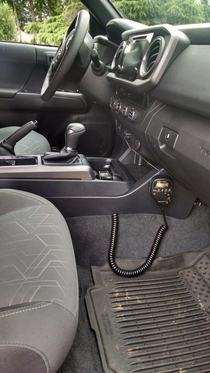

    Not sure if you have a radio yet, but I don't think that I would go through the roof. I mounted mine on the side. The picture shows the Cobra 75 that I had, since then I've changed out to a Uniden 520 or something like that. I don't have a picture, but it's a definitely a little bigger, but not much. If you go this route just make sure that the knee airbag can deploy if your in a wreck. The Uniden that I have now works, but I wouldn't go much bigger. By the way welcome to TW!:cheers:

    Where is the control unit located?

    There's a small gap behind the center council that I put it in. The gap works well to run wires through also.
