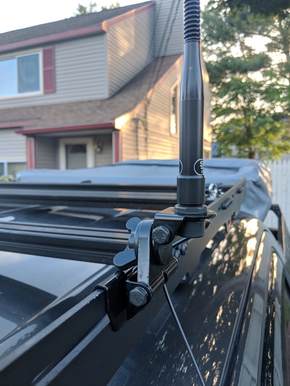

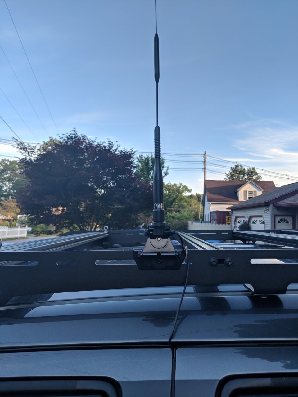

    Lots of sail boat fuel
    Comet cp-5m for me. Hooked up to a TM-V71a which I love.
