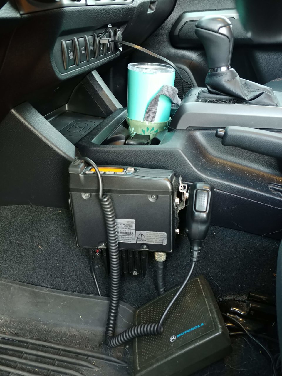

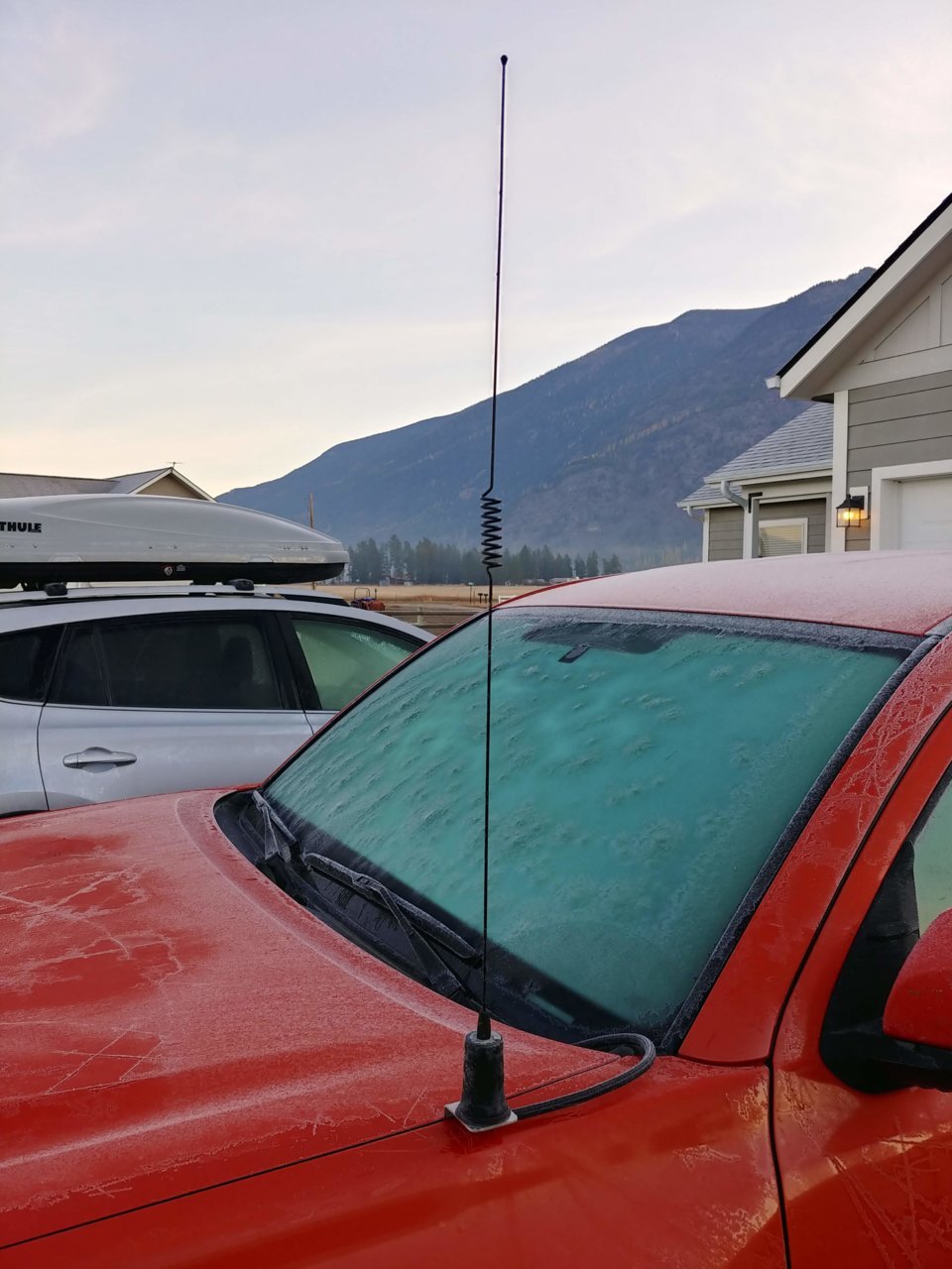

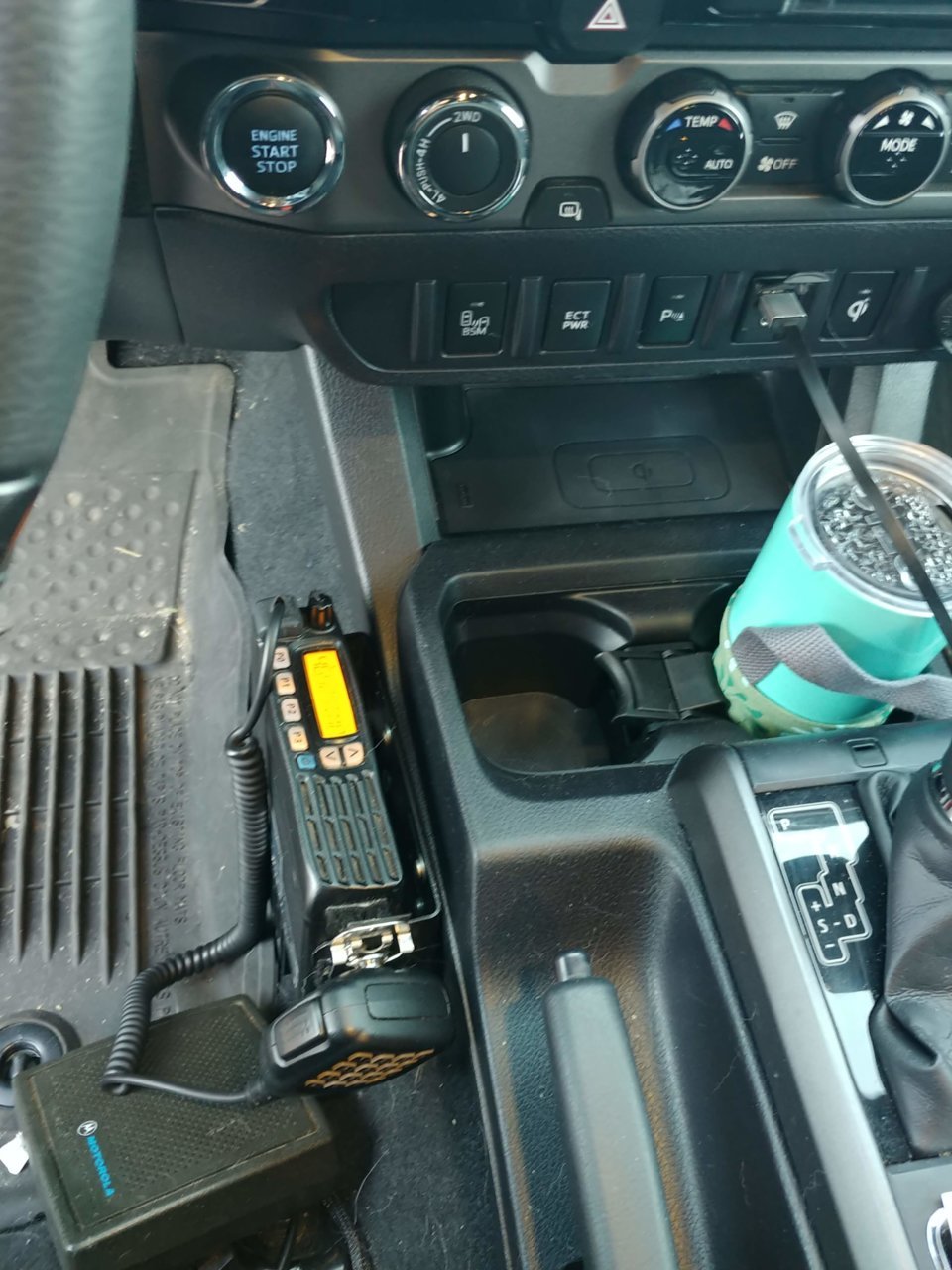

    Clean, I don't know, but highly functional and reliable. The whole instillation only required drilling two small holes in the plastic trim. Everything else fit using existing the holes and grommets. This radio doens't have a detachable face plate so it had to be mounted in an accessible position.
    It's not as sexy as some of the newer ham radios out there, but this radio/antenna combo has been mounted in three different trucks over the last 10 years and continues to work well:
    Radio: Icom F-5021 commercial VHF radio
    Antenna: Larson NMO 2/70 whip
    External Speaker: Motorola - 4018

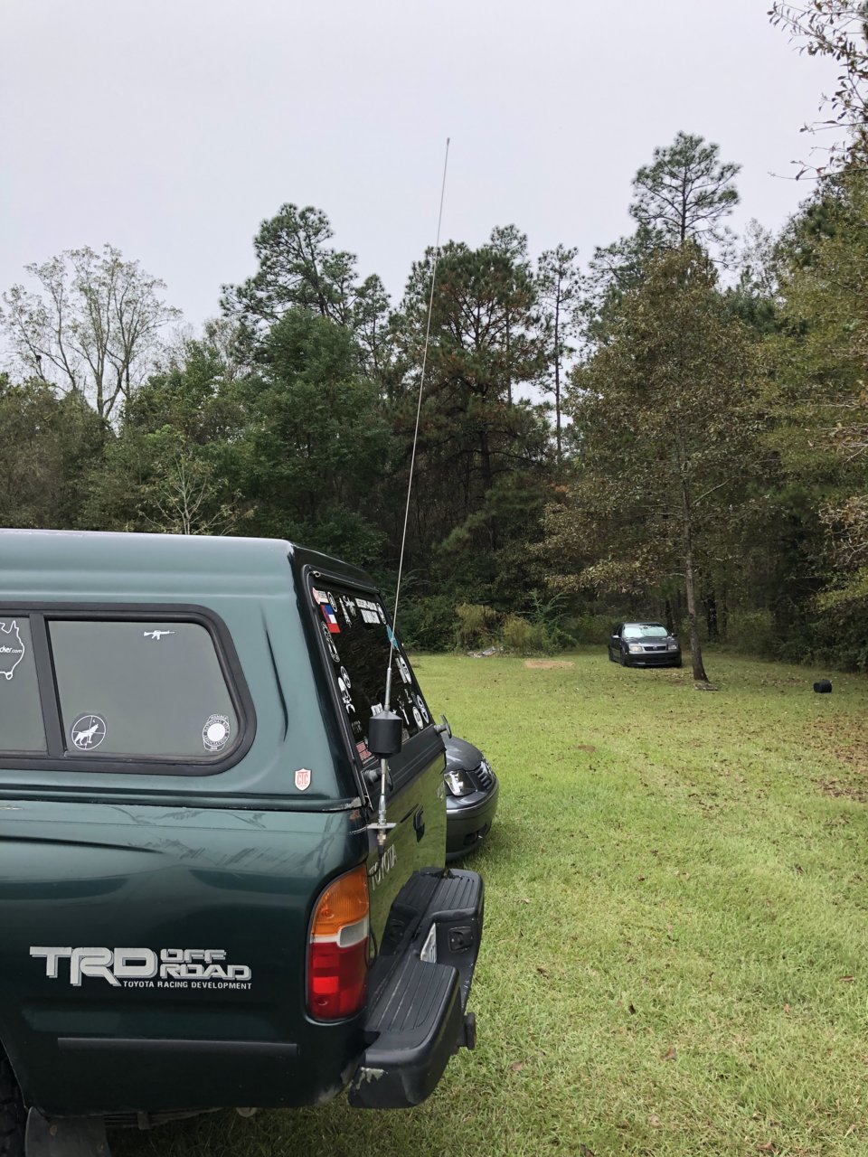

    Here’s a dash mounted 980. It needed a little trimming but it fits well out of the way.
    FireStiks are garbage. Get a Wislson Trucker 3000 or 5000 and never look back. Mounting right next to the cab will be poor performance and it’ll also slap the cab all the time.

    I’d cut it to fit if you are satisfied with the antenna location. Voodoo and truck stop black magic say you need 18’ for 11meter.
    I run a fiberglass topper so the interference isn’t near as bad as next to the metal cab. See how the base is high and the antenna is above the roof by a good half length. This is as good or better than the 102” whip I ran for a few months. Cleaner and less conspicuous as well.

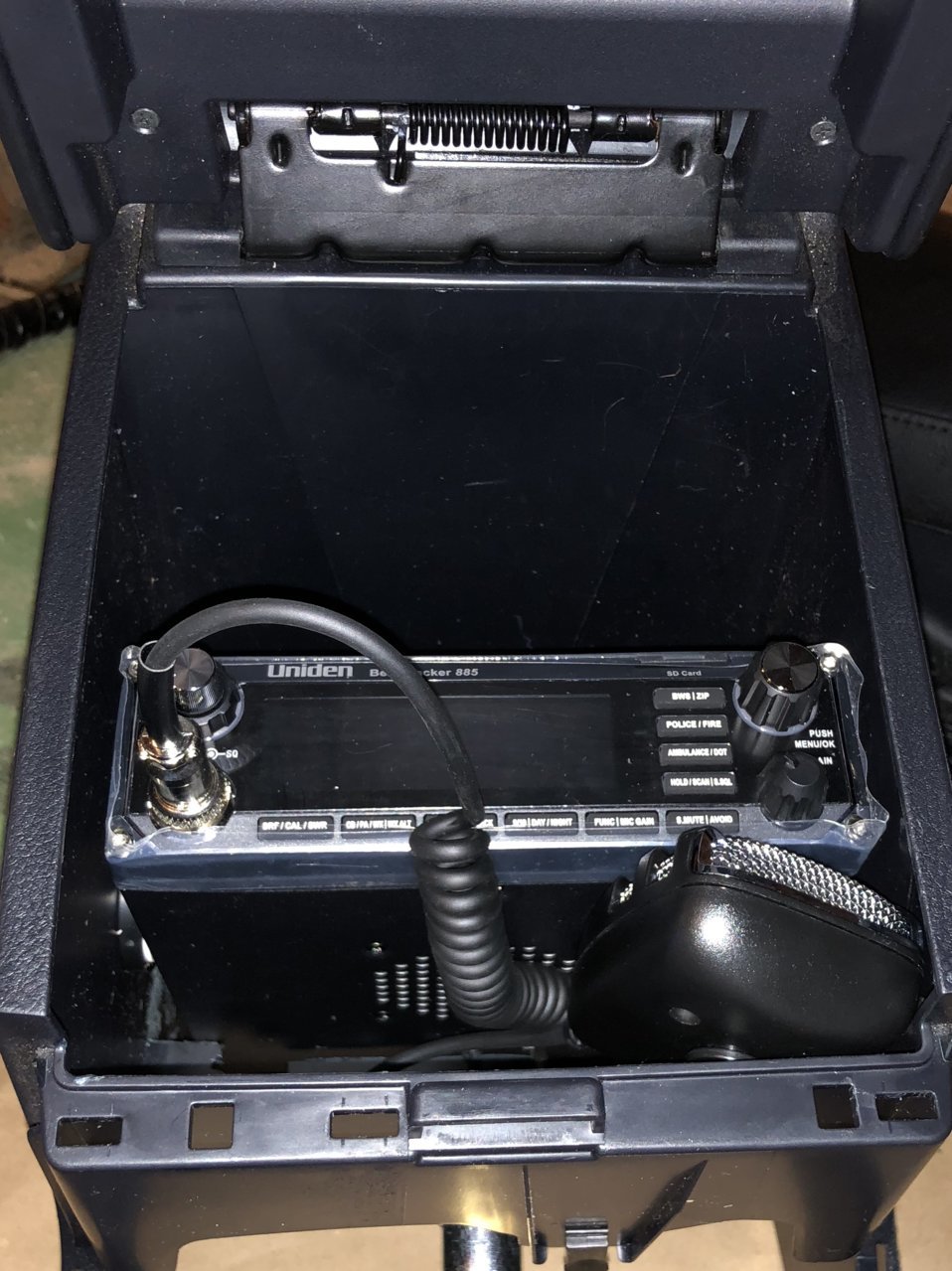

    Ok, hope I don't usurp the thread but started my mounts today...will take a few days for more parts. I'm going for nothing showing. Beartracker 885 + remote amplified speaker and PA. Got it all laid out, got the console apart and the power line in. Next few nights I'll do the two antennas and the speakers. While I'm at it I'm throwing in a rear seat dual USB port. When done I'll rewrite it all in the build thread, including the wiring diagram.
    Console mount so far:IMG_6236.jpg

    FF2A5842-00C7-46BF-BC8D-593DD36F38FB.jpg Night two: mounted and tested - it all works, the antennas and all connections. The scanner has a gps antenna I tried hiding on top of the radio head behind the shroud but the signal was flaky. Will tuck it up in the corner of windshield to get line to sky.
    Tomorrow I put in all the new trims around the scanner/CB and wire up the external speaker and PA horn.
