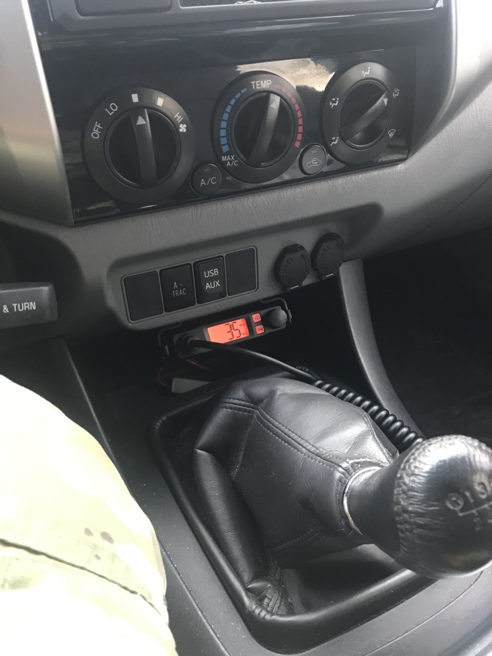

    Best place for CB.

    ^ what CB is that? US spec?

    Nice and clean. Harder on a gen 3 as it covers the Qi pad.

    Motorola xpr?

    I’m a rare fan. :fingerscrossed:

    I went with the Uniden CMX660. You will need to basically take the center console out, which works out because my coax comes from tailgate up frame through grommet, under driver seat, and up through center. I had to punch a small round hole through the plastic in order to run the wires through.
