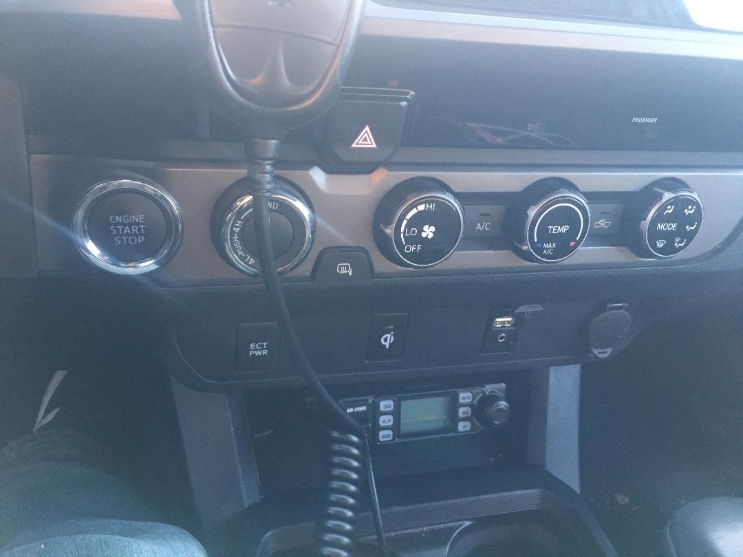

    I use the wireless charger every day. It works great for me. I put a little Stryker over it. I can still slip the phone in underneath the radio to use the charger .

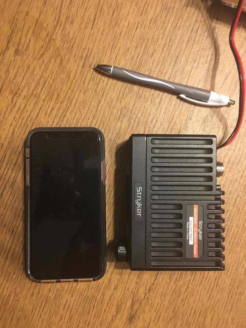

    The radio being so tiny is what made it possible for me to think that I could do it. That's an iphone X next to it in the photo.
    I had to make a hole about the size of a quarter near the back of the cubby. The hole had to be bigger than I'd hoped to fit an inline fuse present on the radio's power wire. There isn't much more than 3/4" behind that panel where my hole needed to be so the fairly long, oddly shaped fuse didn't want to fit through a smaller hole at the weird angle required by the close clearance. The power wire and antenna coax go through that one hole. I used a dremel to cut the hole since I didn't know how much room I had behind it. It's a little uglier than I was hoping, but covered by the radio after the install. The radio hangs on the mount that came with it. Two screws secure it to the same panel. All the holes I made are in that one interior panel that makes the back and top of the cubby.

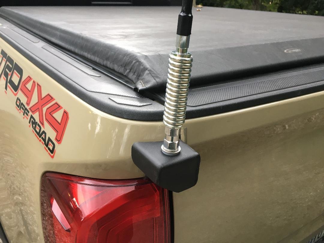

    I was most concerned about being able to fish the coax and power from behind the cubby, but that was actually really easy. I was able to poke the power wires from the radio though the hole to where I could reach them under the dash near the drivers shins with just a straightened coat hanger, and then pull the coax back through. It was a short fish with no unexpected, impassible twists. I ran power from an "add-a-fuse" at the fusebox under the dash to the drivers left. The ground wire is under a nut on a bolt coming through the firewall. My antenna coax comes into the cab through the rubber grommet near the driver's door sill. Antenna is on a Cali-Raised bed accessory mount. Coax is inside the frame rail as it runs front to rear. Tacomaworld pictures and other installs were a huge help figuring out how to run the coax.

    Just a heads up before you go drilling into that cubby, the yellow brains for the airbags are located there. Proceed carefully. Best to take that piece out and work on it at the bench.

    It works pretty well so far. My radio is a Stryker sr-25mc.
