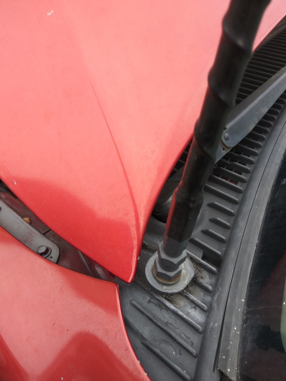

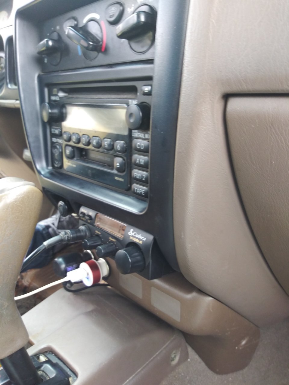

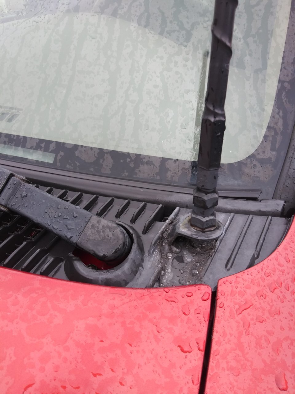

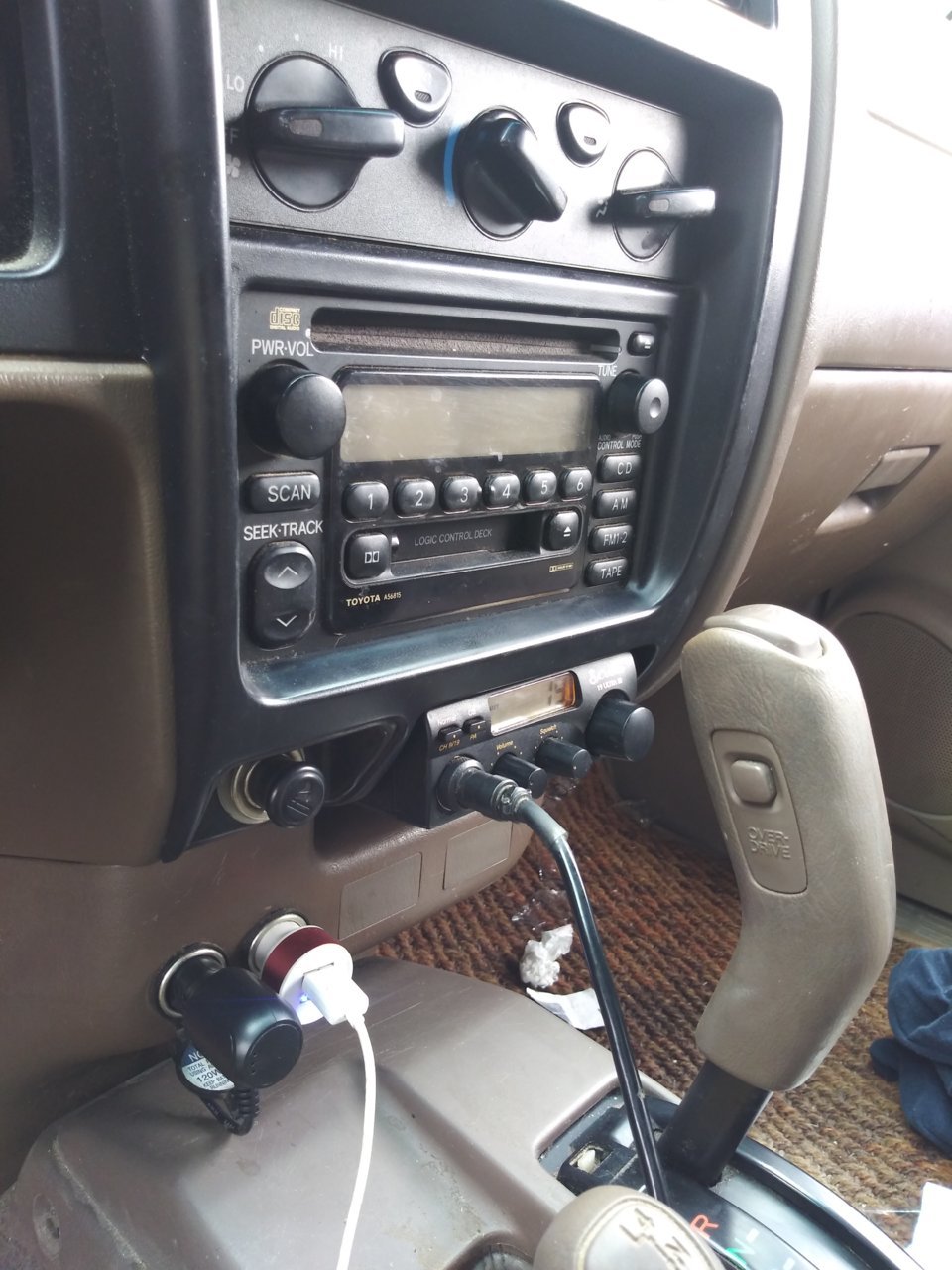

    Tundra hyper-silver double 5-spokes with 265-70-17 BFG All-Terrains. Compact Cobra CB in the ashtray slot. Cut a small hole in the plastic and mounted the antenna to the drivers side windshield wiper mount using an old Harley Davidson blinker bracket. 1 1/4" drywall screw is holding door handle together nicely.
    Cobra 19 ultra III Ashtradio
    It isn't a Pro radio setup, but for $65 it works great! And I'm pretty happy with how stock it looks.
    Fits in the ashtray slot! Had to cut a small amount off of the black plastic backer to get it in that deep, no noticeable mod to vehicle. The speaker bounces out loud enough for me.
    3' tunable firestick
    Used a motorcycle turn-signal bracket, mounted it to the windshield wipers bolt. Cut a small slot in the plastic then filled it back in with black silicone.
    Plenty of room for the hood to fully open.
    Tight clearances underneath though! That black under there is the only paint I had layin around to seal the bare metal where I hammered the truck body a bit.
    I know... But the cb shop I got my stuff from didn't have a 90° antenna cable in the length I needed, so I did what I had to git'r'done and keep both antennas in line and @ the same angle.
    Charlie Bravo Cheers! Over&Out

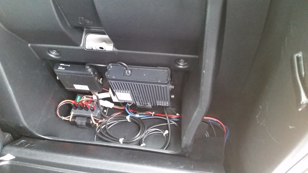

    There are a couple things going on. First, I still don't have power to the rig. I am not sure where to go through the firewall. I'm hearing how super easy it is but so far, nope. If I could pull the dash out, maybe, but I'm not sure what's screwed in and what's clipped and I don't want to break anything taking out dash parts so I'm looking for something with pictures before I try to penetrate the firewall. I also need to get a wire through the firewall for a light bar. So I'll do that together.
    Second, even with the extension there was not enough wire between the Uniden and the front seat so I had to splice in a Cat5. That's the blue wire and the white box you see in the picture. The problem there is that the Uniden proprietary wire has a proprietary plug and I cannot make a J45 fit. Moreover, the proprietary Uniden wire has a braided ground. So I had to twist that together for the splice block. I do not know if it';s going to work yet and worst case scenario I will have to splice each wire together and shrink wrap 16 wires and then shrink wrap the sets. This is not fun and Uniden is hard to reach.
    At any rate, the extension ends in a block. I have the handset wire running down between the seat frame and the transmission bump in the floor. The extension wire block gets caught on the frame so you only see the coiled wire and I think that will solve the problem. The handset just lies on the floor under the seat and in front of the adjuster bar. There's a little divot there and it cradles without moving while I'm driving.
    I still have not decided where to put the Yaesu faceplate/mic and speaker.
